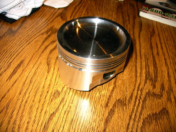

    yeah, just call up wiseco and have them make u some up.

      did you have them lower the ringlands? im just wondering cause i dont want to run into problems with the top ringland breaking.
