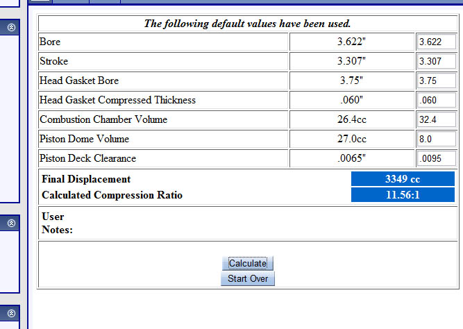

                          So im trying to figure out what my compression ratio will be using a set of DOHC pistons I scored ($86 for a new set).
                          These are the values Ive come up with for stock bore using a 3400 head gasket and 3500 heads.
                          Bore: 3.622"
                          Stroke Length: 3.307"
                          Head Gasket Bore: 3.75"
                          Head Gasket Compressed Thickness: .06"
                          Combustion Chamber Volume: 32cc
                          Piston Dish Volume: 4.5cc
                          Piston Deck Clearance: .02" (proud of the block)
                          That would give me 13.695:1 Correct?
                          Im not so sure on the value for the piston deck clearance though. On the CR calculator here, im seeing .0095" as the value for deck clearance on the DOHC. Do I use the value for the 3400 or DOHC?
                          Clearly 13.6xx is WAY too hight to run on pump gas obviously. If these pistons dont work, im selling them and my forged stock copies, boring the motor and getting some forged 12:1.

                            You use the DOHC spec. of .0095" for Piston Deck Clearance. But the main thing you need to worry about is cylinder pressure, not compression ratio. Although with that said 13.6:1 is to high for pump gas.
                            Your local OBDII moderator
                            2000 Grand Am GT w/ WOT parts
                            • geldartb
                              The Situation
                              • May 2004
                              • 1994
                              3500 heads and ironhead 3.4 pistons will net a 11.5.1 CR
                              thats using the stock spec head gaskets
