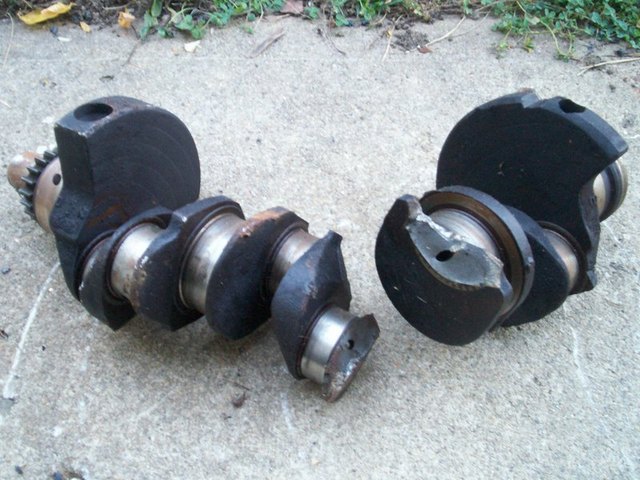

          Circle track racers have seen micro-fractures from long periods of 6000+ RPM's. I have only seen one failure (due to lack of oil), and have pics somewhere - it was broke in half right near the 2 and 3 journals if I remember right.
              pics would be great, if you can post em did break between the 2=3 journals?
              '86 Grand National
                Live life 3.7mi at a time
                • 4555
                #22
                Soory, it was at the other end of the crank. Between 4 and 5...
Name:	broken 3100 crank.jpg
                He was claiming it's a large-journal but I don't see the reluctor wheel (unless it was disintegrated).
                    [ATTACH]1286[/ATTACH]
                    looks to be the early 80's crank. damn look how it broke right on top of oil passage!
