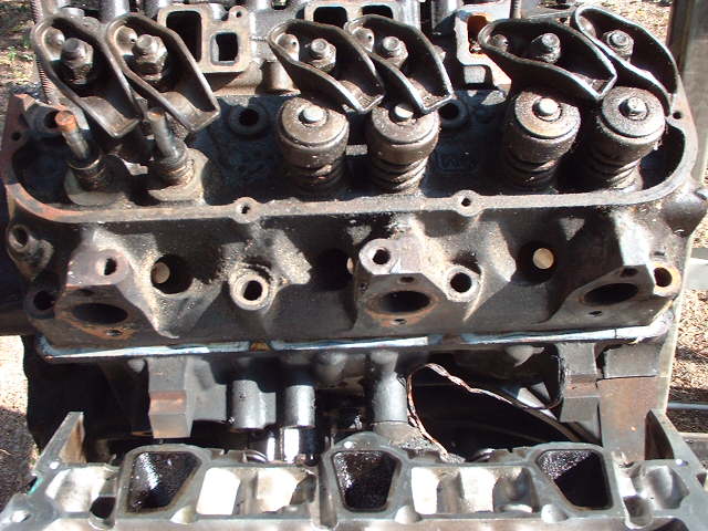

                            No, the heads in the picture are cast iron heads with the typical area of the 3500 and below engines to show SuperDave the difference in deck area and the likely problem he would have were he to mount 3900 heads on a pre 3900 block, not to mention that the cylinder heads deck surface is not symetrical, the coolant holes are different in size from one end of the head to the other meaning he would have to match the gasket holes to those found on the 3900 gasket.

                                I believe what GM meant by comparison is the tall roof on the intake port of the 3900 which is higher than on previous heads. Unfortunately the valves are shorter on the LS1 heads so they are not candidates for swapping into the V6 head. I'm still interested in a combination offset crank and 4" bore on my extra block though. I'm still amazed at how Fiero members are still favoring naturally aspirated iron head V6 motors over the aluminum head motors.
