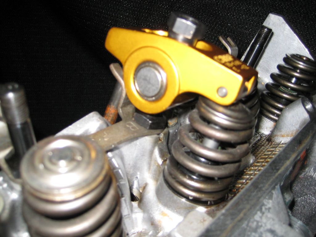

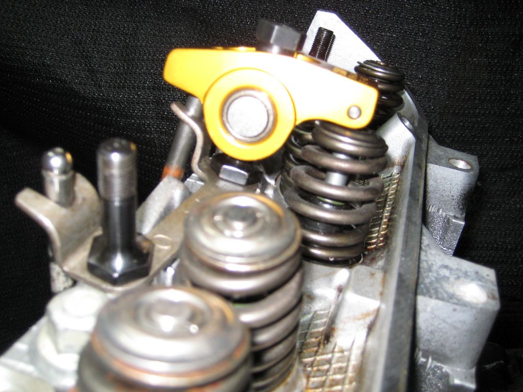

          I quickly test fit these from Summit, but I need the proper adapting studs to check for accurately. I bought them used for $100 because one got trashed on the guy's small block (I now have 3 extras, lol)...

                        I'm pretty sure you can only use a narrow body roller rocker made for the center bolt style valve cover '88+ SBC. The valves on the gen 2 and 3 motors are splayed out. Using a large body SBC or BBC rocker will contact each other near the valve end. Even using the narrow body rockers only leaves a relatively small gap between the rockers.
                        http://s158.photobucket.com/albums/t...t=100_3546.jpg
                        Those look a lot like the scorpion racing rockers without the scorpion on it.
                        I know the descriptions are a bit messed up at times with this place, but somehow I ended up with what I wanted :
                        Scorpion Rockers on Ebay
                        I picked up a set of 16 rockers 1.6:1 ratio. I read around and have heard nothing but good things about these. I too have yet to pick up the adjustable 3/8 studs but from what I can see they fit without issue. With the comp roller tip rockers being pretty expensive and no roller fulcrum, and the crane gold race ones costing more than I wanted to spend, these rockers plus the studs end up about $250 plus shipping. I can't justify spending more than that on my lowly 3.1 build!
                        EDIT : You also have make sure you don't get the self centering ones and use gen 2 pushrod guides. I went to the Scorpion racing website to figure out their part number and then went to the Ebay store. They use a 6 in place of the 1 for the first number, but the last 3 digits correspond exactly to the Scorpion site. Had to do a little footwork to make sure I got the right part the first time

                            Did you have to grind 4 of the rockers to clear the lower intake? I can't tell but your rocker looks to be sitting lower than mine. I took 2 pics to show you what the stock cam/pushrods look like with the rocker.
                            You cannot run just any rocker. Has to be narrow body, as was explained (just verifying).
                              I'd say if his pushrods is 1/16" to short then the rocker is sitting 1/16" lower to get the same preload as you have and he would have ran a chance of wearing out his valve guides due to the rocker not in the center of the valve stem.
                                Yes, four of the rockers I ground off about 1/8" radius on the top edge of the nose, as well as grinding the LIM for clearance. For some reason I had a lot more trouble gaining enough clearance to keep them from contacting the LIM than the first person did.
