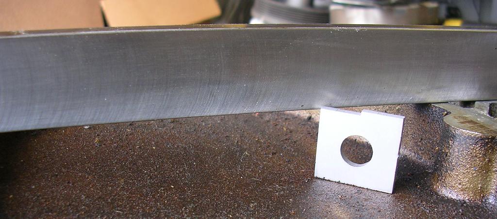

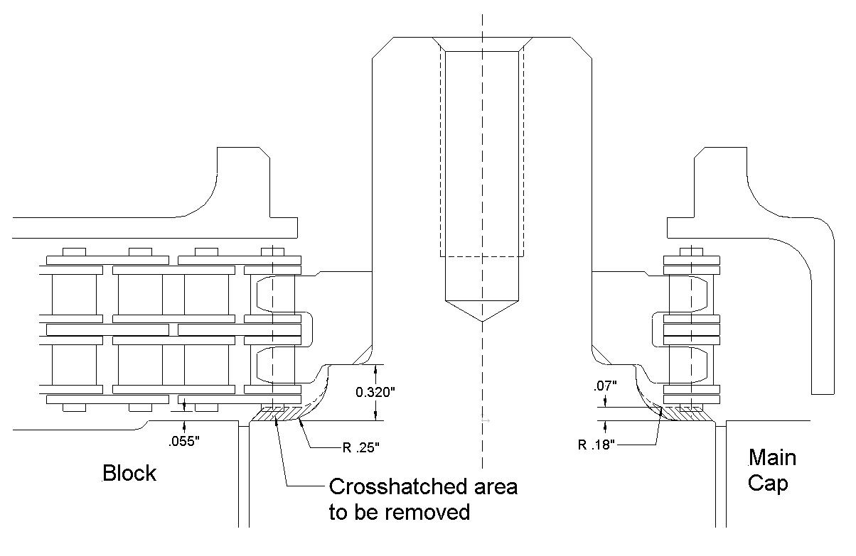

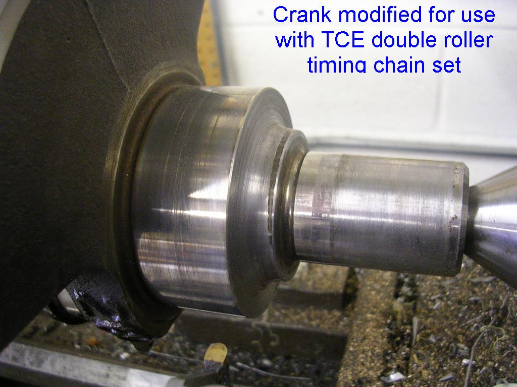

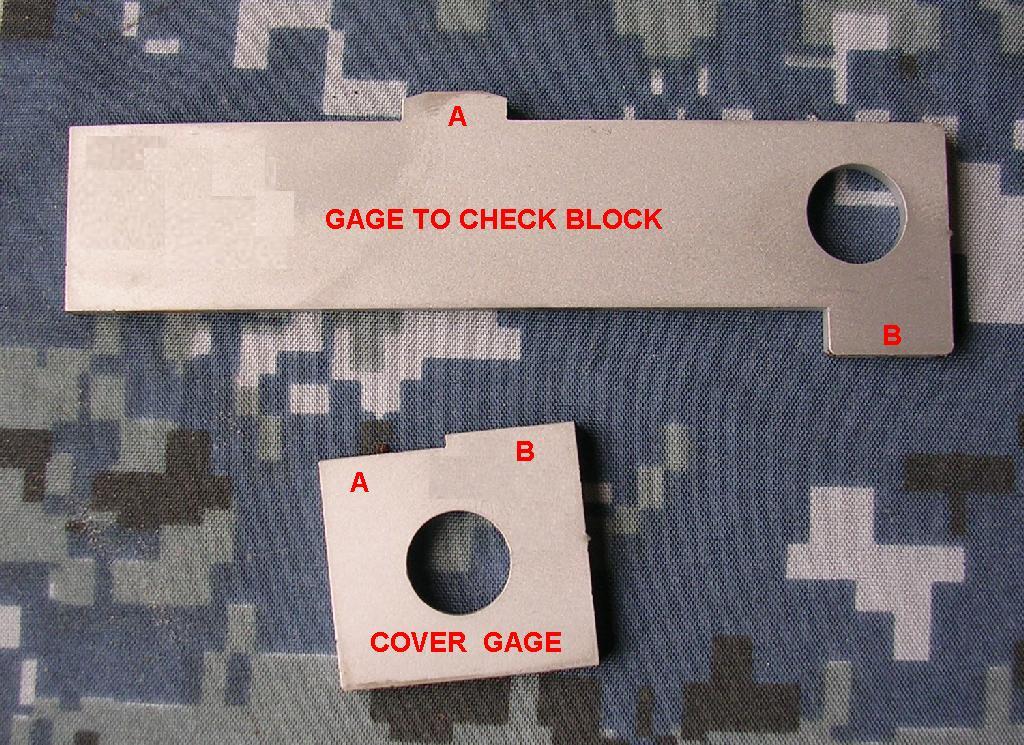

          For those who have been anxiously waiting, I have put together some pics on how to use the gages. I have been trying to get this done for about three weeks and could never find the time to do it the way I wanted so I will throw this out there until something nicer gets done. I had planned to relieve a front cover for illustration but have not had enough time to do so. For the time being, I am attaching the pics to this post since we have had some issues with our ISP and server.
          Below are pics of the news gages, how each gage is used, a modified crank and the crank modification drawing.

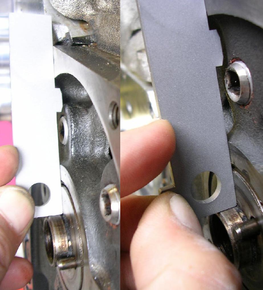

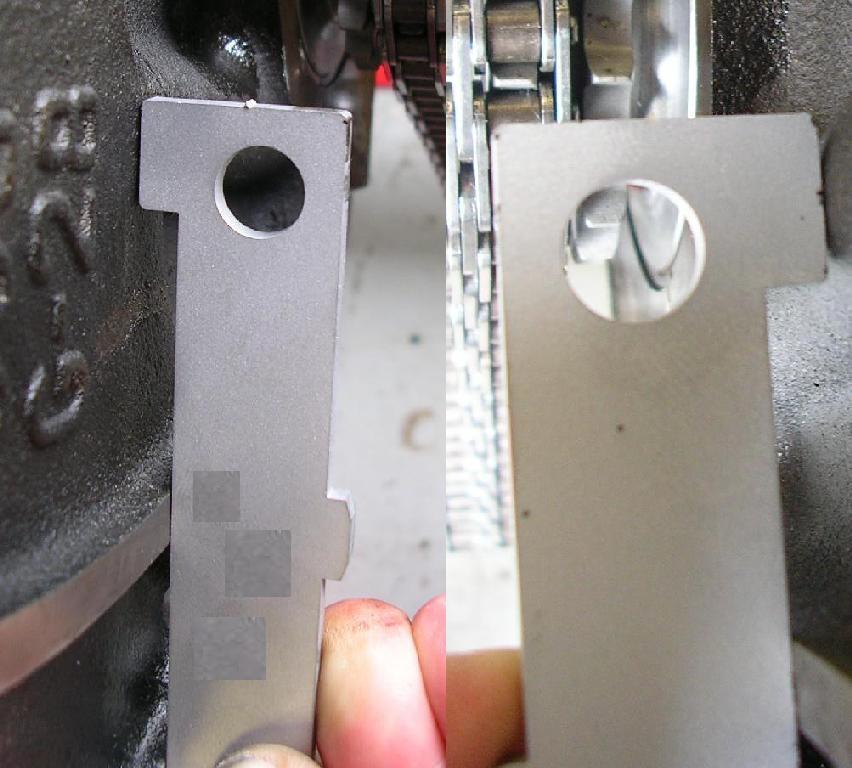

          With cam in block, check clearance around upper gear using "BLOCK GAGE". This is done by placing end with hole against cam hub and rotating around center of cam. The "A" tab represents enough clearance for the chain in it's most rear position. This portion of the gage should be used in areas where the chain is engaged with the upper gear. Tab "B" on "BLOCK GAGE" is used to check areas between the sprockets where the chain is not held in place. To use gage, place the edge against the face of the block and move tab "B" along chain route.
          The "Cover Gage" has two two steps and is used with a straight edge across the face of the cover. The shortest height is minimum depth where chain engages sprockets. The taller step allows for clearance in the areas between the sprockets. If cover is cut on a milling machine, it would be easiest to use the tallest portion all around.
          These gages should provide enough clearance but it is advised to use feeler gages to check the actual clearance between chain and block. This should be done when pushing the chain towards the block. Areas where the chain is engaged with sprockets only require .020" clearance while areas between sprockets need .050". Additional clearance does not hurt anything and will allow for future chain wear and slop.
