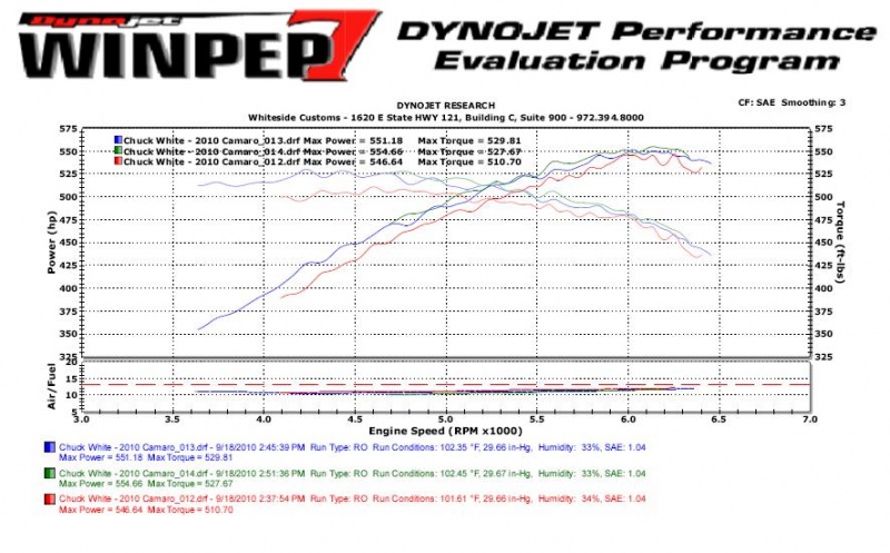

    There is very little to be gained from the VVT that Gm uses. I have tried to tune them. Most of the people see gains just from the TM delete and normal spark advance and AFR correction and fuel trim correction. You want to see what a maggie L99 dyno graph looks like? [ATTACH=CONFIG]6809[/ATTACH]
    Tell me if anything looks funny. Now guess what happened to that car? That one even has a custom grind VVT camshaft in it.
    False statement. TSP makes cams for the V8's and their stage 3 cam has dyno proven at least 70 more horsepower at the wheels. Maybe the custom grind cam tech
    didn't know what they were doing or maybe the tuner wasn't experienced with VVT.

    There is very little to be gained from the VVT that Gm uses. I have tried to tune them. Most of the people see gains just from the TM delete and normal spark advance and AFR correction and fuel trim correction. You want to see what a maggie L99 dyno graph looks like? Click image for larger version
