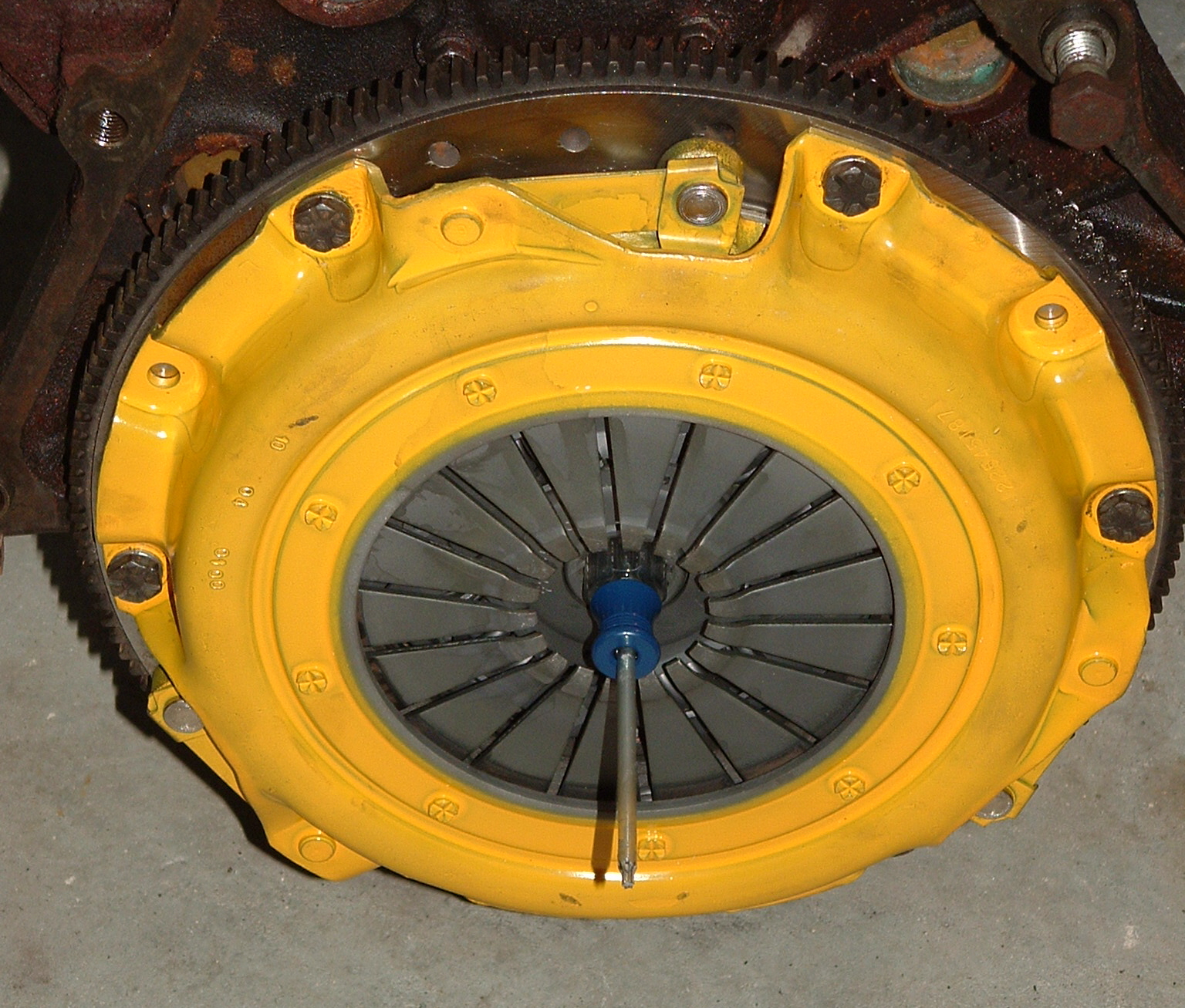

              Here's a few pics. Note the "alignment tool" I had to use in a pinch.
              And yes, the block looks like crap on the outside.

                    Looking good so far. Loving the alignment tool hah.
                    One question though, how did you get a Cloyers double Roller to fit on that engine? I remember something about them making that for the RWD 2.8, so did you get that one and modify the timing cover. If so, what was the machining cost for something like that? I assume they would just have to mill off a certain thickness.

                      The Cloyes will barely fit under the cover, but yeah, it's gotta be machined. I did it myself with a grinder honestly, so not sure how much was taken off. I used a straight edge along the chain and measured everywhere the cover seals to check things. Just slowly worked away at it until it fit without rubbing. The cover is thin now, and it is one area that I worry about for longevity. But I'll deal with it when I need to.
