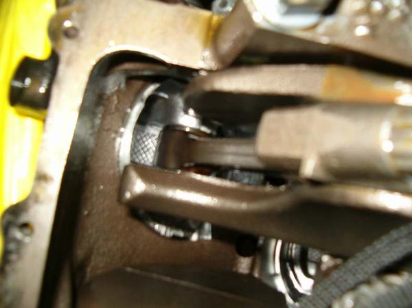

    closest one ive got
    i have a set of rods at the shop ill see if i can snap u a picture of them tommorow while im at work

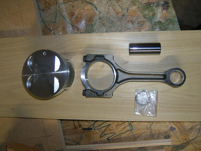

            When I bought these eagle rods, no one could tell me whether on not they were off-set so I bought them anyway on a gamble.
            After I opened them up I found that they were indeed off-set.
            notice how the crank bore of the rod has more journel width on one side that the others. I guess what im asking is, ...ahem*
            Do 60 degree v6 rods "namely the 3500" have a similar offset?
