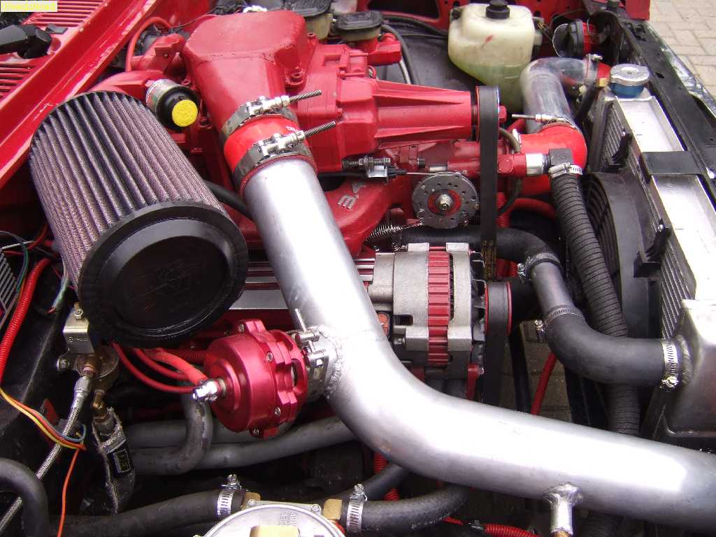

            I'm running a nice mallory unilite distributer on my 3.4

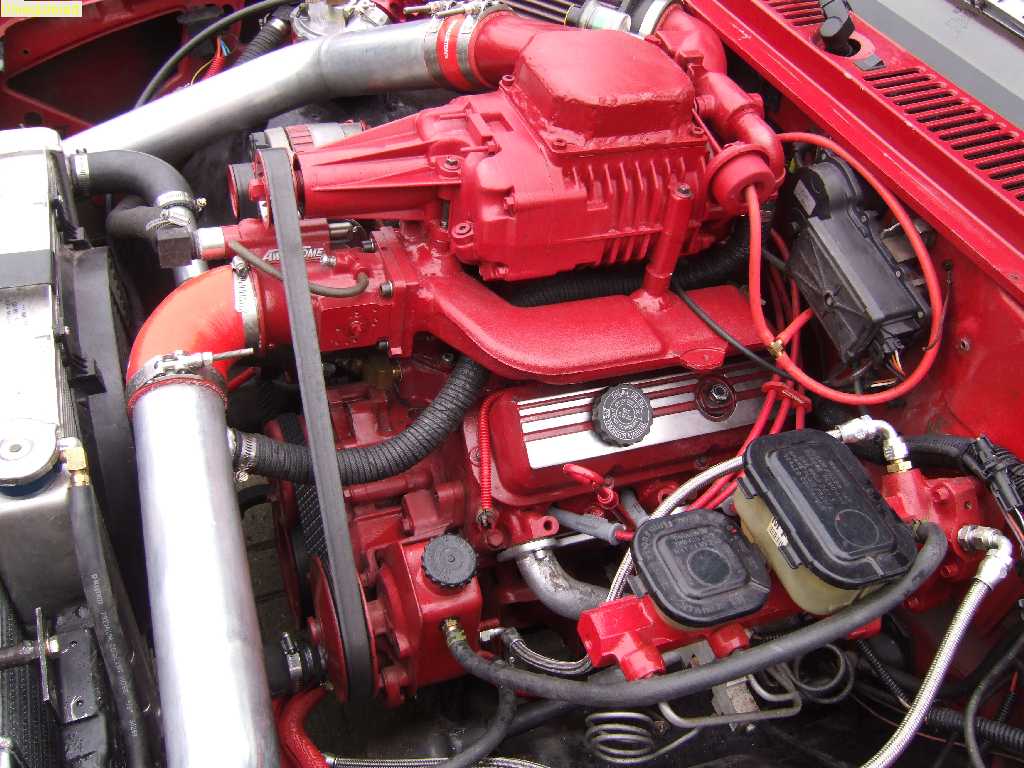

                  berniejayd: It was made for a carbed 60*v6. I have it on an iron head 3.4. I've cut out and welded in the back cross over on the camaro lower intake manifold. It's a supercharged propane setup I made.
                    Dude I gotta see pics of that!!!
                    • ssdurango
                      • Dec 2004
                      • 170
                      Did you want to see a pic of the lower intake manifold or the whole setup?
                      • geoffinbc
                        Iron Head Enthusiast
                        • 5831
                        Anything you got. I have never seen a boosted propane setup
                        • ssdurango
                          • Dec 2004
                          • 170
                          I thought I showed you these before...
                              No I don't remember seeing those pics. Crazy. I also noticed the Hydroboost. Did you buy a kit or build one yourself?
