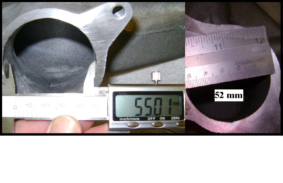

    Gentlemen... Thanks to you all... I have some great news..
    I followed your collective advice in the original post and took the UIM and New TB down to my machinist, who promptly looked at me something like this: and said, "Bobby... I'd have to charge you more than it is probably worth...Why not try your hand at this yourself...if you FUBAR this UIM...not to worry...you have ANOTHER one on the old engine you can use as a backup. Go home...get out your air tools and some grinding fittings and get to work...Just don't go crazy and mess up the face of the TB!"

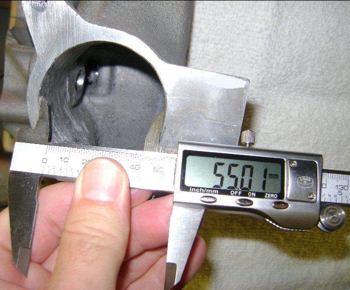

    And so... I did just that. First...I took a flat, opaque plastic lid and scribed out a 27.5 mm radius in the middle of it and then cut out the 55 mm circle. Then I laid that over the UIM TB opening and aligned it damned near perfect. Then I just dragged a permanent Sharpie pen around the outside of the circle and got a symmetrical guide this way to follow. Using all manner of grinding and polishing bits...I spent all morning into the afternoon working my way from the front to the back, gradually opening up the inside area of the hole to a depth of about three or four inches inward and refined this to the point of grinding down all the casting bumps and junk until it was very much wider, inside and out.
    Then I took the edged circle out to 55.01 mm ...just to make sure that the inner 55 mm opening of the New TB would not butt up against anything when aligned over the gasket. I could NOT believe the pile of waste metal aluminum there was when this job was done! But having done this carefully and smoothing everything down on the interior, I think my first try at "hogging" out all the raw material and cleaning it up just might make for an easier "Breath of Fresh Air". Thanks one and all... and I think this thread has come to a very happy conclusion!

      For future reference, it is not worthwhile to polish anything on the intake. A rough surface flows better than a polished surface on my flowbench.

        Simplest way to know if your TB is a restriction is to measure the vacuum in front and behind the the throttle plate. If there is ~2"hg or more of a difference then the TB is a restriction, somewhere around 1.5"hg is nearly perfect.

          (I thought you would be proud of me losing my 'virginity' in trying this out). I'll use the technique of measuring a differential vacuum to test and see if my handiwork...worked. Does the test have to be done at any particular RPM, or will idle suffice? Are the dual gauges expensive?
            Live life 3.7mi at a time
            • 4555
            Nothing wrong with opening up the TB, you know the iron heads can use all the help they can, but think about your question for a second. How could you test if the TB bore was too restrictive if you didn't have the TB in wide-open position? RPM doesn't matter, as long as it sees WOT.
            No, you can buy cheap vacuum guages at a place like Harbor Freight.
            I was just trying to say "bigger isn't always better". I doubt even a modified aluminum head engine would see a benefit from a TB let's say 75mm, but seems to really work well with a 65mm (~440cfm capability).

              Understood. (Bangs hand into forehead for not seeing the obvious...) The only reason I attempted to work on the UIM at all was that the 3mm smaller opening in it seemed like it might negate any benefit of putting on the newly modified 55mm TB. I think it's a fairly modest Mod compared to the ones I've seen with the Lt-1 Engine TB boxes welded on, etc.

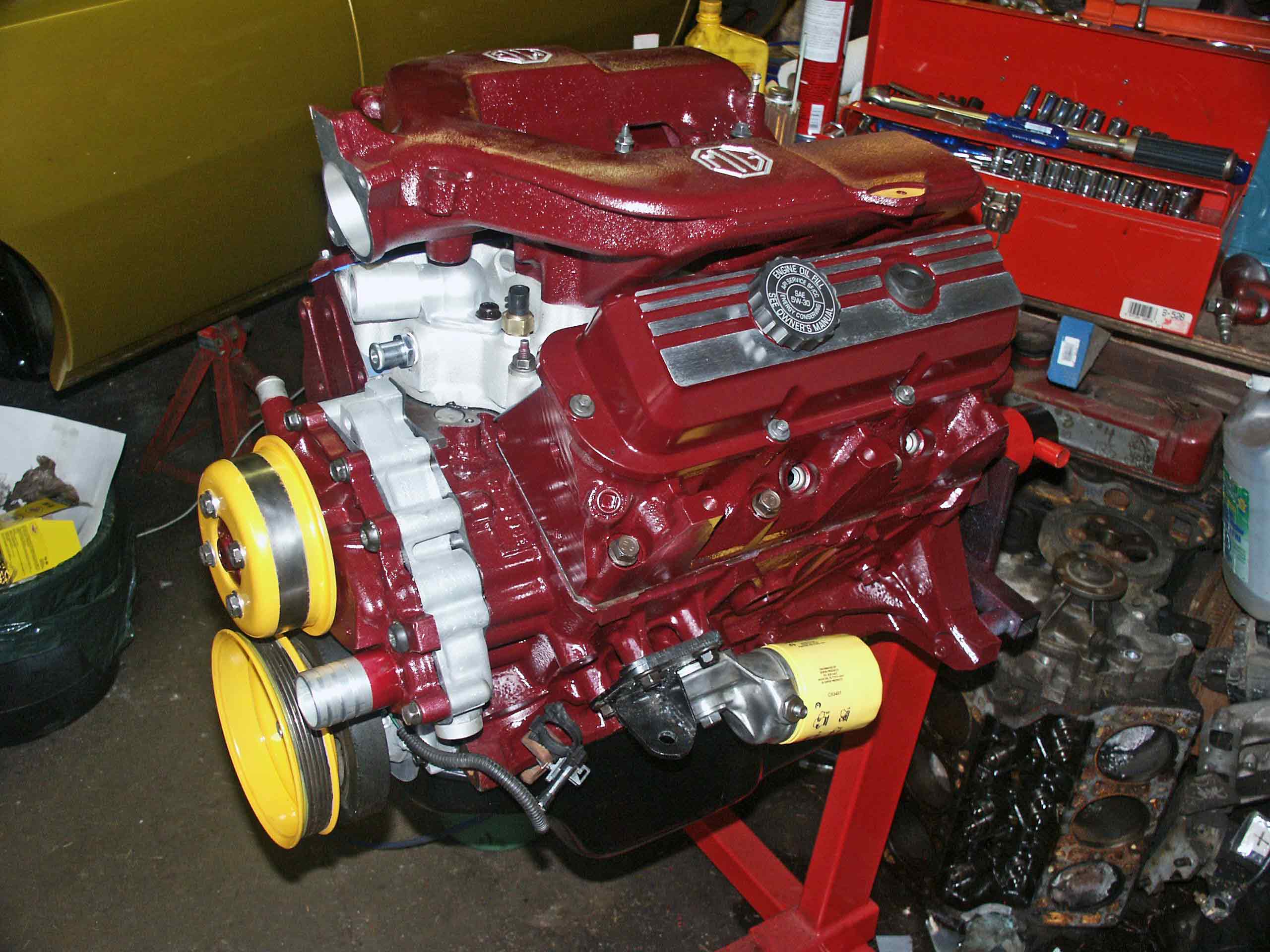

              I'm not likely to do anything more dramatic, since the iron heads are "Stock as a Clock" as per the valve sizes (with the exception of adding in the stronger CompCam performance Valve Springs, Keepers and Valve Stem Locks) As you know from following the build all this time, the only other performance parts inside this DD will be the 0.75mm over bore and appropriate piston set and rings, the Cloyes True Double Roller Timing Set, a CompCam 260H Camshaft, the CompCam Roller-Tipped Rockers and a set of Pacesetter Ceramic Coated Headers encased in rolls of 2" fiberglass heat wrap with S/S ties. I don't expect to see anything more than 185HP even with all of this stuff... But as long as it runs and doesn't lope too much to a stall once it is broken in, this will more than suit our needs.

                              On the intake side, my 62 mm TB required some fancy machining to get that throat on the plenum out far enough. See picture.
                              I have never bothered much on trying to fit larger bore TBs to the 2.8 engines as flow tests I have seen indicate that on the Fiero, at least, the TB isn't the bottleneck - the throat area just inside is (and it is hard to do much about it, hence the replacement Treuleo style manifolds). The 3.4 seems to benefit ast top end, however. Does anyone have any flow bench results on the 3.4 with stock and bored TBs?
