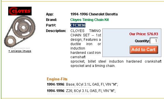

    BUT now if I search for timing sets through Advance Auto, their default is S.A. Gear Who is this? are they cheap or better? price is exactly the same as Cloyes, since you can get both from Autozone and I see the C-3036 price is the same as the 73116 number for the S.A. Gear brand.

            Sad part is, I always thought of Cloyes being a good brand... I guess not.
            Oh and Isaac, the Cloyes and S.A. sets are both 44 bux now from autozone so the price is the same.
