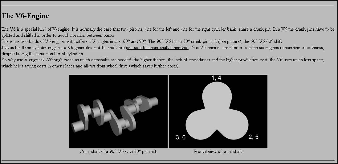

      God knows you must be sick to death of all this controversy over using an HB, but I was up late this evening, thinking about the photos of your chewed up TS and something flashed in my memory about a very unique feature of engines of the V6 variety that might explain the wandering cuts and slices in the gear teeth of your TS.
      One of the odd characteristics in our engines (both the 60* and the 90* Vee Sixers) is that the linear direction of the "ever-increasing-amplitude-harmonics" phenomena is that it moves in a LONGITUDINAL direction, along the length of the crankshaft. And so it would seem that those harmonics would get vectored either forward or aft as they build up and subside, depending upon when and for how long the engine finds itself at those destructive harmonic RPM 'sweet spots' while running.
      This strange action might explain why the GM engineers put a fairly beefy set of vertical thrust bearing surfaces on the sides of the one main journal bearing set... not only as the means of fighting against "torque creep"...but possibly also because this lateral motion of the crank back and forth is being amplified by the concentration of longitudinal harmonic vibrations.
      It follows that since these forces are being concentrated away from the crankshaft end with either a heavy flywheel for the MTs or the lighter flex-plate A/Ts... when you think about it...there really is only one place for them to go...and that is forward along the length of the crank and either out and into an OEM Harmonic Balancer to be properly dissipated and disposed of...or in the absence of this cast iron (steel?) dual-ring designed version... out through the last piece of metal capable of absorbing all these changing forces: The Small Timing Set Gear... thereby wreaking havoc on the Timing Set through the transmission of these violent, uncontrolled vibrations.
      Judging by the poor condition of the teeth on that small gear from your TS... the damage probably happened in different parts of the gear teeth...at the various times in the whole range of RPMS you were driving that wound up creating such a wide variety of scratches and dents...even to the point of looking like the edges of some of the teeth were bent in and then out with a pair of Vice-Grips! So.... Am I nuts...or does any of this gibberish make any sense as an explanation for the condition of the TS after so few miles?
      By the way... This may or may not be Off Topic...But...if anyone doubts the physics behind all of this... just checkout that one "MythBusters" show where the two geeky geniuses of mayhem try to debunk Nikola Tesla's notion that with a little amplifying motor driving an oscillation rod in sync with anything's "natural vibrational frequency"...that would fit into the palm of your hand, he could bring down and destroy anything...even an entire skyscraper in NYC by causing it to vibrate itself to pieces. It was rumored that after strapping his device to a steel girder in the basement of his hotel... it started shaking so violently after his device was running for a while, that he ran downstairs and struck it with a fire axe...just in the "Nick" (play on words intended) of time before it fell to pieces. For their "MB" experiment... "Jamie and Friend" found an abandoned steel girder bridge to d*ck around with their shop-made version of this "engine of destruction".....and ...well...you know...I don't want to spoil the ending for you... It might even be on Youtube by now...
