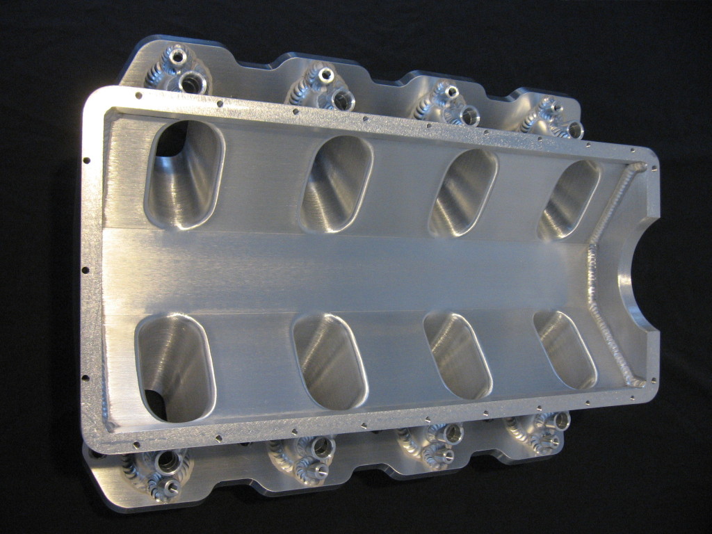

      Seriously though, there is all sorts of room utilizing a design such as this.

        you cant though, your better off to start with a milled off version of the original intake, because there has to be room for push rods inbetween the intake ports, which makes this that hardest obstical, its do-able, but it will have to see a mill once the base is made... then again, and again... i didnt even thing about it myself till i had the intakes off and i was like SOAB, this wont be so easy.

          What are you talking about?!? The design would be similar, not exactly like that. And it most likely wouldn't be milled, but multiple pieces of aluminum welded together. Sure, pieces could be milled, but they could also be laser cut or water-jet cut. That is basically the exact same idea I was thinking, only having different top pieces for different applications. One of these days, I'll get my spare engine from the other house over here, and I'll start mocking something up.

            yes, of course its possible, its just more work than i would intend on doing right now with my crack addiction of project cars. multiple pieces would have to be cut, then welded on and in place, and a final mill for the 60* wedge would have to be done to ensure its sitting flat and straight before you weld on and figure out heights of mounting surfaces (aka blower) then after its all said and done, and it odviously being made out of plate aluminum, it would have had a chance to warp slightly, so i would get everything milled yet once again.
            With our intakes theres 6 separate sealign surfaces to each side, and one on the bottom, thats alot to get right after all that work, where as a SBC hads one per side. each intake runner, coolant jacket, and valve cover area has to be sealed perfectly. i never thought about this before till it was apart infront of me.

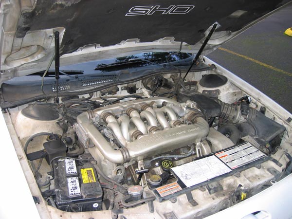

                          I have looked at a lot of intake designs and I do think the Ford SHO v-6 intake would be the ticket to a hp intake. here is a pic

                            Sure those runners look great, but where are you gonna fit the supercharger?
