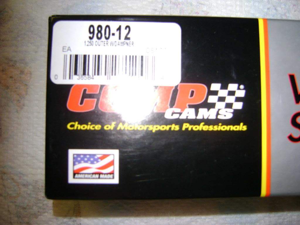

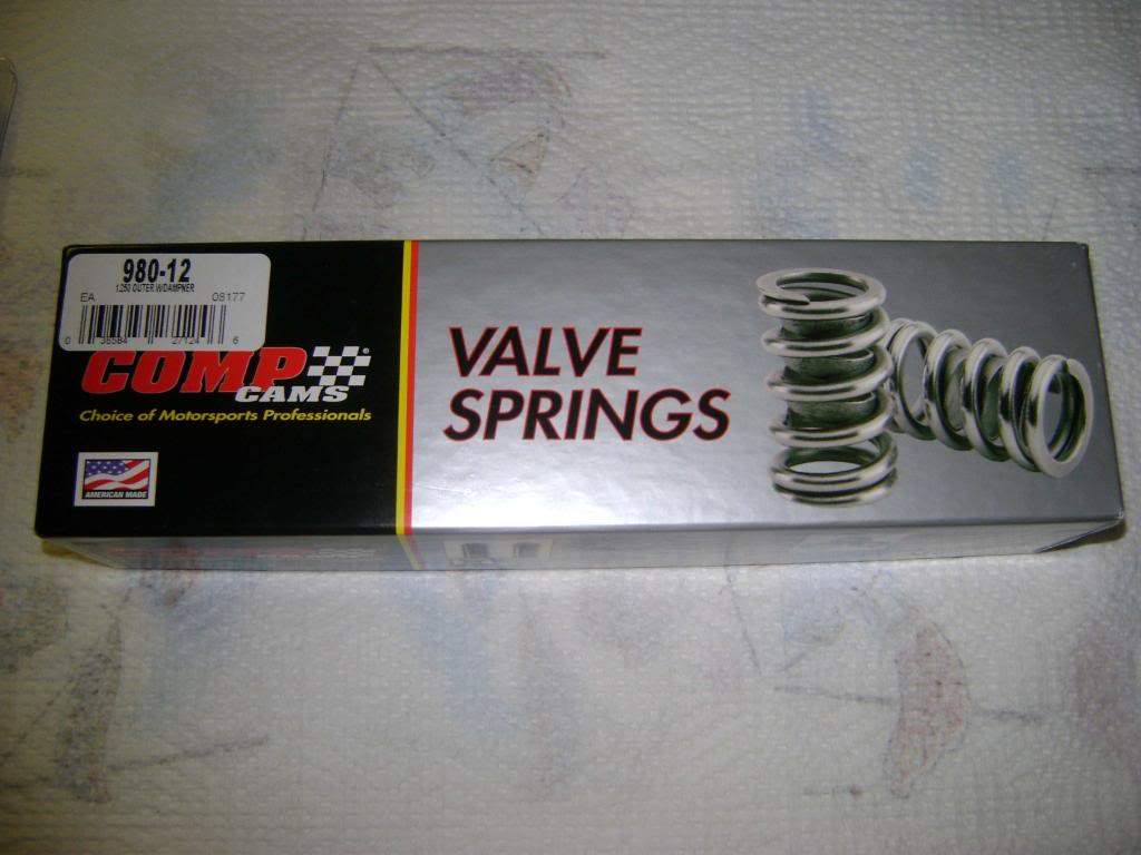

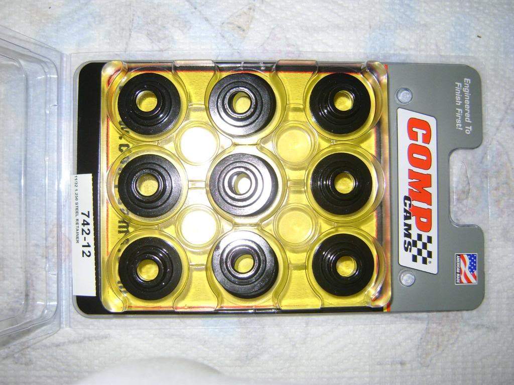

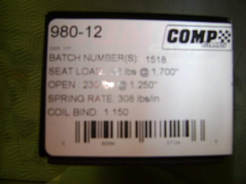

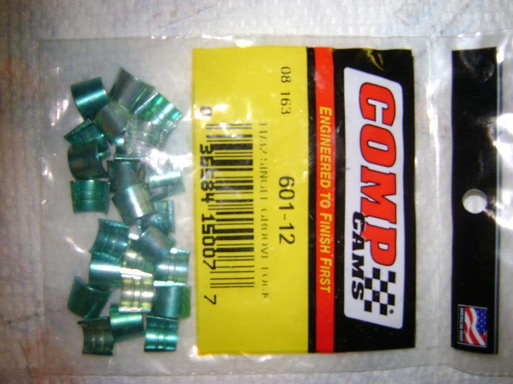

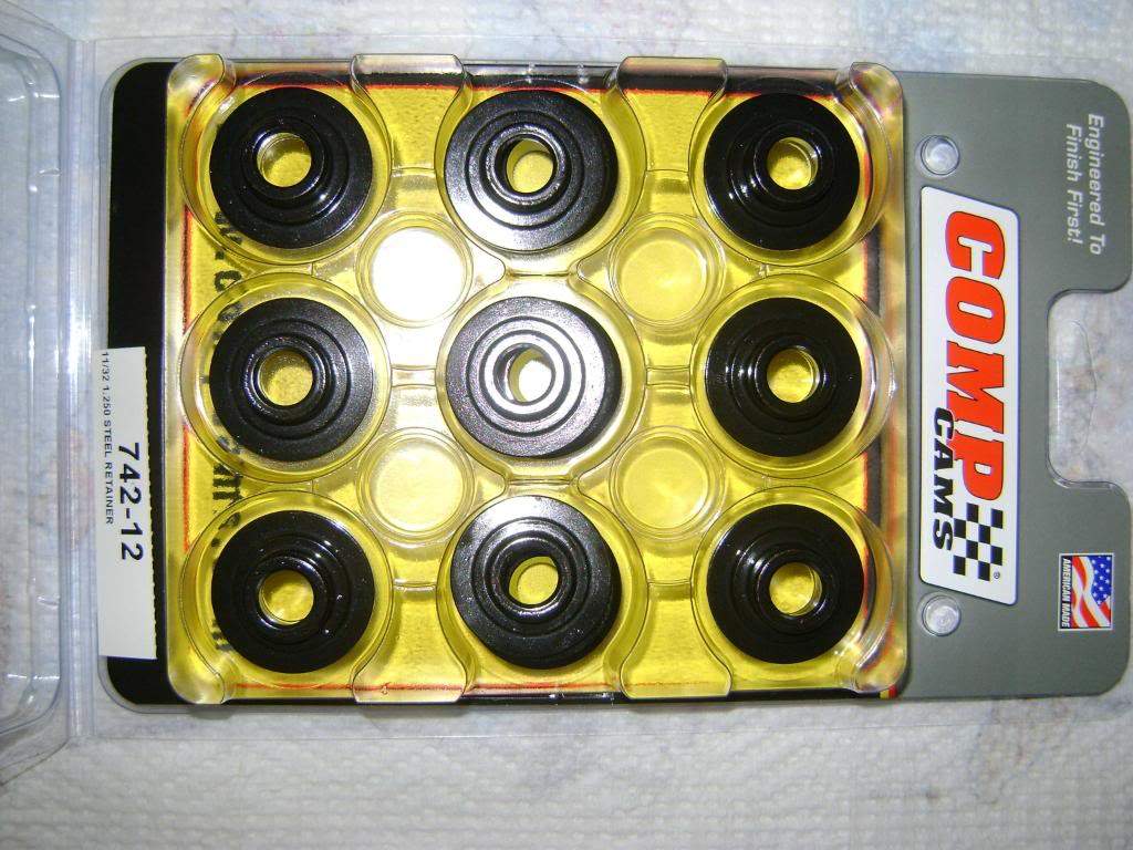

                        If your project involves the GM 3.4L HT Crate Engine... While you have the tin off the Iron Heads... consider these additions as helpful to the cause as well: (See attached images)
                        Your Crate Engine set up sheet will have a caveat about pre-oiling that motor before it turns even one RPM. With a 40% chance of destroying that engine upon start up in its history, they finally figured out that all the oil in their crate engines was settling out during train and truck transports to their final destinations leaving the oil pump, oil galleries and bearing surfaces bone dry. So trust me with this reminder...They mean it. When you prime that motor... It would be a good idea to use a good non-synthetic break-in engine oil like Royal Purple Engine Break-In Oil or Valvoline Racing Oil (with plenty of ZDDP) and a can of GM EOS (Engine Oil Supplement) in that motor along with a high quality Oil Filter, too. When you first start that engine... keep your RPM between 1,500 to 2,000 RPM for at least 25 minutes...without letting the motor idle...and you will properly condition the camshaft lobes with exposure to ZDDP and prevent unintentionally wiping the lobes off the cam. Afterward... shut the engine down...change the oil and oil filter using the same kinds of oil/supplements/filter and drive the car around at normal speeds not exceeding 45 MPH ...gradually accelerate and decelerate for about thirty minutes or so and give the engine parts a chance to comfortably break in. Keep using the engine oils as described above and change the oil once again at 500 miles and later at 1,500 miles... switching to a good synthetic like Mobil 1... otherwise...if you keep using engine oils with a high concentration of ZDDP...your CAT Converter Platinum Screen and O2 Sensors will become coated with Zinc and be useless. Best of Luck with Your Build!
                        Here is some information on a New Engine Pre-Oiler Tool I designed for the GM V-6 engines that you can make yourself:
                        For more tear down and build images on this very engine, please visit my photobucket for parts/pieces and part number images.
