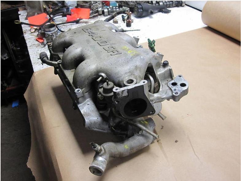

            Is this intake any good? How can I identify it as a good one with good flowing properties? The person said is from a 93-95 Camaro but as far as I know these didn't come with AL heads. Can anyone shed some light?
              • 9179
              Definitely didn't come off of a Camaro! Since it has the lettering on the top, it most likely came from a 99+ 3400, which would include the Grand Am GT, the various vans, Alero, and a few others. I say 99+ because most of the vans from 96-99 had a bare plenum (ie, the 3400SFI wasn't on the top). Try to find a large, 2 digit number on the lower section and report that back.
                  It doesn't have any large numbers on any of the sides. At least from the pictures that the owner provided me. Does that means is from 99- and not from a van?
                    • 9179
                    Well, anything 96-99 would come from a van anyway, as the 3400s weren't put in cars until 99-00 (depending on model). Not sure when the vans started getting the 3400SFI on the plenum. I just know that for a few years in there, the van plenums didn't have it.
                    As far as if its a good one or not, can't really tell from the pictures provided. The large port (which this is) are the best flowing overall, but there are slight differences between the years that provide slight flow improvements over the other years. If the price is right, I would probably say it will work just fine. If you need a slightly better flowing intake, you can always upgrade at a later time.

                      The pics show the area where there would normally be a 2 digit number but its blank. Also the EGR points to it being the pre '00 minivan intake. I guess they must have come with the 3400 written on top and the old style EGR. But for the right price it would still be worthwhile. A far cry from the Gen2 top end.

                        And even farther from the Gen1 top end from a Fiero. I guess the slightly lower flow won't be so much of a limitation when running on boost. Like bszopi said, I can upgrade at a later time. Heck, this is already an upgrade.
                        This person is selling me this whole setup for $125. I belive is a good deal. What do you think? Should I jump on it?

                          Both upper and lower with fuel rail and injectors as you have pictured is a pretty good deal for $125. The pushrod guides you need can also be found on all Gen 2 motors (2.8 and 3.1 aluminum head). I'm sure if you search google there are plenty of sites that show you how to determine pushrod length with a picture tutorial.
