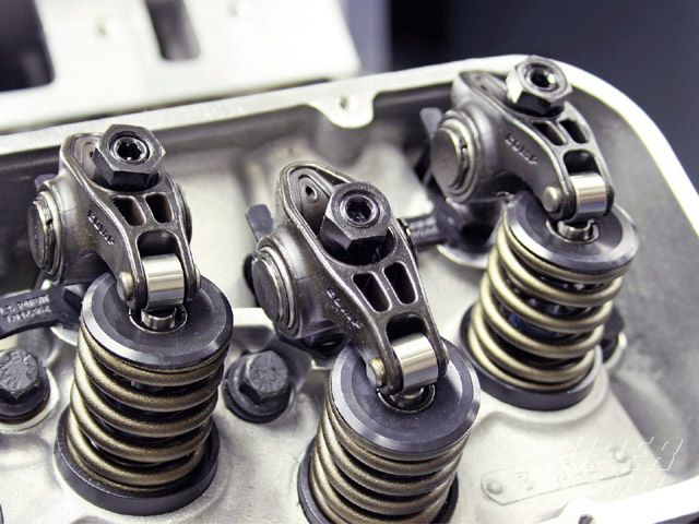

                              Here is a pic of a set of Harland Sharp rockers on Gen 2 alum heads.
                              Pic of stock roller rockers and their pedestals in the following article : http://wot-tech.com/shop/articles/sm...rt/cat_63.html
                              I've taken a stock one apart, and I just don't see trying to make it work with an aftermarket rocker.
