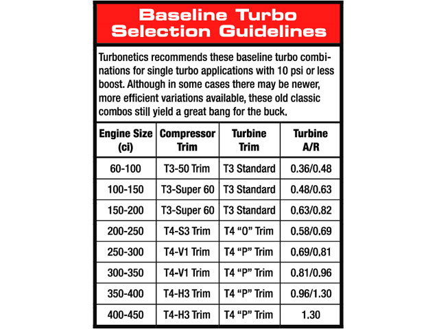

    This is the only thing I can really contribute.
    But you prolly already knew all that
