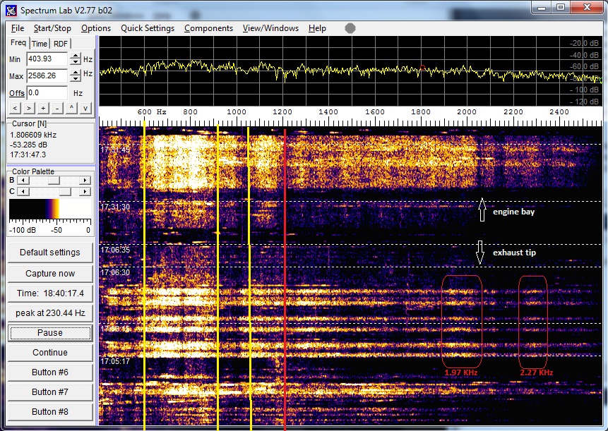

                I did a spectrum scan and found two higher frequencies in the exhaust note. At 1.95 KHz and 2.27 KHz.
                I figured a side branch resonator would do well to cancel out those frequency ranges. They will each be less then 1' each due to the frequency.
Name:	exhaust spectrum analysis.jpg
                The yellow lines on the left are the boundary lines of the dominant exhaust note, the meat behind the tone. When rev'ed up the exhaust has a mild rasp like any exhaust does. This analysis is showing me there are two frequencies at a higher amplitude. Probably the result of exhaust harmonics in the pipe or what ever. But now I can neutralize them.
                The software is easily found, sound analysis has dozens of great programs out there. With a good microphone, anyone can record their exhaust tone and look for any high pitch frequencies standing out. The side branch resonator can be determined what length needed to neutralize the specific frequency.
