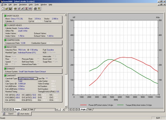

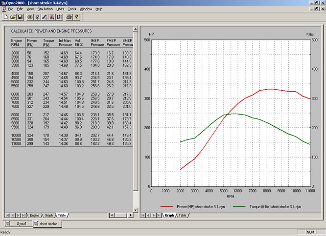

                    I sat down with a cold one last night and looked thru this thread and found the bore/stroke and cr, cam spec's and installed cl. Head flow numbers, all that good stuff and punched it in to a dyno program just to see how it ends up. Real interesting on how it responds to intake style. Click image for larger version
Name:	2.8 IR manifold.jpg
ID:	377298Click image for larger version
Name:	2.8 Single plane manifold.jpg
ID:	377299Click image for larger version
Name:	2.8 Tunnel ram manifold chart.jpg
ID:	377300Click image for larger version
Name:	2.8 Tunnel ram manifold.jpg
ID:	377297 Big change going from a IR setup to a single plane or tunnel ram set up. Makes you wonder just how good the dyno program is in this case! 330 HP 2.8 would be something to see.
                    This is with no changes to cam or carb!

                      Don't copy any V8 manifolds because they do no fire bank to bank. Most people think a V8 is two I4 motors spread 90* apart when in fact they are two 90* V4 motors meshed together. What this means is that you have 2 cylinder on the same bank that fire back to back. For Example you have the typical small block which fires 18436572 this makes 8-4 and 5-7 fire back to back. You get 8-4 on one rotation and 5-7 on the next. So to compensate for this you end up with dual plane intakes with compromised runner design. On a V6 you have even bank to bank firing so you can design a high performance dual plane that does not compromise on runner design. Especially if hood clearance is not an issue. Now most would think that you should just jump right to single plane like you would see on a high rpm V8 but you can successfully make a dual plane V6 manifold with good equal runner length and you will have a great combination of high RPM power and good low speed signal to the carb because of the strong even intake pulses on each bank of the motor.
                      This one is a GM High Performance manifold for the 4.3L V6. It has a top that covers it and mounts a single carb in the middle. GM recommends welding in a divider to separate each bank for improved performance.
                      This is the Edelbrock 2.8L manifold. The carb mount is removable and underneath you will find the drivers side of the carb feeds the passenger side cylinder head of course the passenger side of the carb feeds the drivers side cylinder head. This is done to increase runner length.
