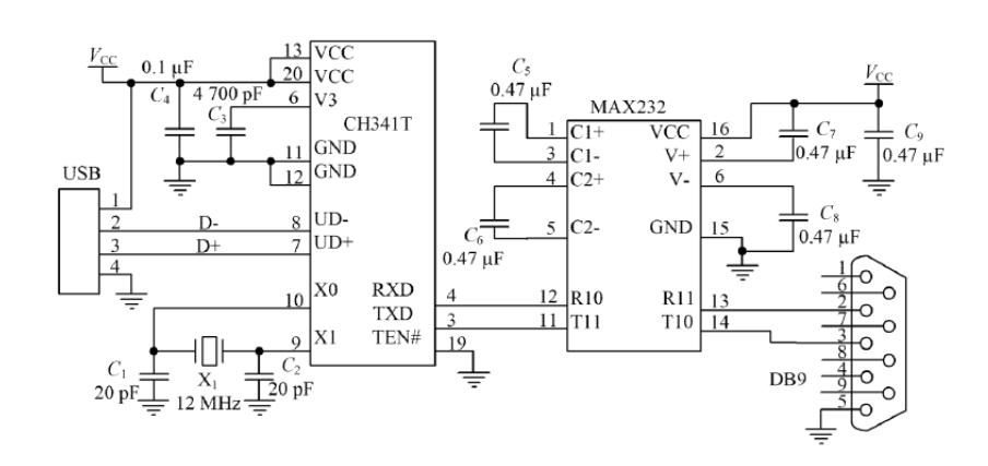

              That's because pins 1 and 9 are only used on ancient computer hardware... namely serial modems.
              Here's a basic USB to serial circuit...

                The cable had 9 conductors (10 if you include the shield) inside... there was no reason not to connect them... That being said, looking at the reviews for the cable i bought, and there were a bunch that had problems with different pins not being connected to anything. I ended up using a Keyspan USB adapter, I would spend way to much time making one for it to be worth not dropping $25 on something proven.
                • manbearpig
                  • Oct 2017
                  • 59
                  #788
                  I wasn't suggesting making one, I just posted that to show you that you only need the transmit and receive lines and a ground (pins 2,3,and 5) to have RS232 serial communications. All the other pins are long obsolete...

                    Gotcha, the MS3 wiring guide says pin 9 is needed, so I used it. I'm not much of an electronics technician...

                      Hmm, well if it's using pin 9, then you would need a full port emulator and not just a USB to RS232 adapter, which is what the cheap ones are. Could explain why it wasn't working.

                        it wasn't working due to the B+ fuse being blown like mentioned in my above post. The above pictured dongle connects to a Keyspan serial to USB adapter, which emulates a com port.
