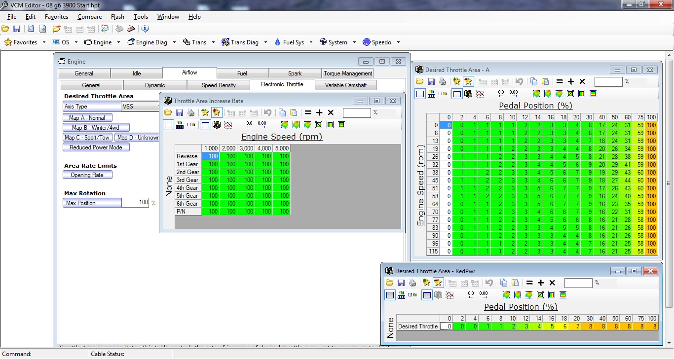

                    As for the throttle body, believe what you want. You can bring up other motors and your opinions to doubt me, but I have tuned a 3900 with and without the drive by wire. Yes, throttle maps and all. If you go too far with the DBW maps, it goes into safe mode. It may be a dumb stepper motor but it has physical limitations for how fast it can react. The software is setup to recognize this and in turn, cut you off from the fun and make 100% input = 8% output. Click image for larger version
ID:	376912 The cam timing helped improve response and output, cutting spark timing to get rid of KR helped, and changing the trans settings helped a lot as well. Nothing compared to make that throttle table a 1:1 ratio across the board. That included laying into it. HUGE DIFFERENCE.
                    I can't believe you asked me if I tested this shit at idle.

                      Can you post some times or dyno numbers without the DBW throttle body?
                      I have a hard time believing that GM put such a large TB on it and won't let it open fully.
                      What is the TB position at full pedal and 60 MPH?
                      I'll be able to confirm with a bench test of the ECM I have.

                          All street tuning. This isn't about WOT only testing. Its about trying to change lanes and not get hit by the truck in the next lane because the damn DBW delayed the throttle so the trans could shift. Its all integrated to be a warranty saving, detached feeling driving experience.
                          I don't need a dyno to tell me its an insanely huge difference. But I am wasting my time. Go do your thing, and share it with us.
