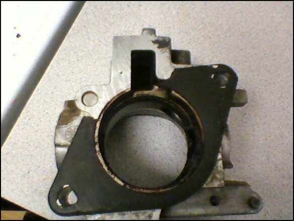

          Where do i need to grind? this is the stock TB and the one i got doesnt have the passage at the top at all, i can pull the new one off tomorrow for a pic of the lack of iac passage

            • 13505
            It has a square on the one you are using and you need to notch it to look like the original. Well, not that much but you get the idea.

              so i pulled the new TB off and ground out the space between the passage and the actual bore and now the car runs like it should again!! Thanks for the help fellas
