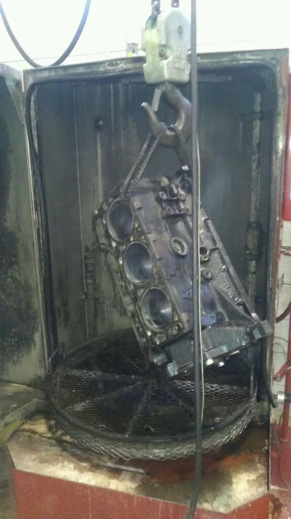

    Okay so the motor is completly apart i am working on cleaning it at the moment. I put it through the hot tank and took some solvant to it and its starting to look good!
    Im going to order my 3400 and 3500 intakes and 3500 heads and the turbo cam. And the valves and springs. Then after that i will be purchasing the forged pistons and rods after Im ready to start honing and boaring. Im thinking about going 20 over not sure yet though.
    Im really missing driving the car though any comments from anyone is very apreciated if you have any ideas on the motor build or prep for my turbo build. Thanks for looking.
