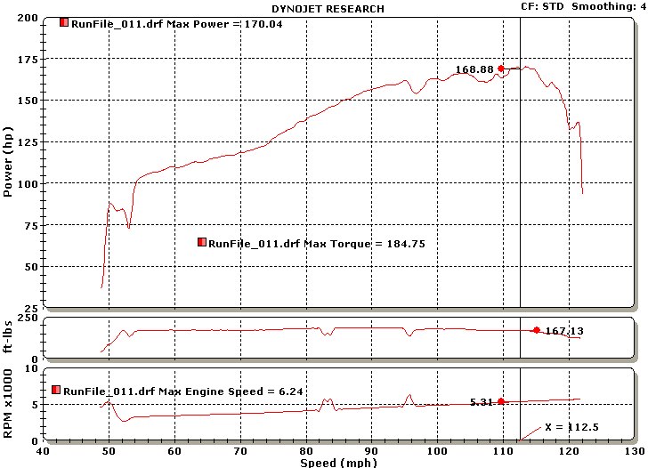

        + 8 whp with our stage 2 3400 upper and lower
        + 2 whp with a 65mm LX5 throttle body
        Seems we have an issue with break up at higher RPM. Could be more...but we have the same looking graphs for the before as we do the after so that works for now.
        Had to use facebook to convert the .bmp to a .jpg.
          [ATTACH=CONFIG]7265[/ATTACH]
          Does the car have headers yet? I would bet that you could gain quite a bit through a good exhaust.

              I'm gonna take a guess and say headers/exhaust will bump this over 185

                I agree. I'm thinking around 190ish.

                  I'm hoping to see about >193 pop up there, but I don't know if the stock cam will do it.
