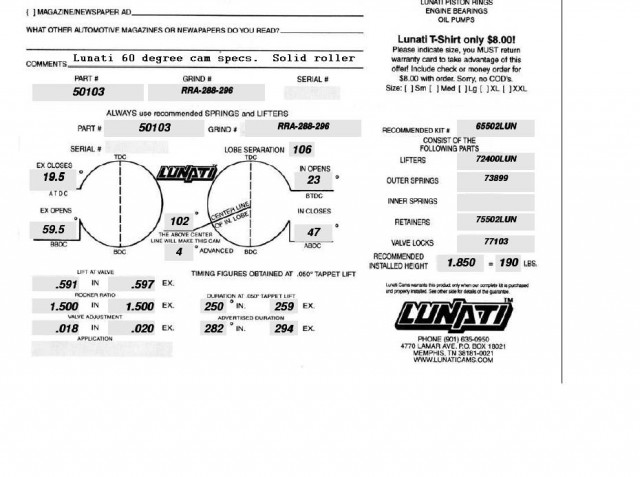

    I picked this cam up and need some info on it from the cam experts. Right now the motor is in a fiero with a 4 speed with stock manifolds into 21/4 duel exhaust. I am running $12p in a 165 for a computer. Any advise on compression. I know I will need new springs and retainers. I have the solid lifters. This is just a weekend car so I can live with some lack of drive ability.
    whttp://60degreev6.com/forum/attachment.php?attachmentid=7350&d=1361384175&thum b=1&stc=1ant
    A bit odd that its a Lunati 60 degree v6 cam but they have recommendations on SBC lifters and SBC non conical springs, seems like they don't know what works with the 60 degree engine. Also the 1.5 ratio is wrong, since roller 60 degree setups had 1.6 ratio rockers.
      It will do better with higher compression of course but should be ok at the stock 9.8:1 of a 3500. That is a lot of cam though, actual lift is .630in/.637ex.
      a ported top end, good headers with a good tune and that's going to be a serious engine.
      You are really going to have to check piston to valve clearance, my cam is .539in/.549ex with about the same duration as yours and my exhaust valves dug .030" dents in my pistons. You are also going to need new adjustable rockers and the heads will have to be machined to get enough installed height.
      Ben's PAC1518 springs should do the trick after the machine work though. http://wot-tech.com/shop/gm-60v6/pac.../prod_223.html
      Does it use a gen 3 or gen 2 timing set?

        gen 2 on the timing set. I have crane gold roller rockers in 1.5 ratio that i can use. My concern is the 106 lsa as I have read it should be 110-113 for efi set ups. Can I use the the gen 2 timing set on the 3500?

          Ok the 1.5 rockers will definitely help the cause of it being way to aggressive lift wise... I also have 568 lift on my cam for the exhaust with 240 duration at .050 and I have dimples in my pistons as well
