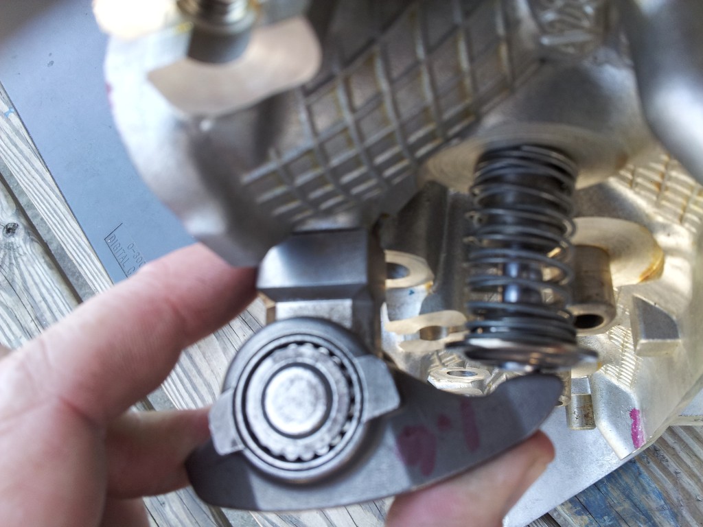

                                • 13525
                                #30
Name:	17rocker (Medium).jpg
                                Roughly .700 lift max on stock rocker. Roughly .540 max lift with 3900 rocker. Geometry on the valve tip at .540 is why we didn't move forward with making these work. Its already on that edge with very little lift. Interestingly enough, the 3400 rocker on a 3900 has the best geometry of all the combinations. Starts on the inside edge and is dead center for everything else.
