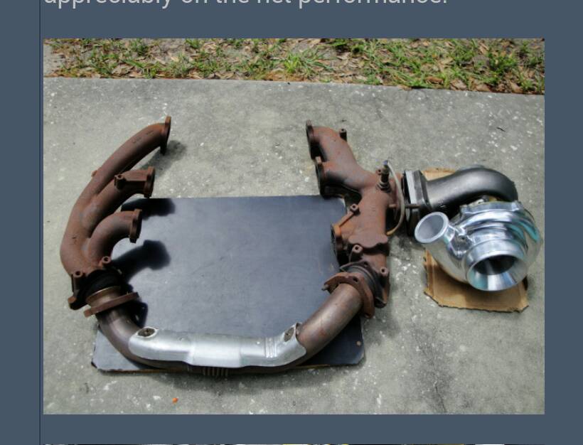

            I think it was one like that, it only showed up on tapatalk though. They save space for sure but man do they flow terrible. I'd hate to see you go through all that trouble and then be disappointed.
            BCC should sell the flanges for them still, This is kind of how they would work in your application;
            It doesn't get much easier than that, just a few 2" U bends to weld together and you're done. Remember to add a flex pipe between the banks though.

                    I'm pretty sure those are 3900 manifolds
                    Do you even have room for a turbo behind the engine?

                      I measured and I might. Would 3900 manifolds fit 3500 heads?
                      • caffeine
                        • Jan 2012
                        • 1489
                        #26
                        Nope. But you can use stock 3400 or 3500 minivan manifolds for pretty much the same downpipe location
