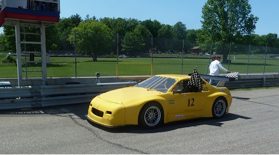

            Any pics of your curent setup and vehicle?

                  And here is a picture of the race car.
                      [ATTACH=CONFIG]8330[/ATTACH]
                      The LX9 block comes from GM with 2 mm bigger bore than the 3400 block so definitely go for that. Will LZ4/LZ9 heads fit that block? Can you use them?
