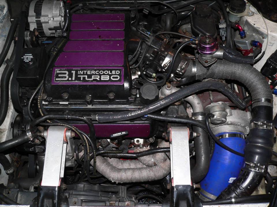

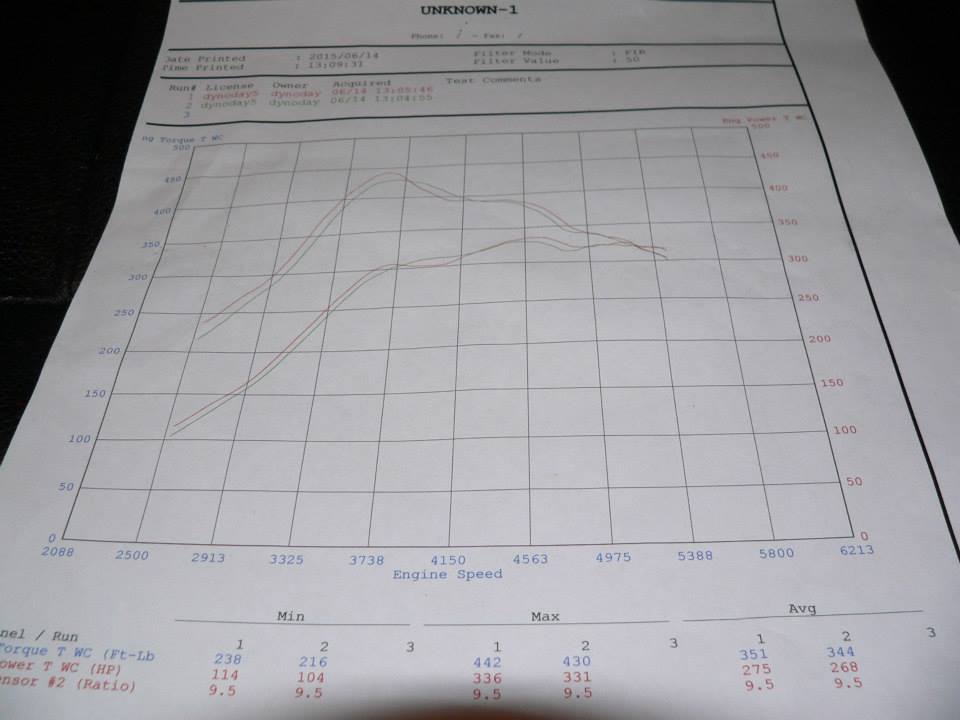

                        • 112
                        I never dynod it on the 23psi I used to run, only at 16psi when it had headers and it made 321hp 408tq @ 17psi with ported TGP logs. the 981 cranks actually twisted and bent for me quite a few times before I finally had the 3500 crank machined to fit the block. The journals were always ok on the 3500 crank just that it broke at the radius. I know it wasn't right but at the time I didn't have all the funds to swap rods and such. It worked for 16k miles so whatever Im not happy but it was a lesson learned.. Either way this thread isn't about that engine.. Its about the latest project. I already have most of the parts and Im all about building a gen 2 3.1 block since that's what my car came with.

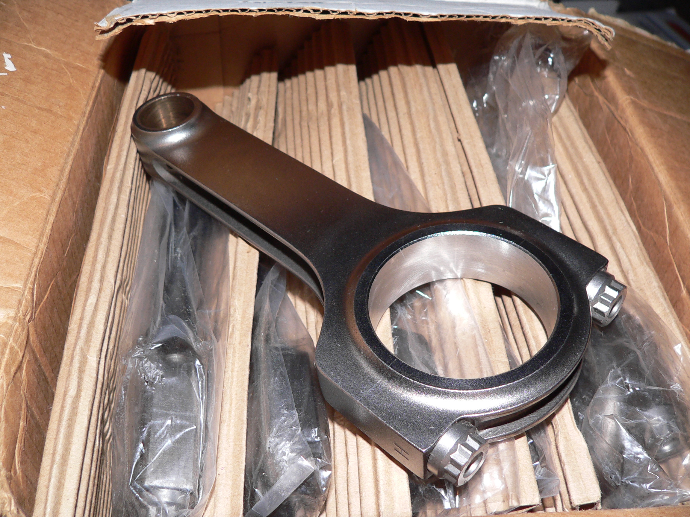

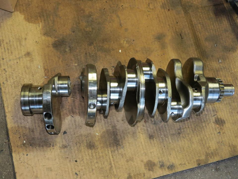

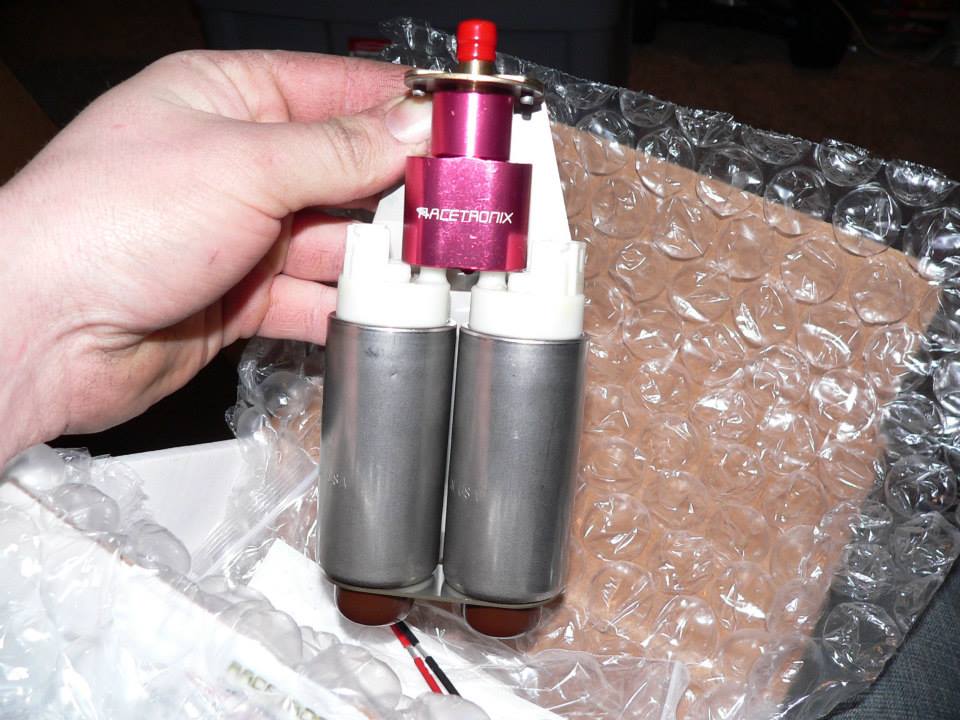

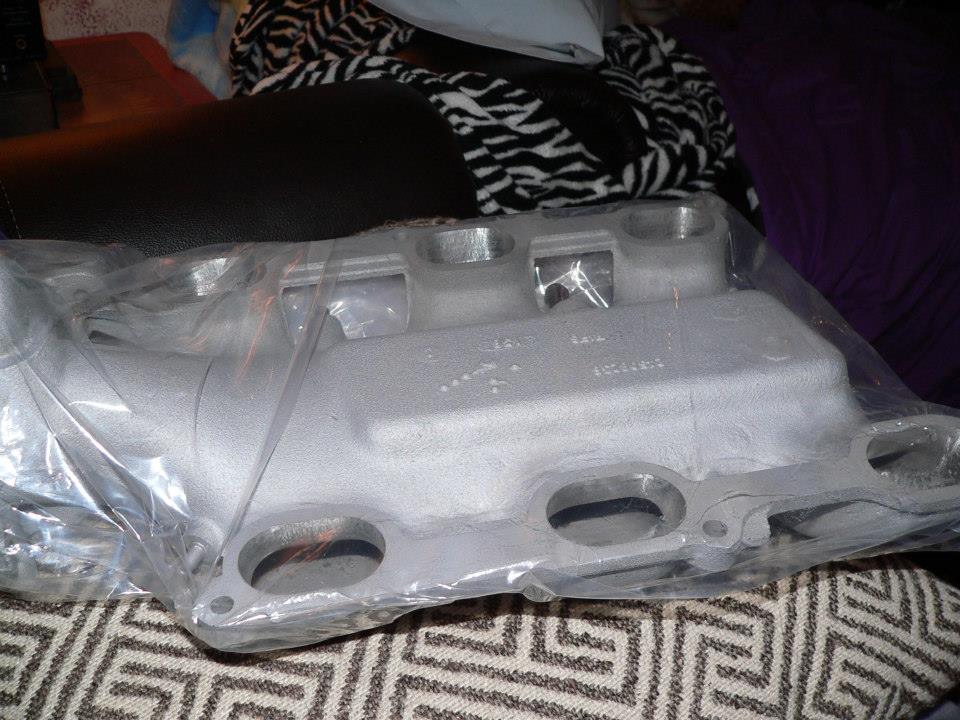

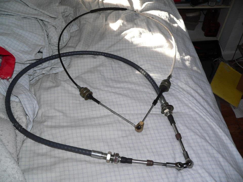

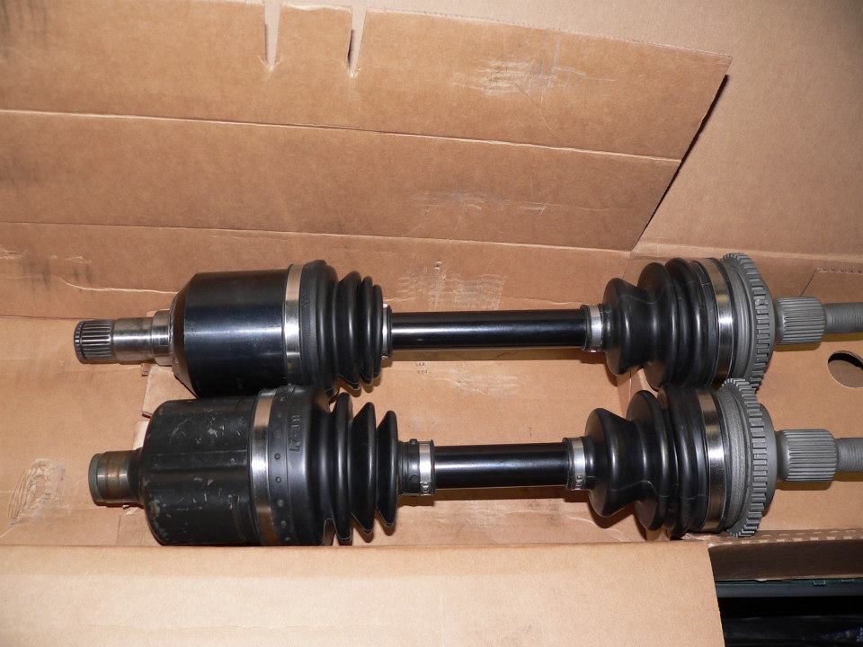

                        • Mach 5
                          Speed Racer
                          • Feb 2007
                          • 112

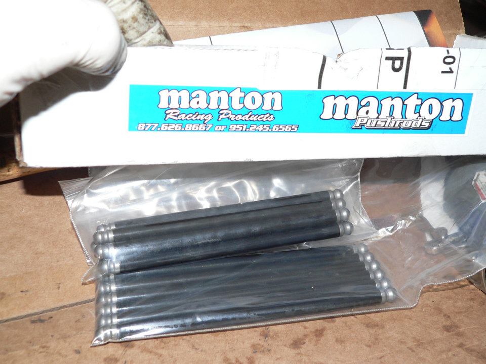

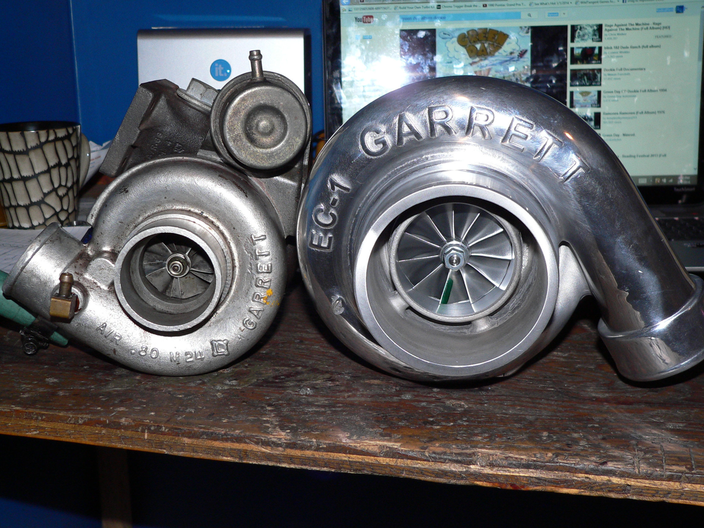

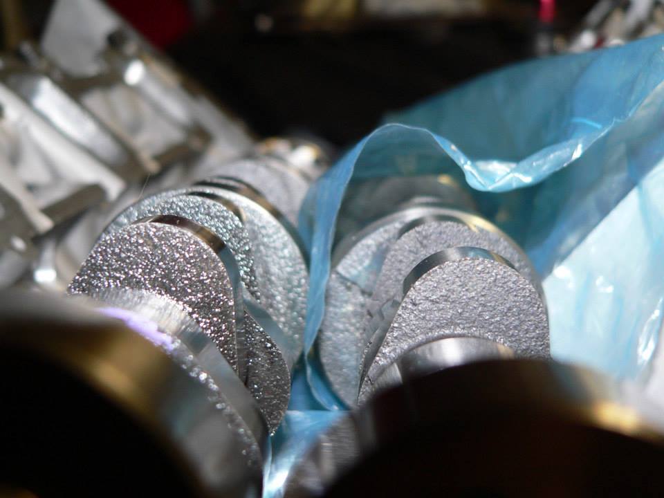

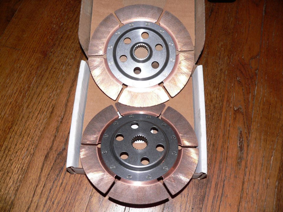

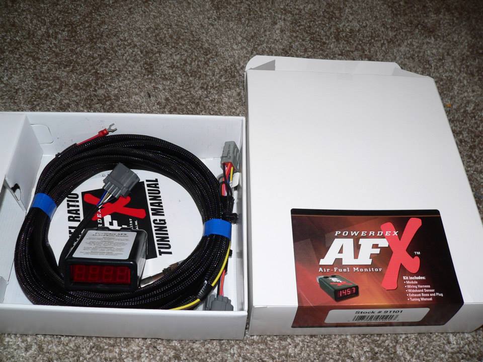

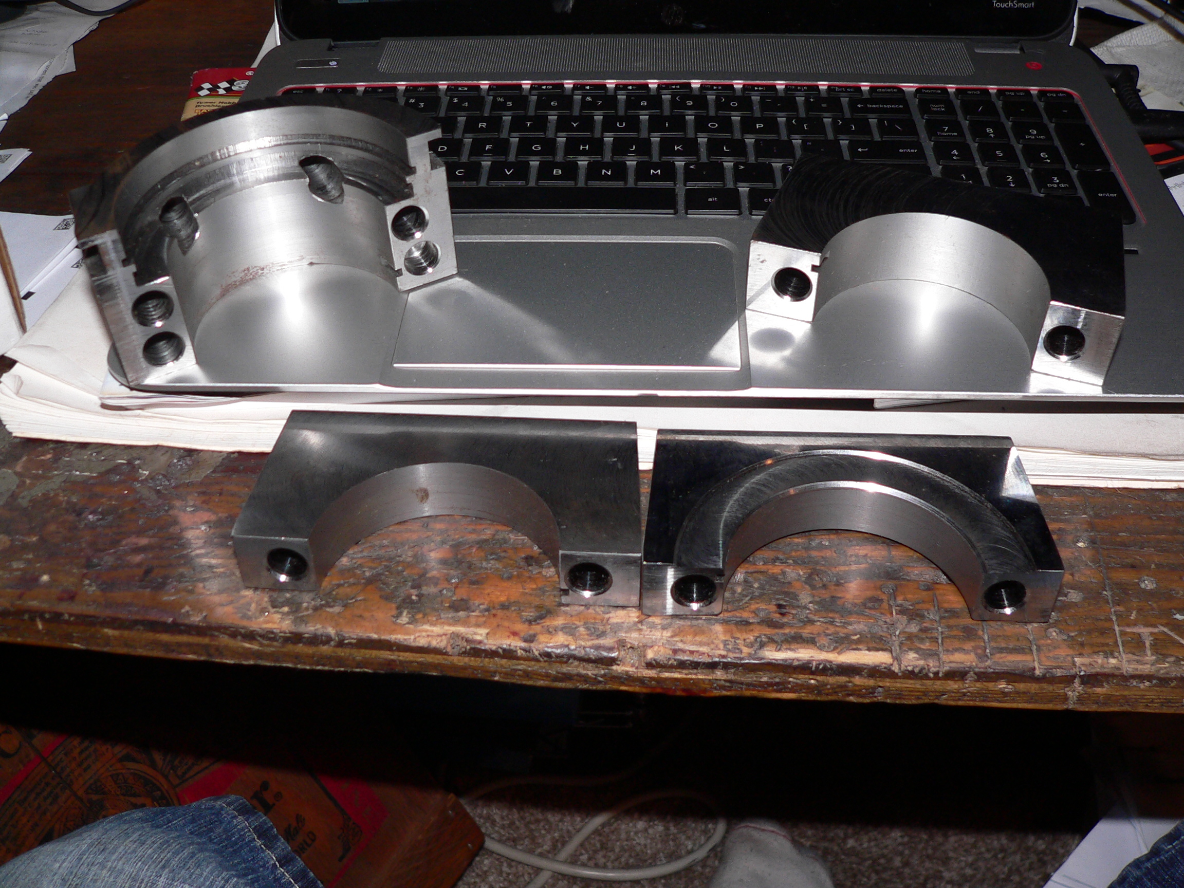

                          some pix..
