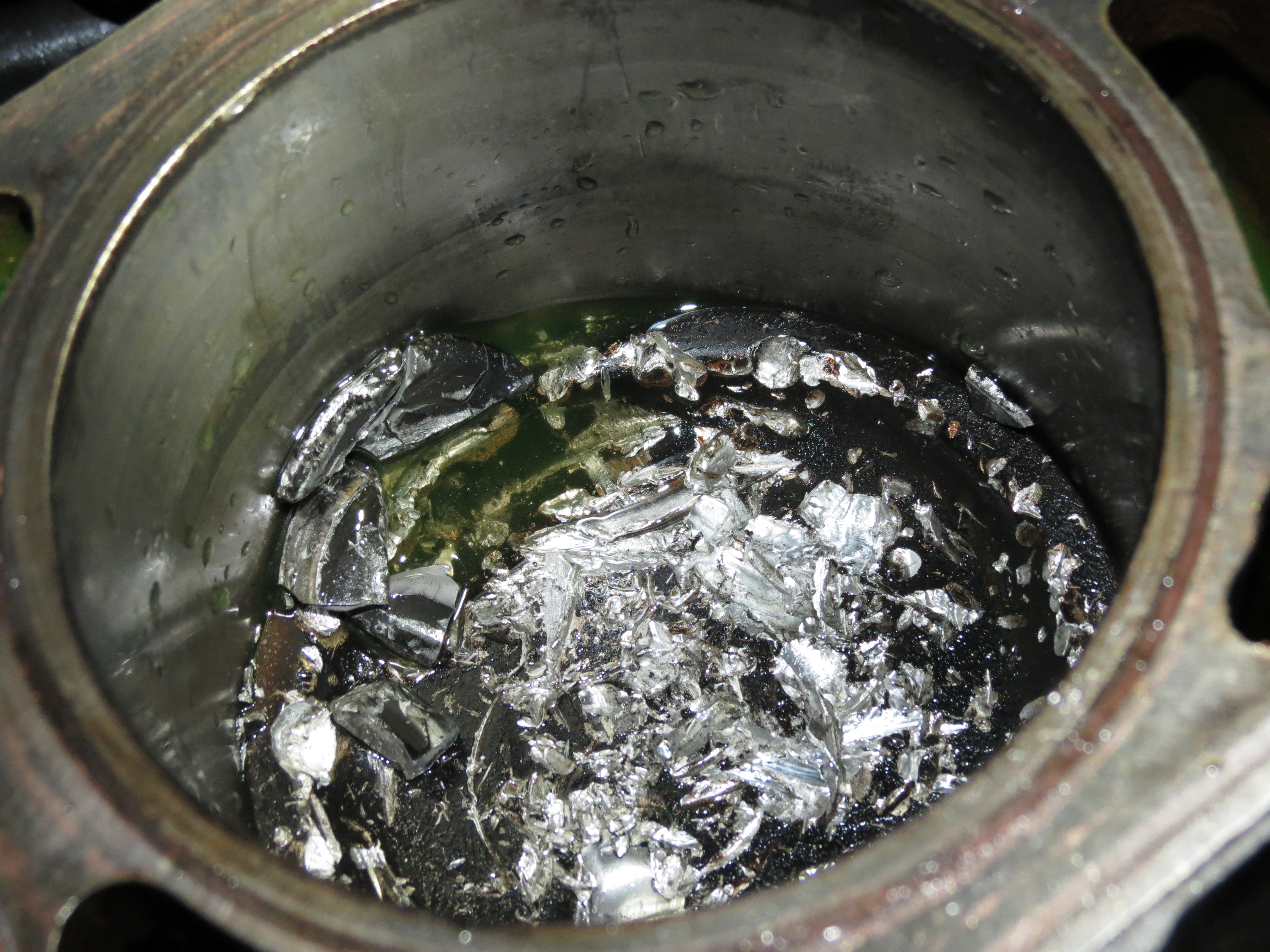

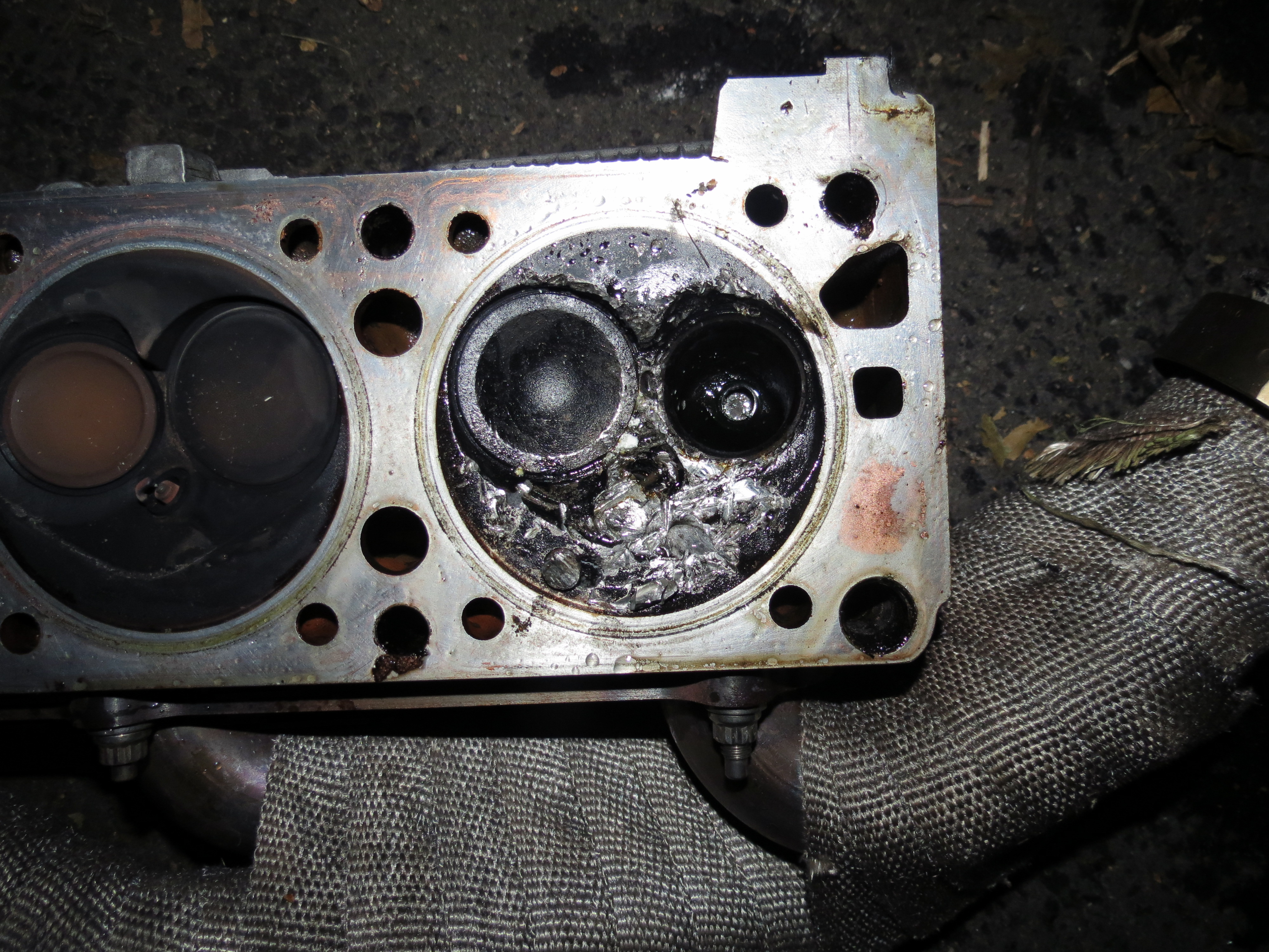

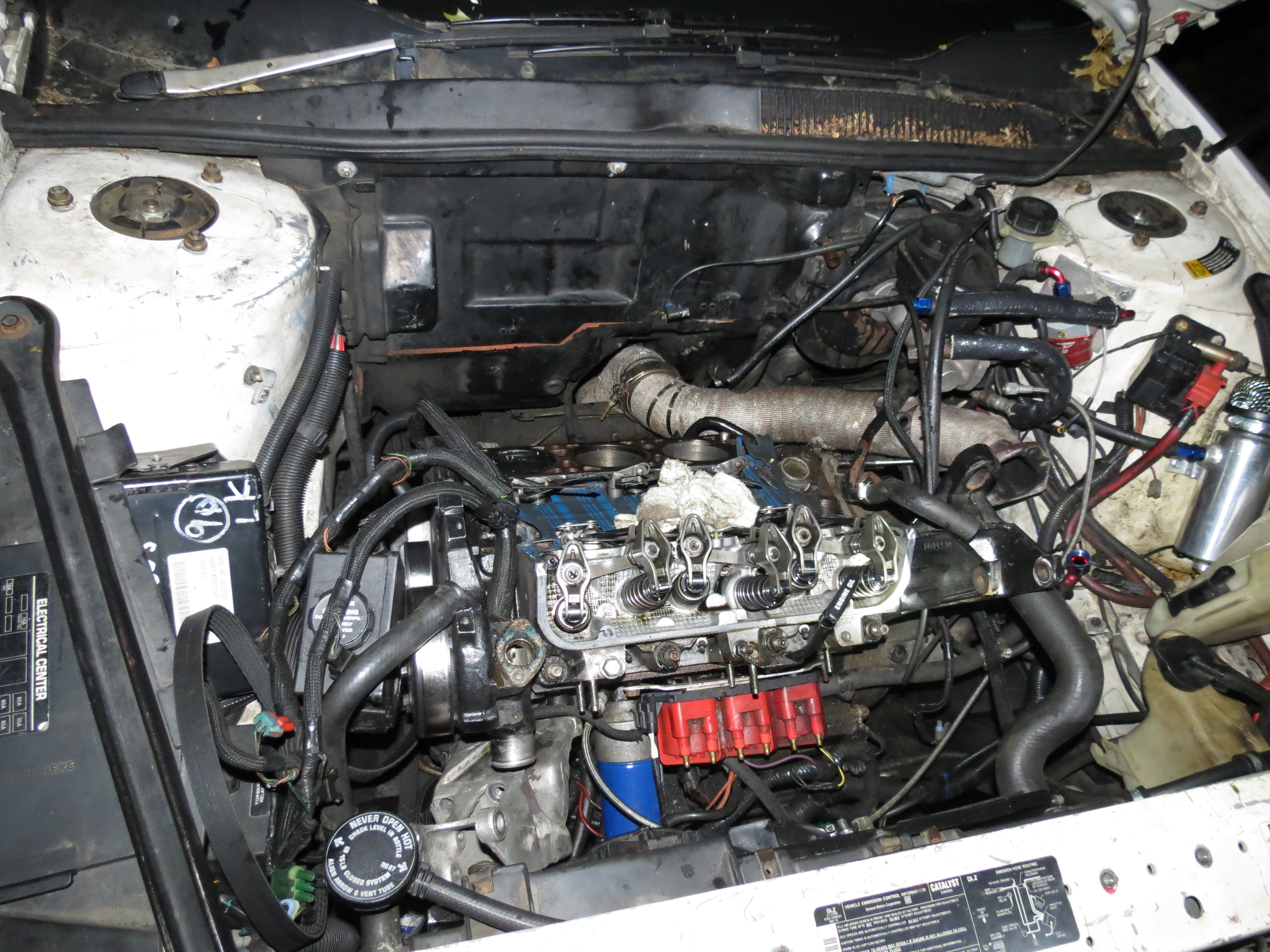

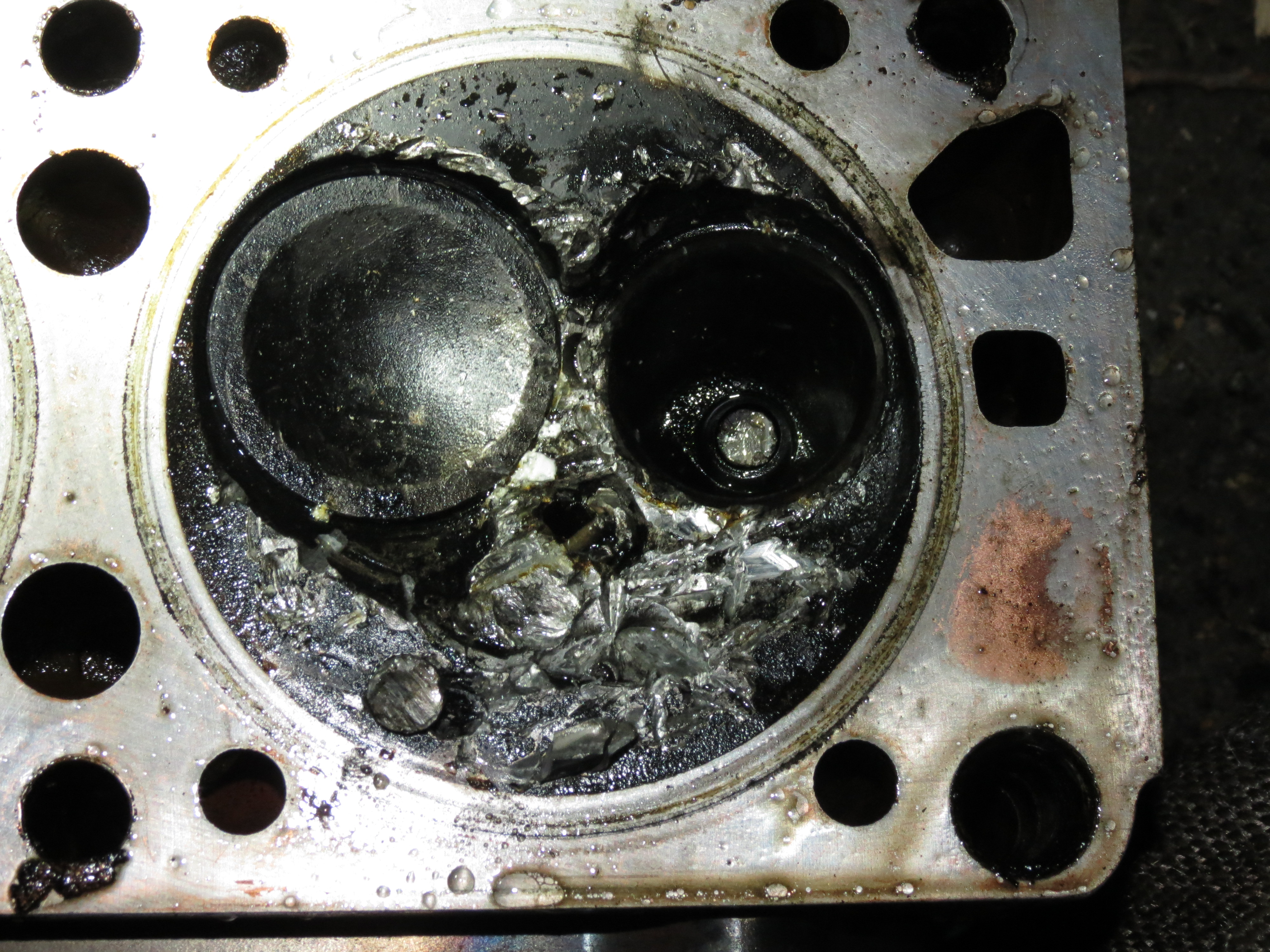

                well I was wrong.. the crank didn't break this time. I just guess since I was frustrated. realized something else was going on when I started pulling it apart and found coolant in my header. This time I broke a valve head off on cyl #5. I gotta continue tearing it done. we believe the valve broke due to a combination of my short runner header for that cyl and excessively worn valve guides for the exhaust.
