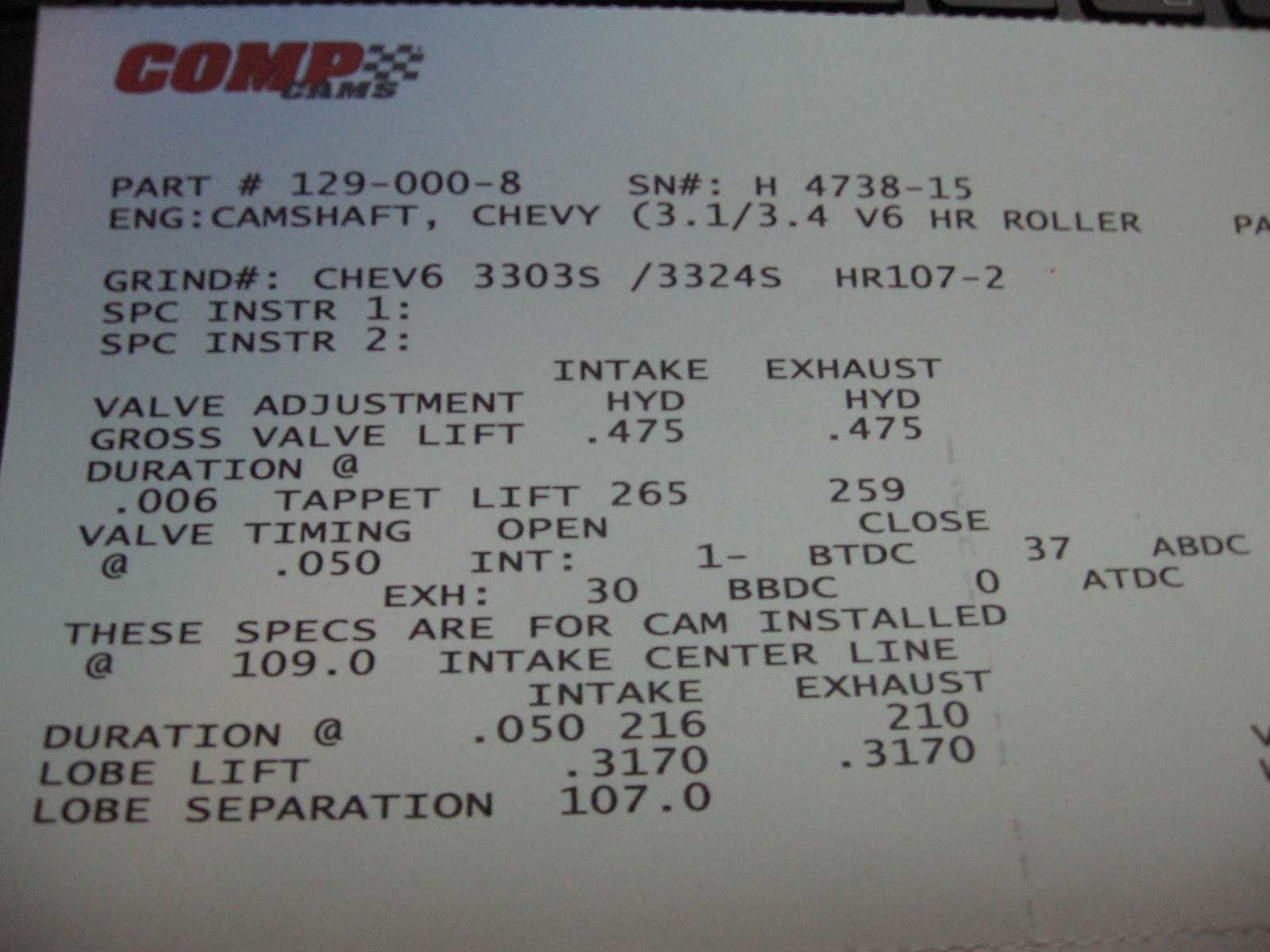

                  Cam timing or ignition timing is likely wrong.
                  What exactly are the camshaft specs? Generally you're describing a very retarded cam, or not enough ignition advance at low speed when using a cam with seat durations over about 280*.
                  This assumes that you've already checked/confirmed plug wiring...a lot of 6-cylinder engines will run in the proper direction if you put the plug wires on in not quite the right order.
                  EDIT: You "originally" had synthetic engine oil in the engine? As in for break-in???? Big no-no. Can cause serious ring-to-cylinder-wall interface issues. Might wanna check on that.
                    I had told the installers I wanted regular oil put in for economic reasons, since it would soon be changed out, but they put in synthetic anyway, they told me. I did not research break-in oil, since I thought some new model cars came with synthetic from the factory. I changed it to regular oil after about 20 minutes of runtime and a slow 3-mile drive from the shop.
