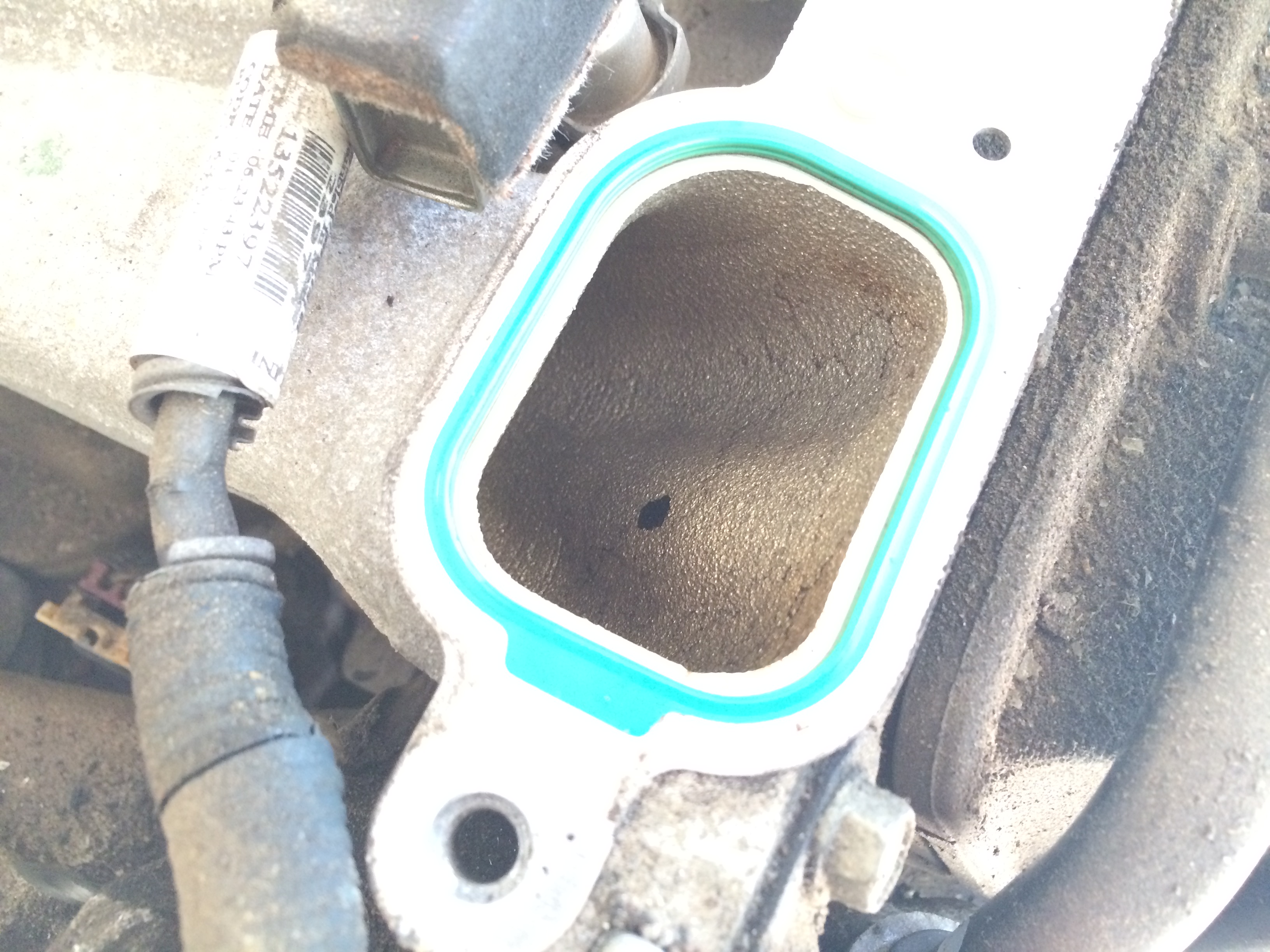

          I would find an extra lower, and port the lower where it mates to the upper intake. quite a bit of material can be removed. will you notice the power? prob not. If you gain 1 hp per cylinder from it, its not enough to make any real difference but efficiency will improve.

            Don't port the lower to head port, or the intake port on the heads. The rest would need a dyno to convince me of the value.

              Porting the lower intake manifold brought my combined head+intake flow up from 185 to 214CFM at 0.500" lift and 28"WC. Without the intake manifold, the port was at 234CFM with a 1/2" radius inlet, but was unstable and howled loudly. With the unported LX9 intake, flow dropped to 185CFM, but the howl went away. The majority of the work as at the upper-to-lower gasket face, on the inside of the turn and roof of the lower intake manifold. Once that, and some work around the fuel injector boss was done, flow came up to 214CFM and the port remained stable, I called it a day and screwed it together.
              Porting the lower can have a very positive impact, but it has to be done while it's bolted up to the head-you need to know what the whole package is doing, not just the intake alone.
