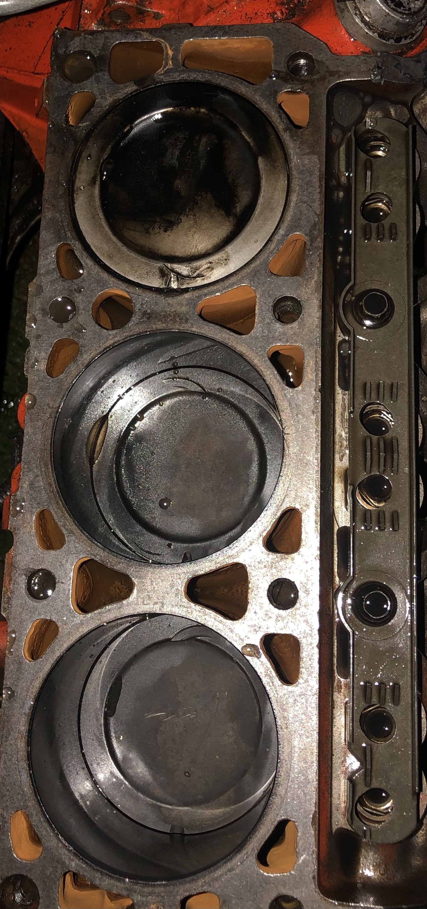

    Blow by
    Found my problem
    • 13533
    Thats pretty deep on the valve to piston contact.
    • z24 drag
      • Oct 2013
      • 47
      Yeah this bottom end is about 6 years old ,has taken a lot of abuse …it actually sheared the camshaft dowel pin when that happened….
        • 13533
        New motor time, hone/ring it, or rebuild it?
