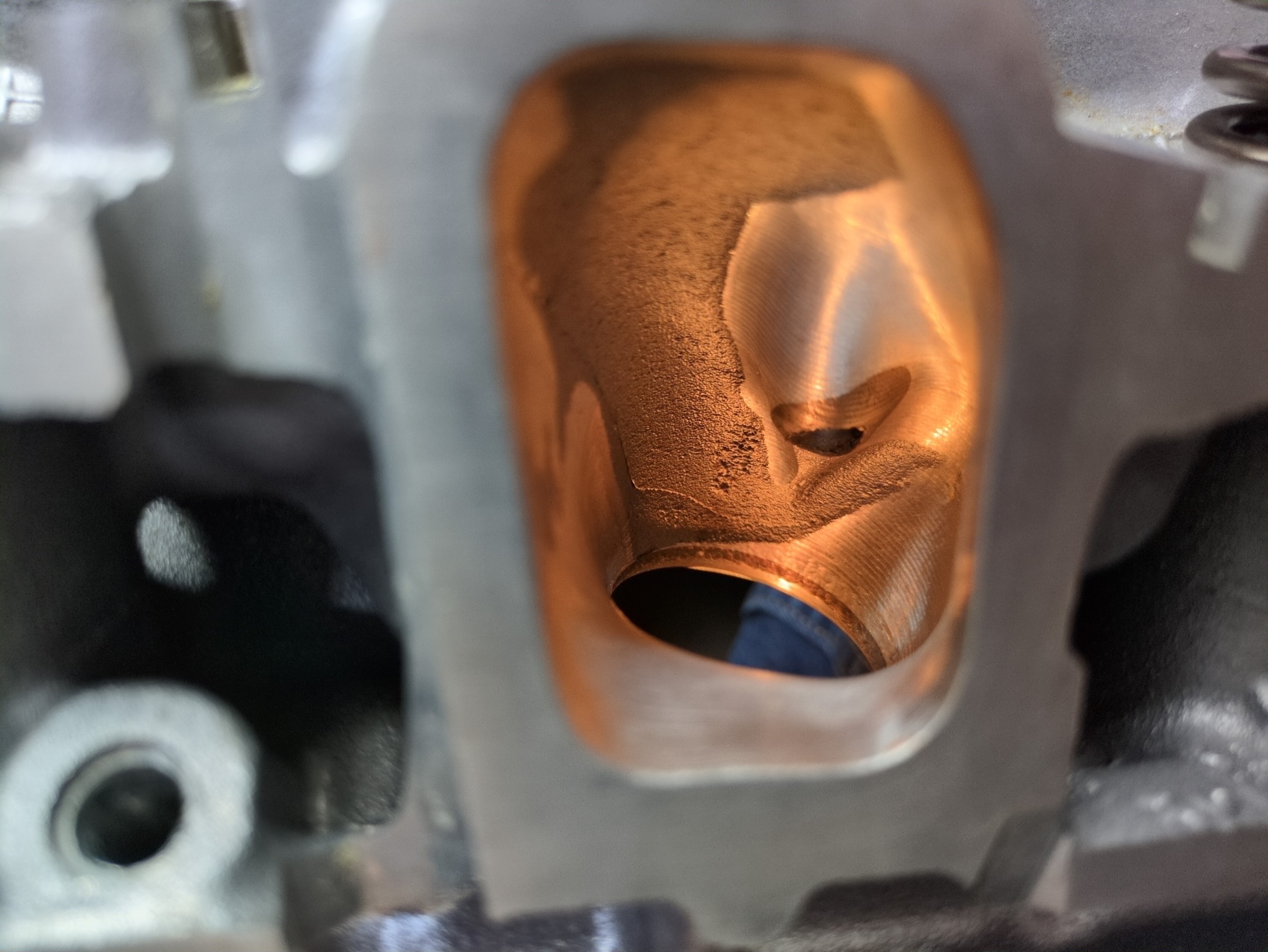

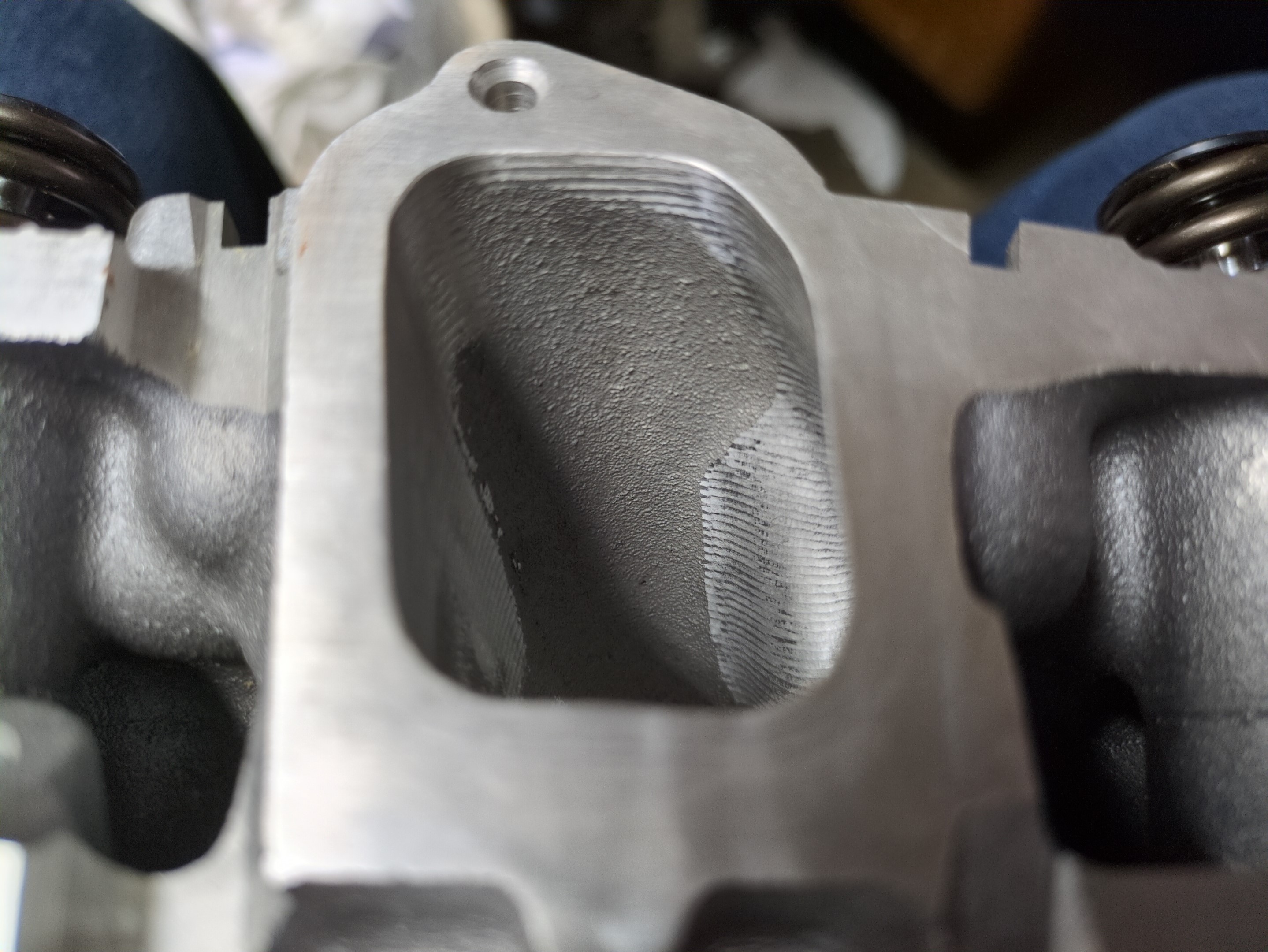

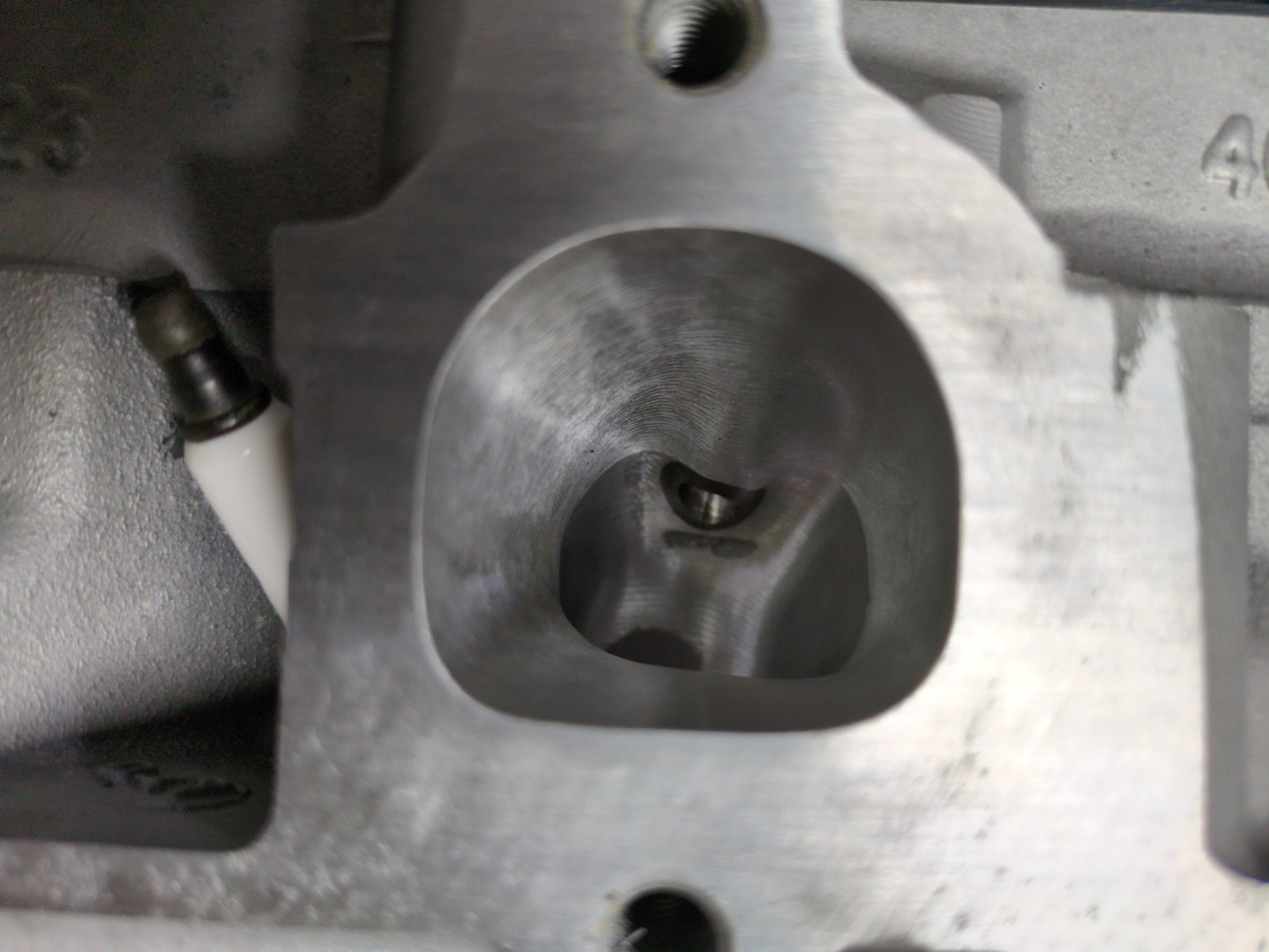

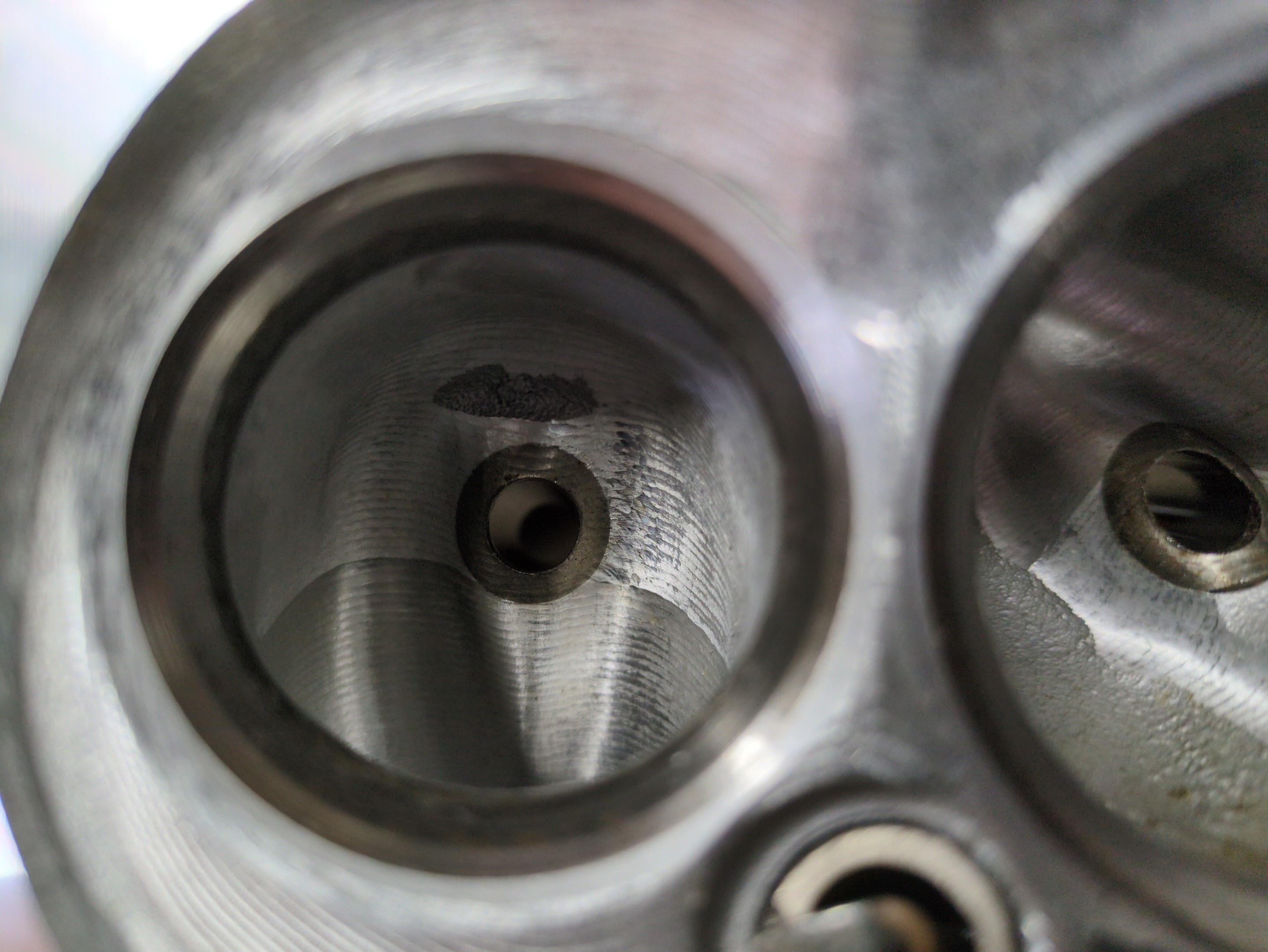

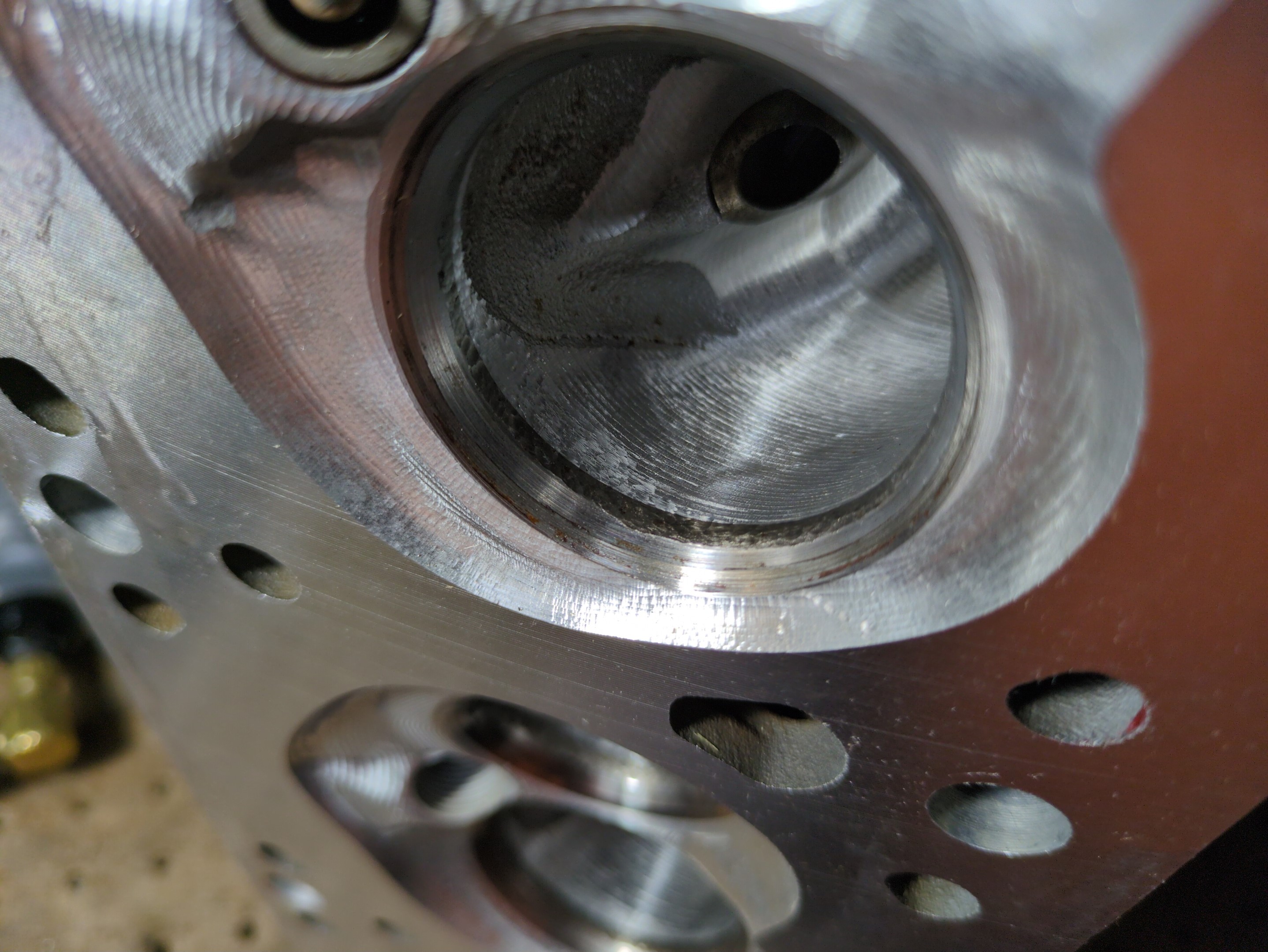

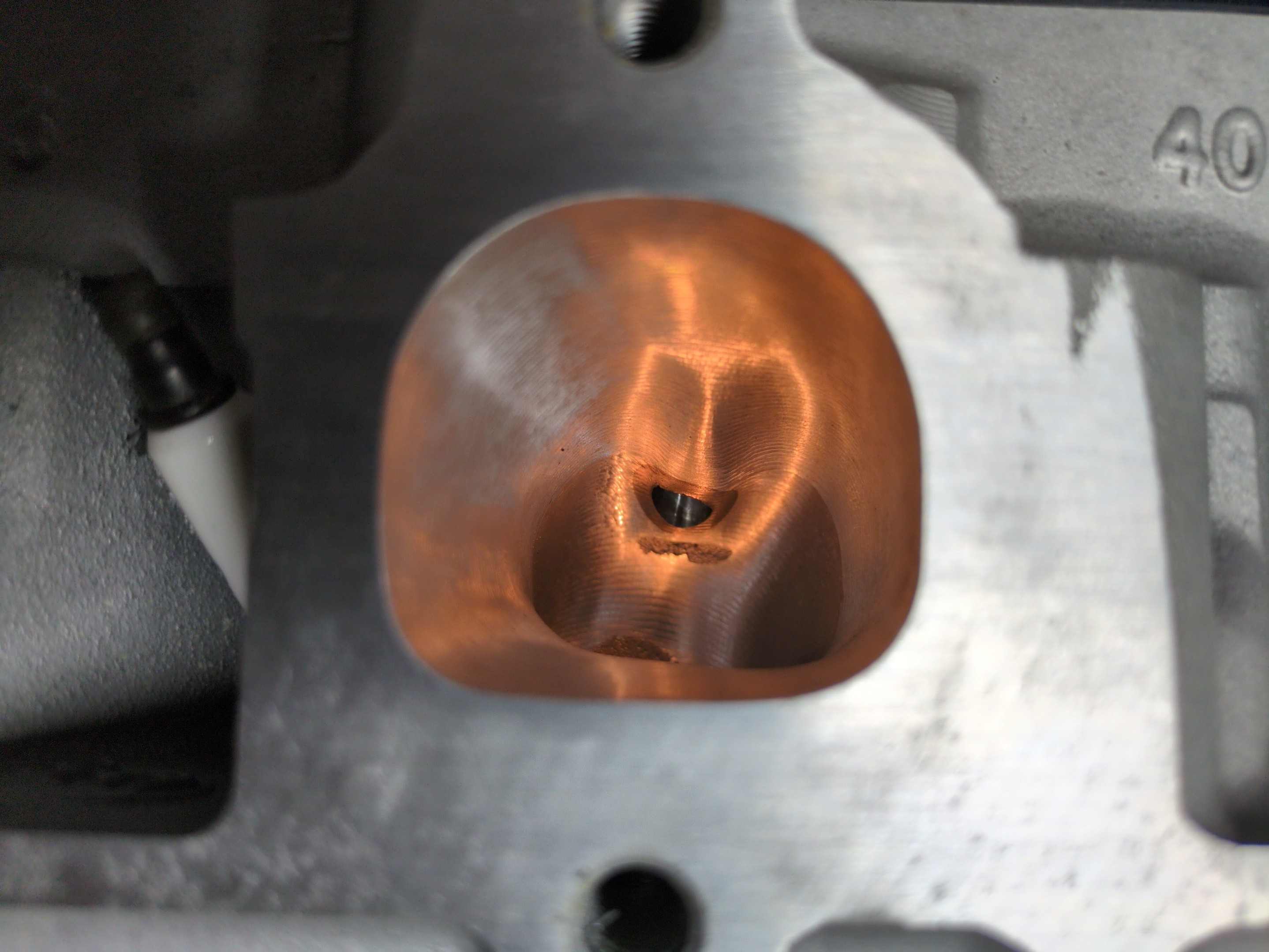

    Just starting off on checking these parts out, and seeing how they stack up to what I have been doing. The CNC ported heads are definitely CNC ported, but not much beyond that. Its what I expected, but my commentary really isn't necessary. Ill get plenty more posted so if you are interested, like and subscribe. ha ha ha ha ha ha ha ha
    First off, the picture dump of the MMS Stage 2 3500 heads.
    Click image for larger version  Name:	Combustion Chamber.jpg Views:	34 Size:	1.04 MB ID:	427399 Click image for larger version  Name:	Intake Bowl.jpg Views:	33 Size:	759.1 KB ID:	427400 Click image for larger version  Name:	Intake Port 1.jpg Views:	34 Size:	920.9 KB ID:	427401 Click image for larger version  Name:	Intake Port 2.jpg Views:	34 Size:	795.2 KB ID:	427402 Click image for larger version  Name:	Intake Port 3.jpg Views:	34 Size:	932.3 KB ID:	427403 Click image for larger version  Name:	Valve Job.jpg Views:	34 Size:	868.0 KB ID:	427404 Click image for larger version  Name:	Exhaust Bowl.jpg Views:	34 Size:	879.2 KB ID:	427398 Click image for larger version  Name:	Exhaust Port.jpg Views:	34 Size:	740.1 KB ID:	427406 Click image for larger version  Name:	Exhaust Port 2.jpg Views:	33 Size:	745.7 KB ID:	427397

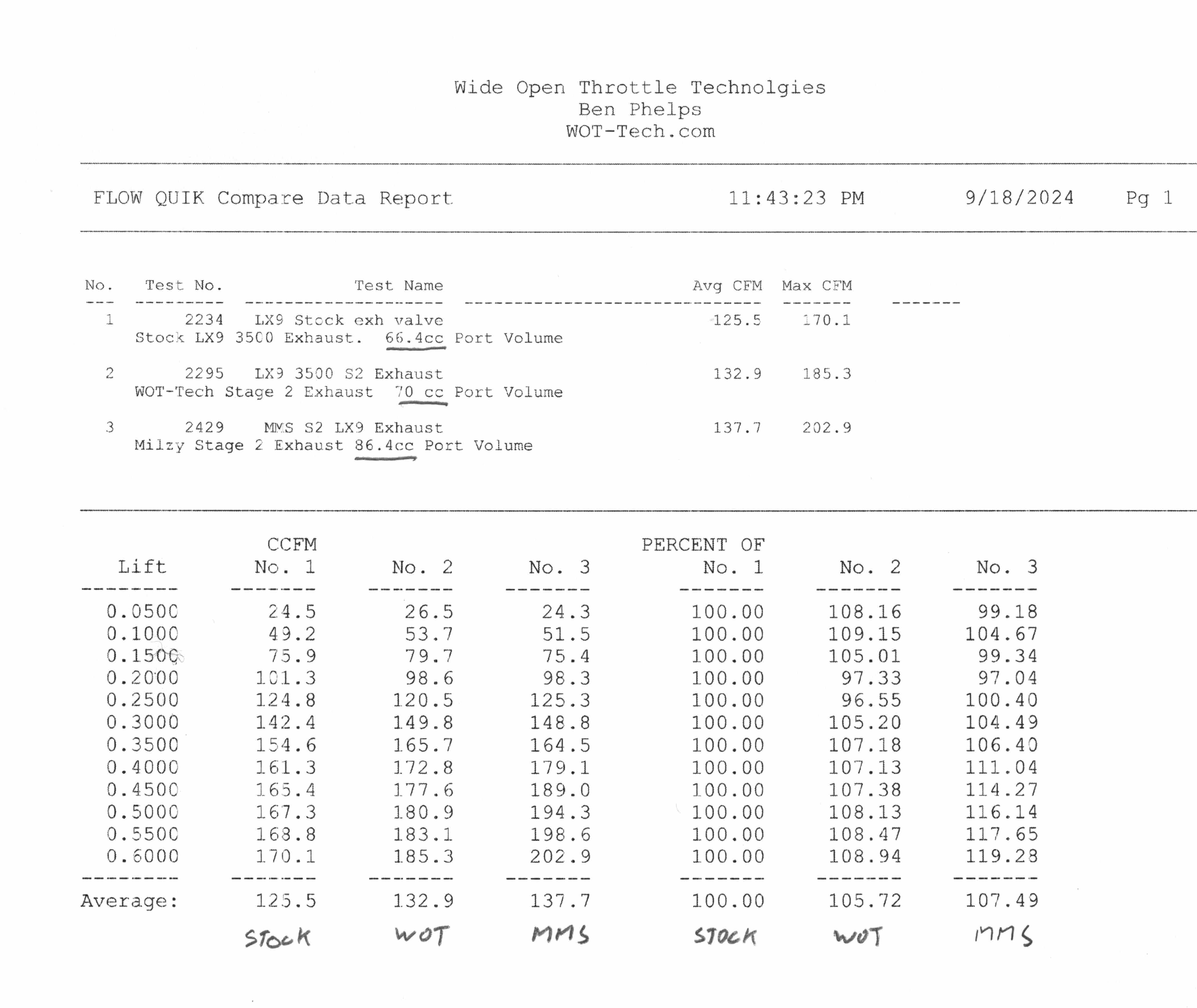

    Here are the flowsheets for stock, WOT-Tech Stage 2 and Milzy Motorsports Stage 2. Also included are the port volume measurement to give you an idea of how much was removed from each compared to stock.

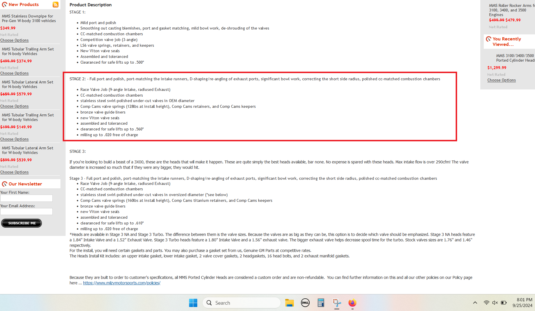

      STAGE 2: - Full port and polish, port-matching the intake runners, D-shaping/re-angling of exhaust ports, significant bowl work, correcting the short side radius, polished cc-matched combustion chambers
      • Race Valve Job (9-angle Intake, radiused Exhaust)
      • CC-matched combustion chambers
      • stainless steel swirl-polished under-cut valves in OEM diameter
      • Comp Cams valve springs (128lbs at install height), Comp Cams retainers, and Comp Cams keepers
      • bronze valve guide liners
      • new Viton valve seals
      • assembled and toleranced
      • clearanced for safe lifts up to .560"
      • milling up to .020 free of charge
      ​From a customer standpoint, we would be curious to know if all of the above was performed as stated by MMS on the heads in your possession.
      I'm currently running a set of MMS stage 2 heads on one of my vehicles. Should I be concerned that a portion of each valve guide was machined away? Have you ever tried that before? What is the advantage? In a picture from the list above (Top row, 6 over from the left) looks like the guide may have slightly shifted in its bore at some point after being machined? Could this procedure cause durability issues?
      Thanks for posting the data and pictures!
        • 13522
        I don't know what he was advertising them as when you got them, so I can't say for sure that you did or didn't get what you paid for. There aren't 9 angles on this intake valve and the valve itself wasn't even back cut. Undercut would be the stem, and thats a non issue since they are machined valves, not stock replacement versions that still have casting on the back side. CC matched chambers, probably. They are CNC done and touch most of the chamber. Its manley retainers, stock keepers as far as I can tell. That or Comp changed to the manley design. Comp doesn't used machined locks that I can remember so telling the difference between stock and comp locks would be difficult. Bronze liners? since when. These aren't, thats for sure and I don't recall them ever being listed as such. New viton seals, which are all you can really get these days. They are Felpro/stock style seat/seals.
        Oh I skipped the top. Full port, no. Polished, no. Port matching intake runners, yes, its bigger than the intake gasket by a little bit but it doesn't hurt flow. D shaping? It was a D already. Re angled I guess....its totally hogged out. 20cc or something like that on the exhaust. Correcting the short side radius, he does change the short side radius. Is that corrected? Not a polished combustion chamber.
        So that is comparing the description now to 2019 work. If your car has older MMS work, then its probably different heads. They were hand ported by high school kids in 2008. The set of heads and manifolds I had back then didn't look anything like what these cnc heads are.
        Cutting the guides out of the ports like these aren't may or may not cause the guides to wear faster, but it 100% didn't help flow.

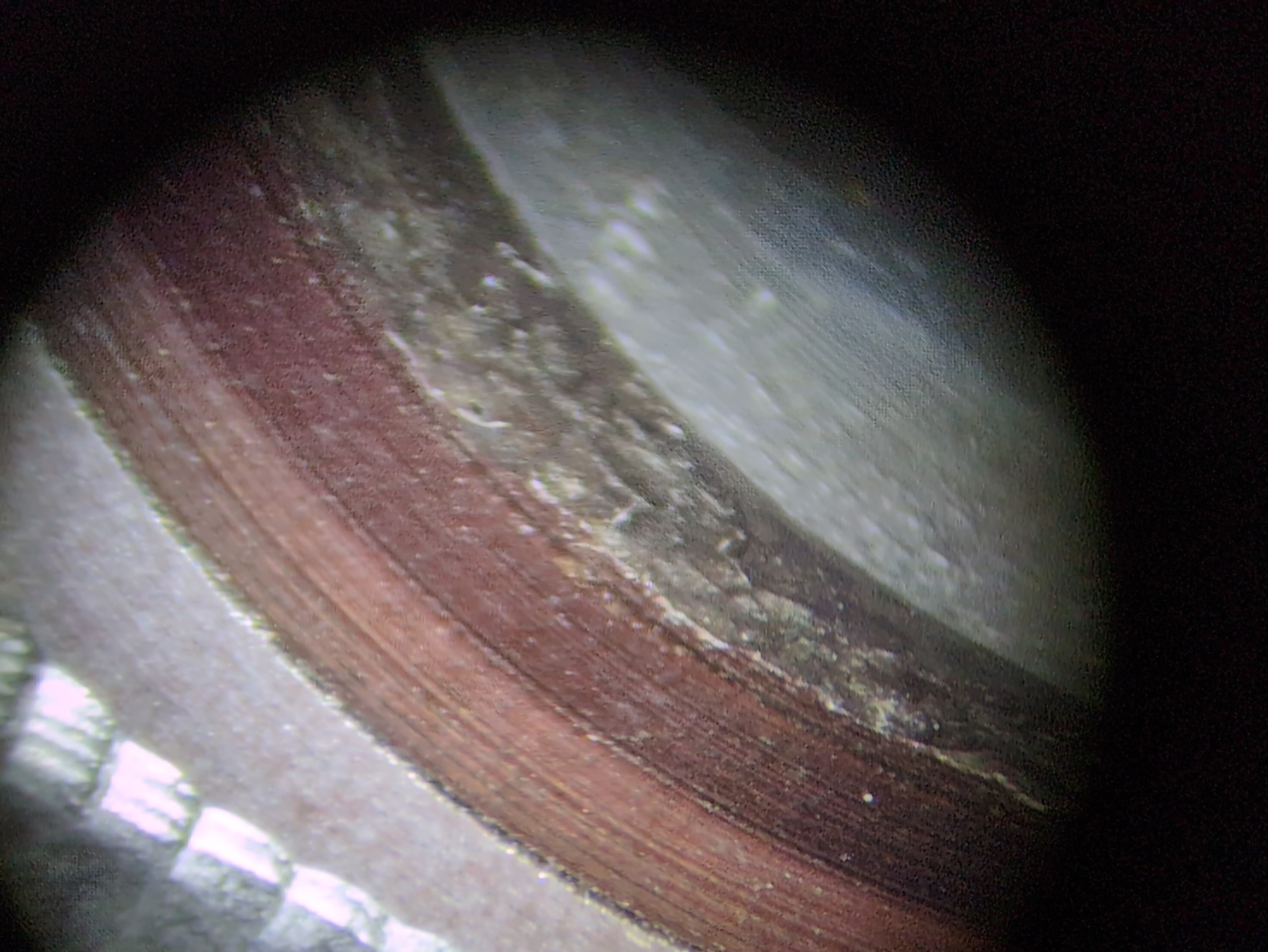

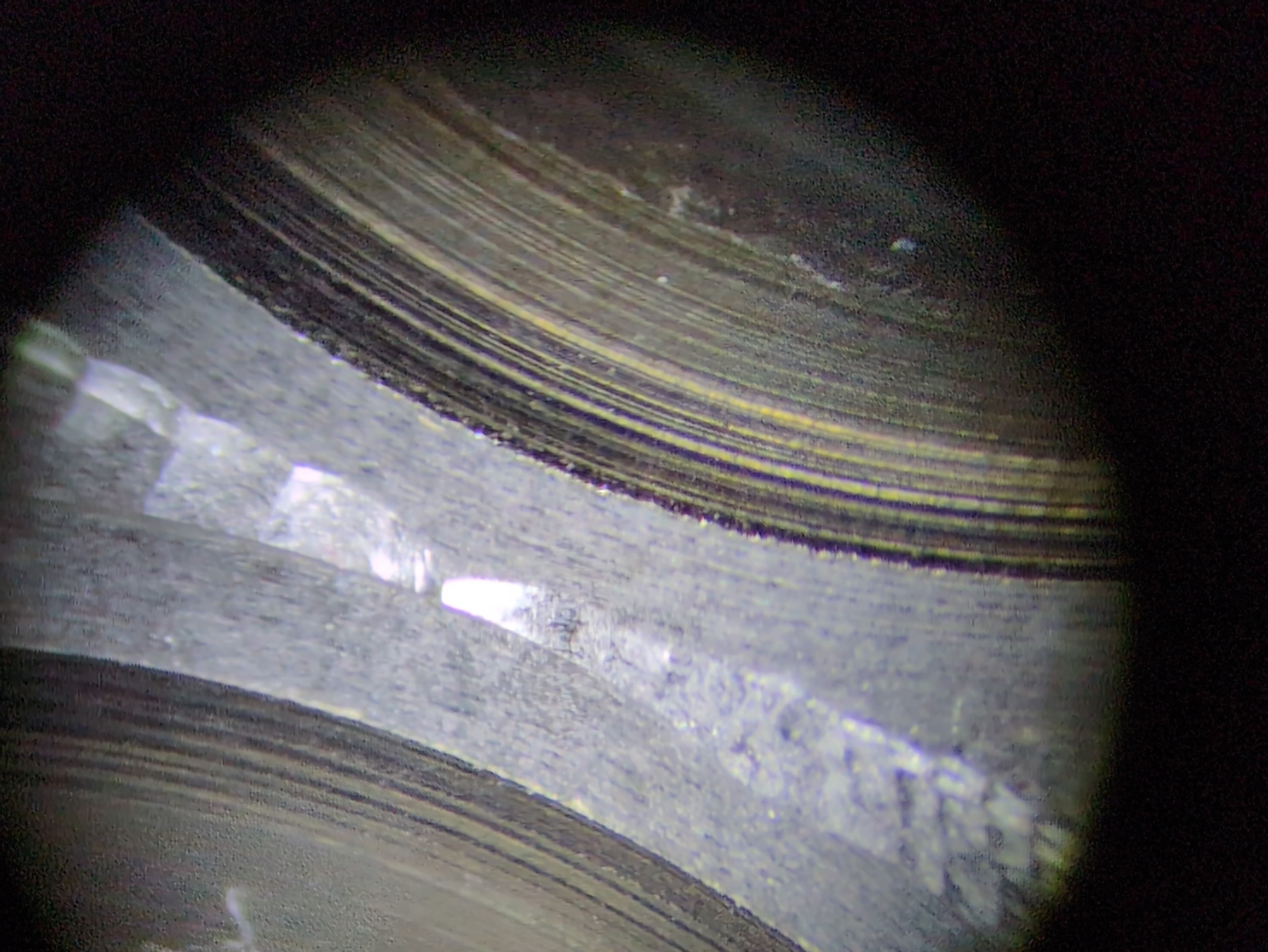

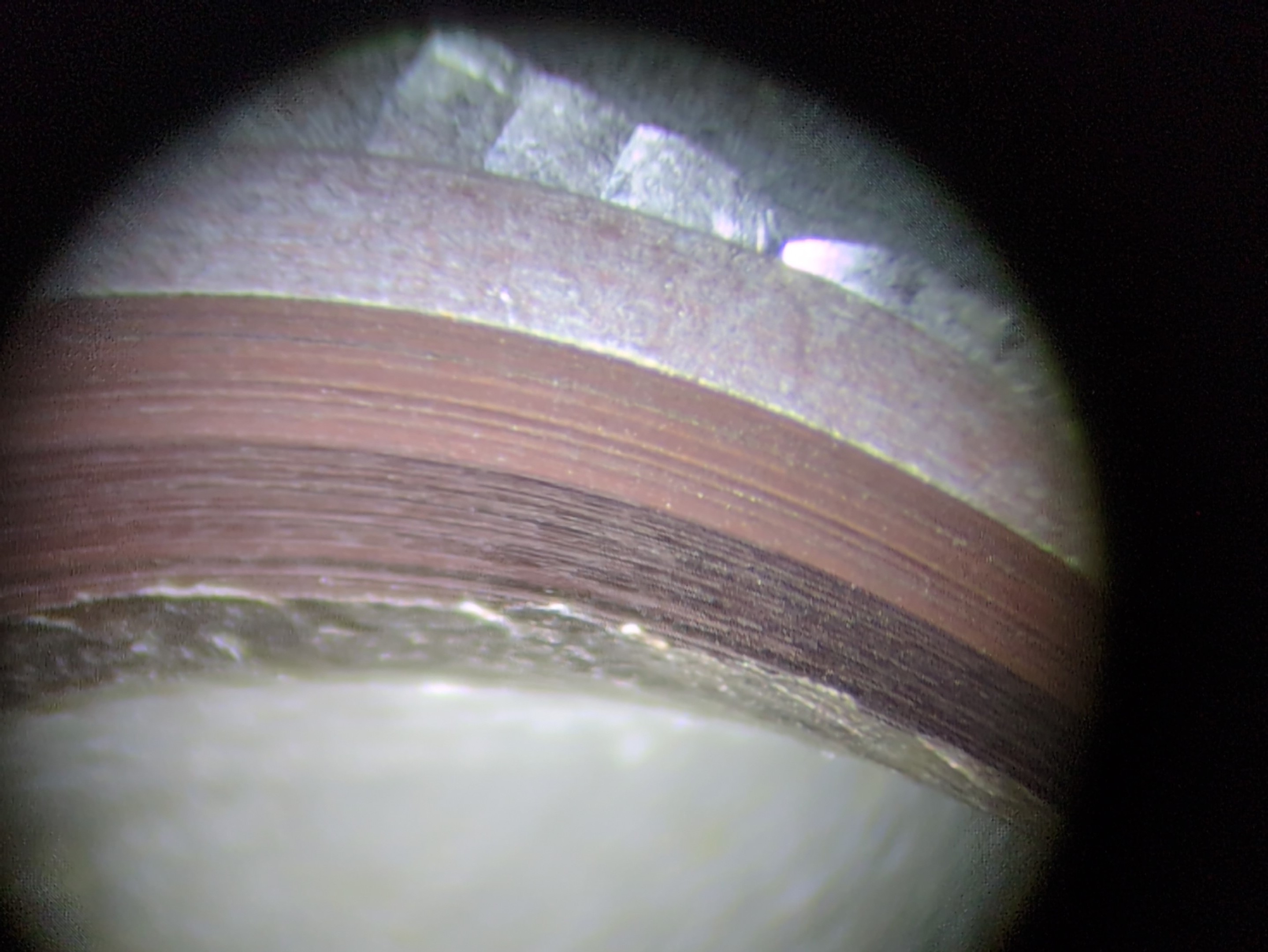

          • 13522
          I do know he has had the 9 angle valve job listed for over a decade now. These heads got a 3 angle valve job. I also got the little spike that is dead center between both valves.
          Between the valves
          Exhaust Seat
          Intake Seat
          The seats are silver, which is impossible to discern angles from. Using the reflection of my finger, you can see it a lot better.

            The Stage 2 description on the website has not changed to my knowledge since late 2017. Interesting pics. Looks a little rough but that may be normal under magnification? Did all of the valves seal on their seats? Do you notice anything concerning?
              • 13522
              They all sealed. I don't recall him listing the bronze guide liners, but these heads don't have them. The manifolds are fully ported, the heads are not. I am very concerned about the sharp edges in the combustion chamber. They can create a hot spot and pre-ignition/detonation. We will find out on the dyno how much it matters. Both intake and exhaust appear to be the same valve job, and 3 angle.

                Click image for larger version  Name:	stage 2 - Copy - Copy.png Views:	0 Size:	228.4 KB ID:	427440
                Off subject, but if you look at the stage 3 description it is listed as "Max intake flow is over 290 cfm". What kind of modifications does it take to hit this number? Would increasing the intake valve dia. 0.08" alone be enough or is there more work needed? What lift is usually considered max intake flow?

                  I have never seen 260 cfm on these heads. 290 would outflow LS1 and LZ9 heads. Max intake flow is whatever you want to call it. I think it was RSM that gave the flow of all 3 intake cylinders on the head open to .500". Yes, all 3 open at the same time. So its marketing bullshit at best. Bare none in fact. ROFL. The massive port sizes are probably to blame for the torque loss and lope. The cam shouldn't be that kind of powerband.

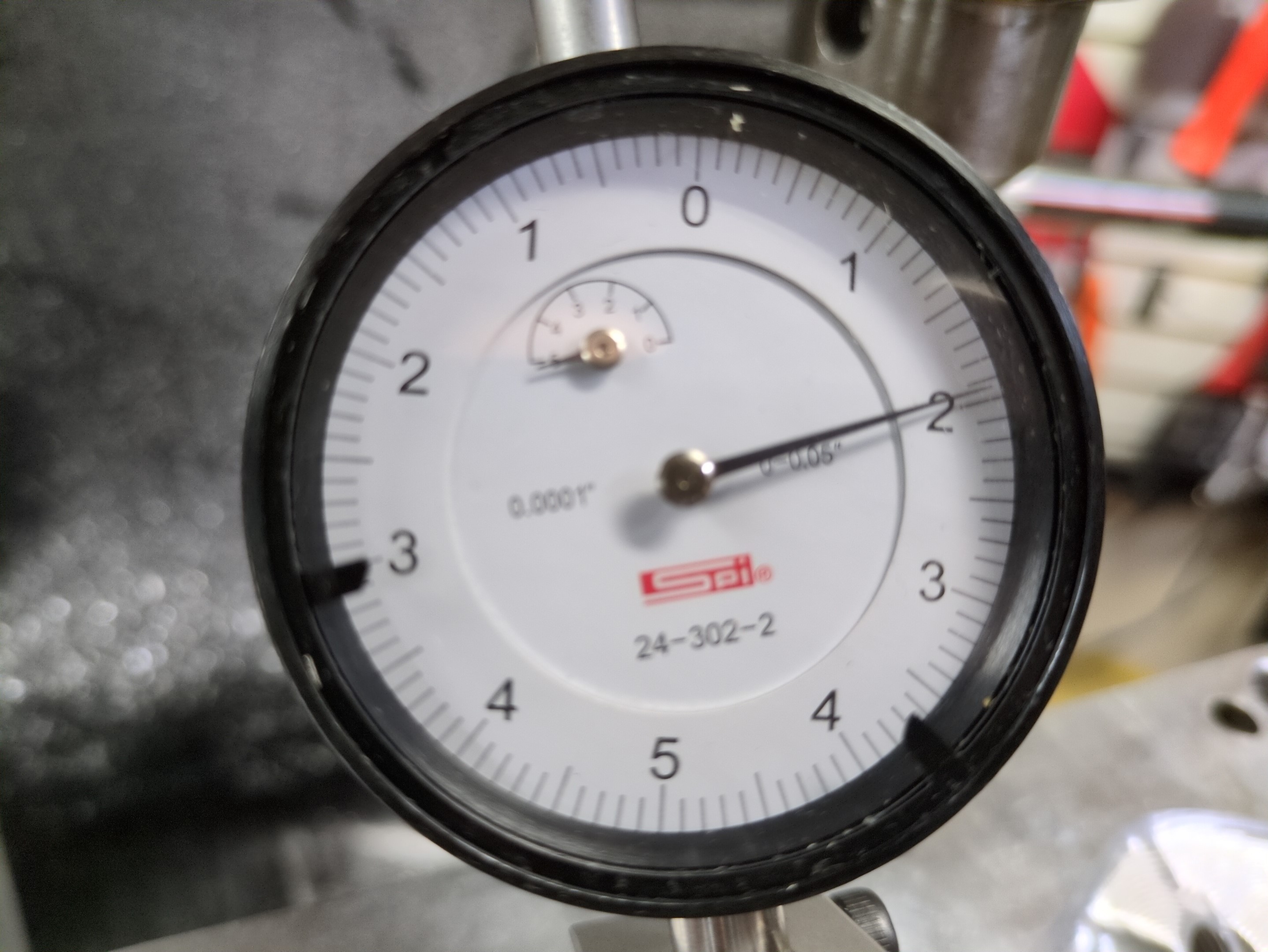

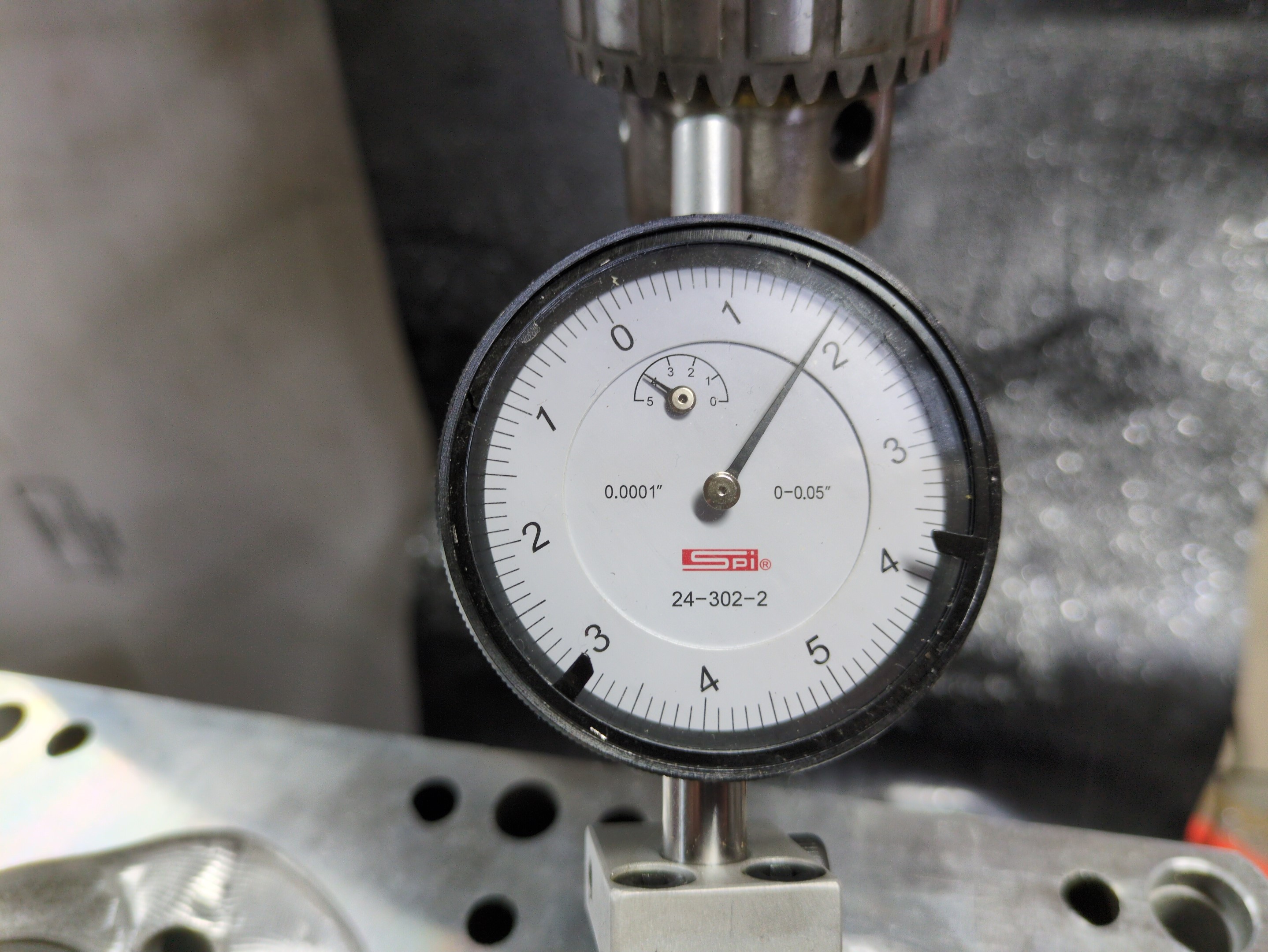

                      Measured the seat concentricity, and its fine. Intake is better than exhaust but both are better than I have seen from some machine shops before.
                      Intake
                      Exhaust

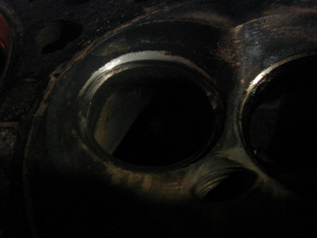

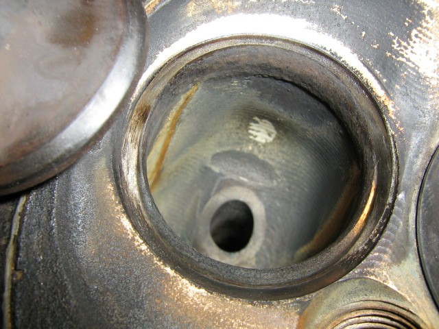

ID:	427712Exhaust valve and seat MMS stage 2 cylinder head. 40k miles approx. Bummer
                          • 13522
                          Are they all like that or starting to do that? Its hard to tell from the pic but is the valve cutting into the seat?
                          • dbral
                            • Feb 2021
                            • 38
                            Yeah Ben, all exhaust valves/seats are showing this along with a crazy amount of stem to guide clearance. Looks like the valve head might be contacting beyond the seat onto the combustion chamber roof on a few of them. (photos) Looks like the valves are cutting into the seats too. Maybe due to the rocking back and forth of the valve because of the guide play? Able to move some of the worst ones more than 1/4" in one direction, lol. What do you think root cause might be? Is the cam too aggressive maybe? Are the stem/guide clearances in spec on the MMS heads you have?
                            Been fighting an intermittent drivabillity issue/noise/vibration with this car and i am hoping this might fix some or all of it. It always had a rough idle but assumed it was normal for the cam that was installed. The rough idle was probably not making the f40 trans bolted to it very happy either. On a bad day the trans sounded like someone was randomly hitting the inside of the case with a hammer. I believe that repairing the valve issue has to help but i have been such a dumba$$ leading up to this point that i can't say for sure anymore. Lol, i even took the trans apart looking for broken stuff before finding this.
                              • 13522
                              Wow, thats a lot of wear for an iron guide. The mms heads I have here don't have that kind of wear. Id have definitely called that nonsense out. Looks like something is causing the rocker to push the valve sideways and it isn't the cam specs. It probably needs new seats and guides but I wouldn't do it to those heads. Stock heads will perform better.
