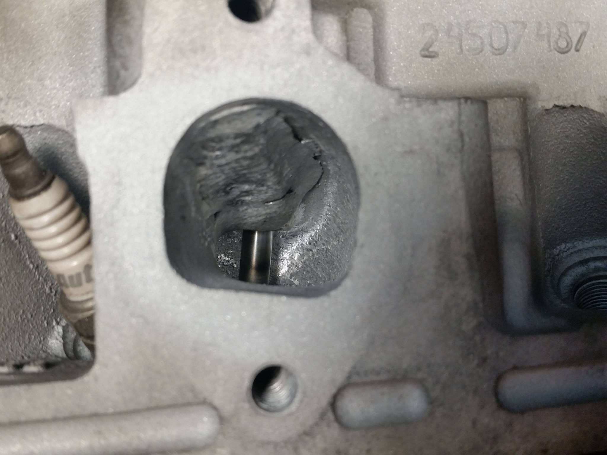

    I sold the set of heads I did like this and the customer made 260 whp so I guess it didn't kill anything. Want to do it again for an A-B test but I think this is a decent comparison to what GM did to the LX9 3500 exhaust ports.

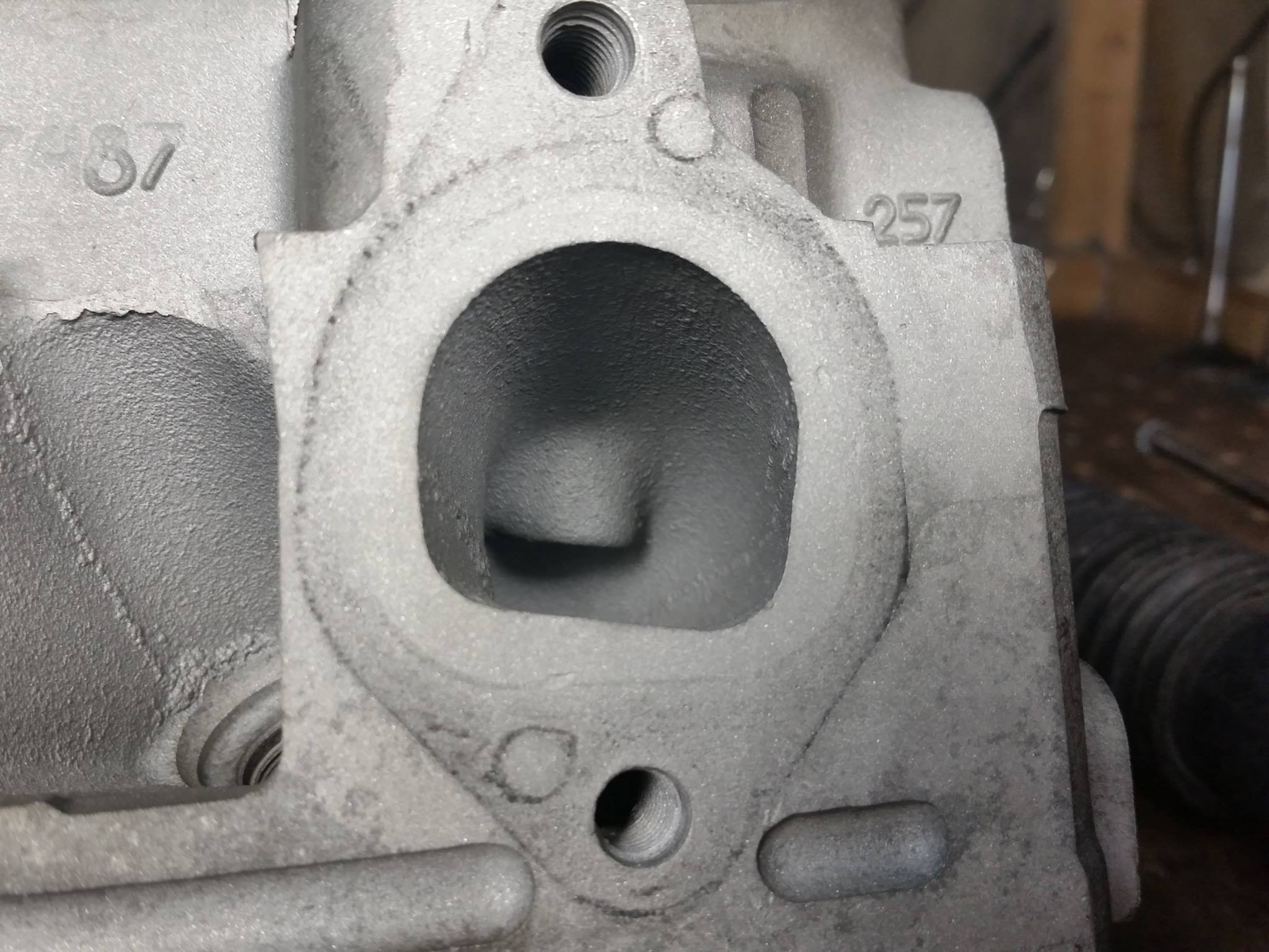

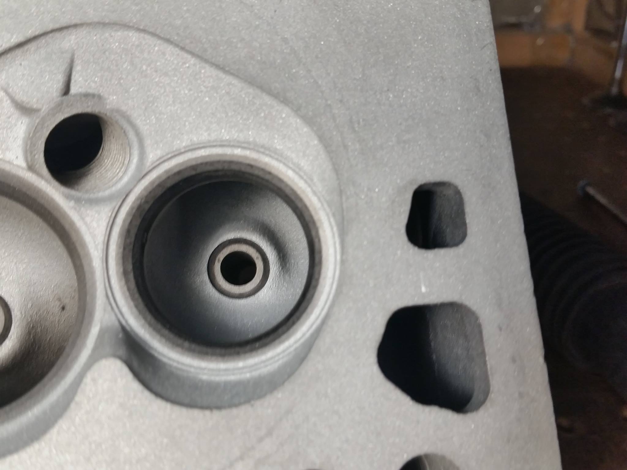

    First, Stock 3400 exhaust.
    Click image for larger version  Name:	Start1.jpg Views:	0 Size:	440.3 KB ID:	427450 Click image for larger version  Name:	Start2.jpg Views:	0 Size:	244.9 KB ID:	427448

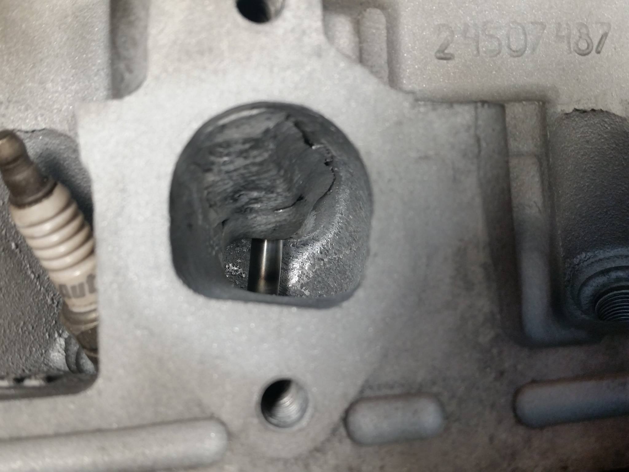

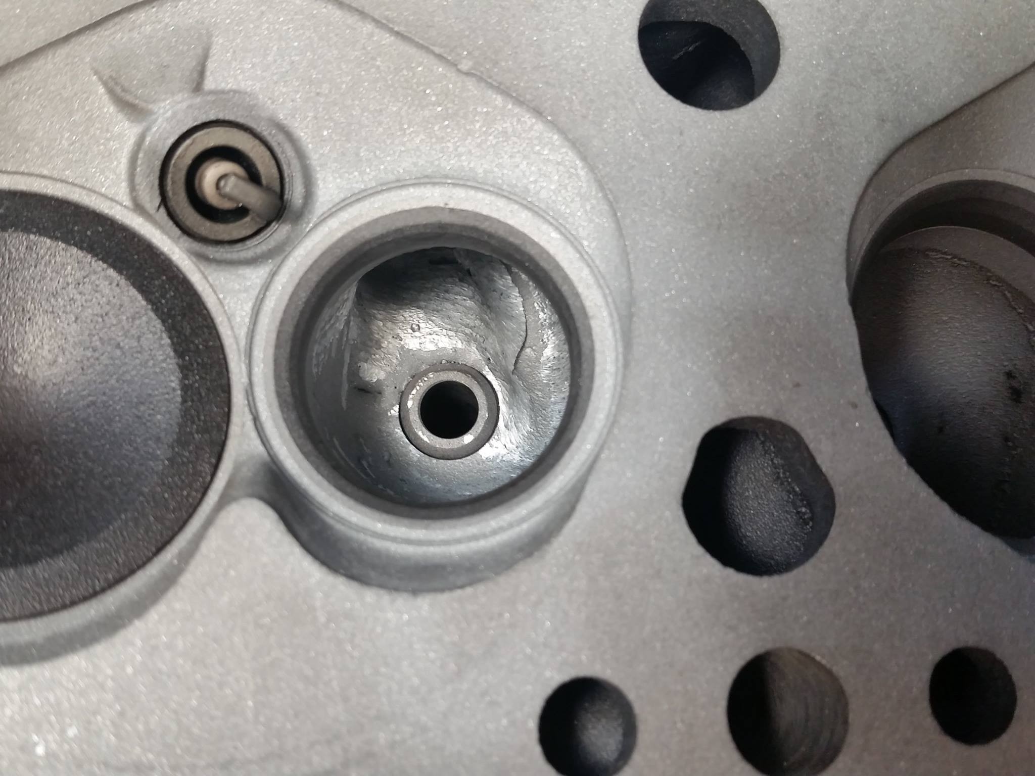

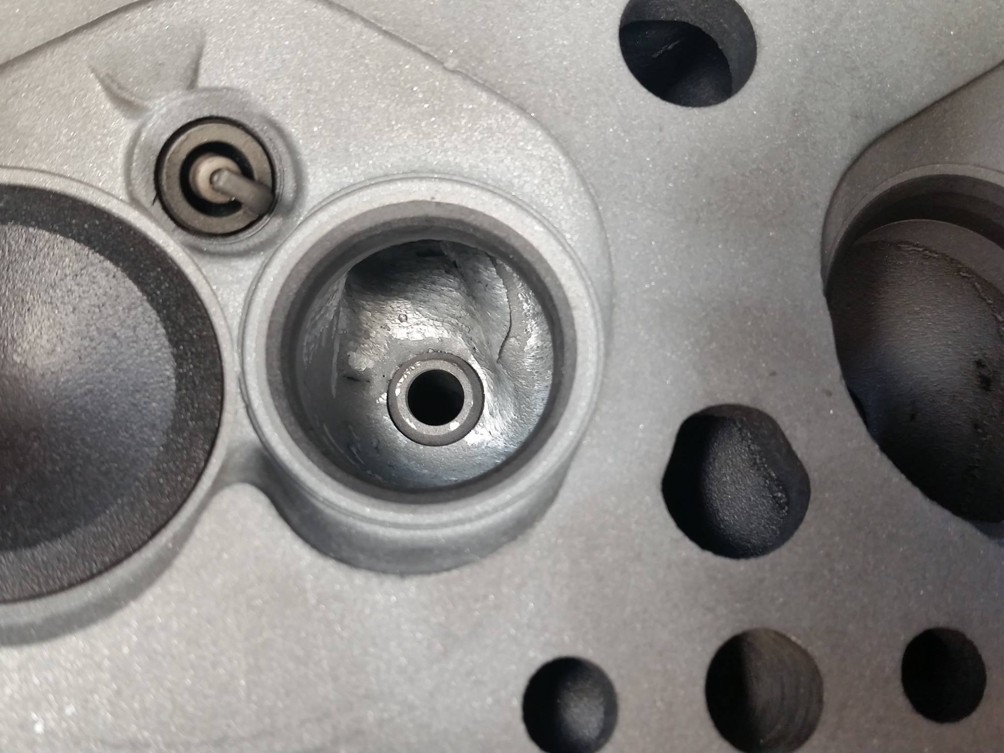

    Welded and cleaned up with a grinder.
    Click image for larger version  Name:	Welded1.jpg Views:	0 Size:	264.0 KB ID:	427447 Click image for larger version  Name:	Welded2.jpg Views:	0 Size:	341.5 KB ID:	427449

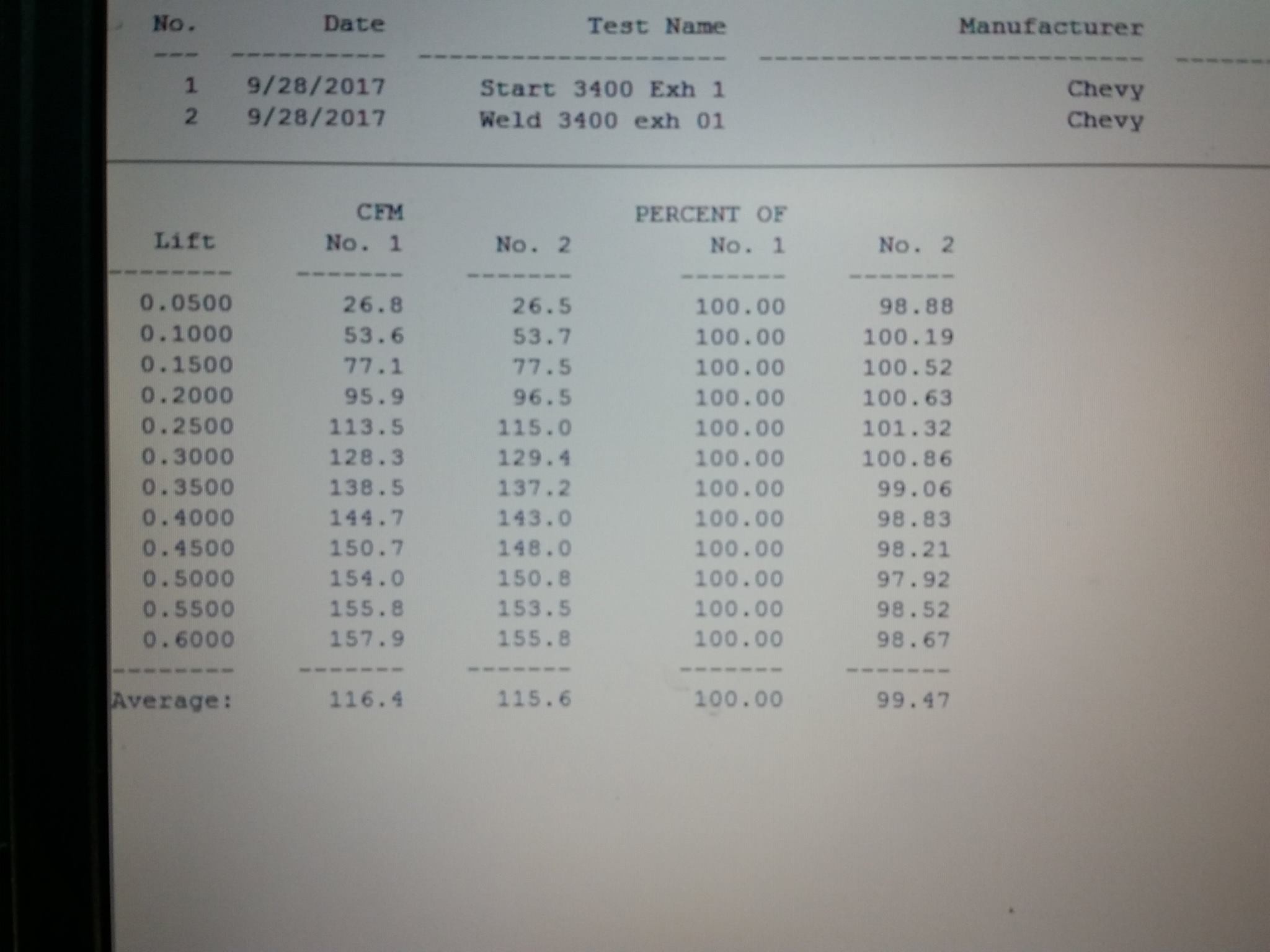

    And the results
    Click image for larger version  Name:	Flow.jpg Views:	0 Size:	208.4 KB ID:	427446
