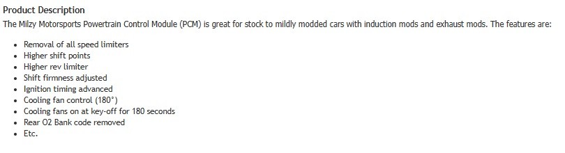

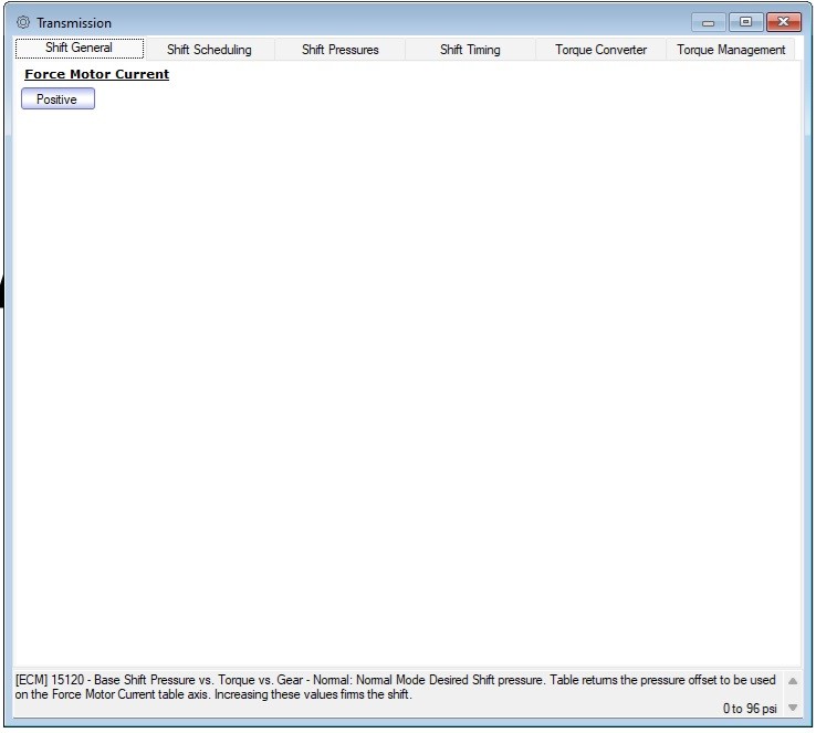

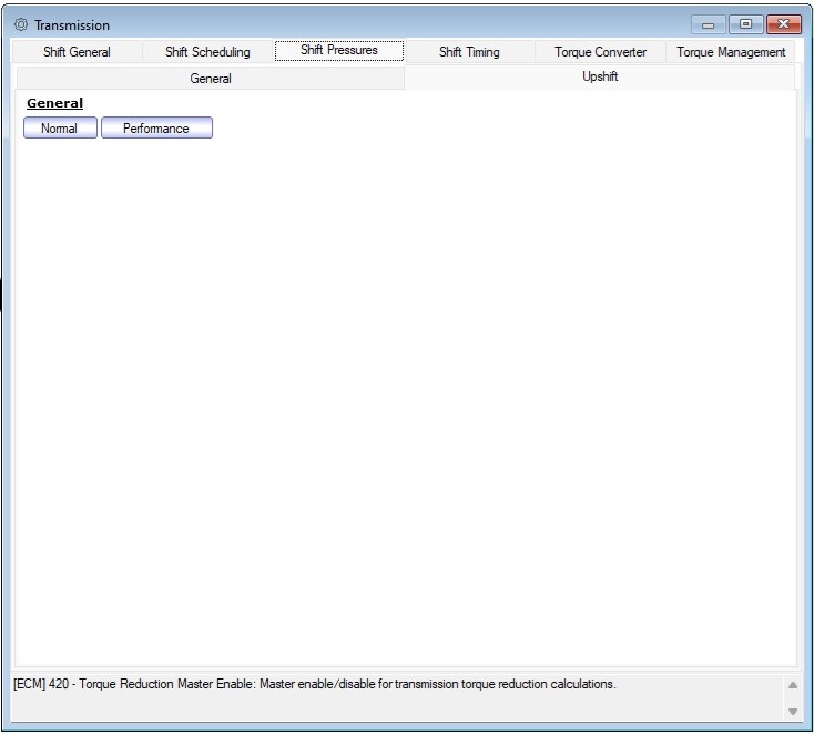

    This is how its advertised. The only thing that is claimed to be done that isn't, is the shift firmness. No changes were made to the transmission that would impact the firmness of each shift.

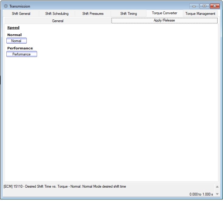

    While not mentioned, it is hard for me to believe the TCC hunting in first gear wasn't addressed either. Its a simple fix in the tune and I thought it was common knowledge for tuners but I guess im wrong.

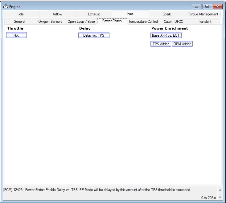

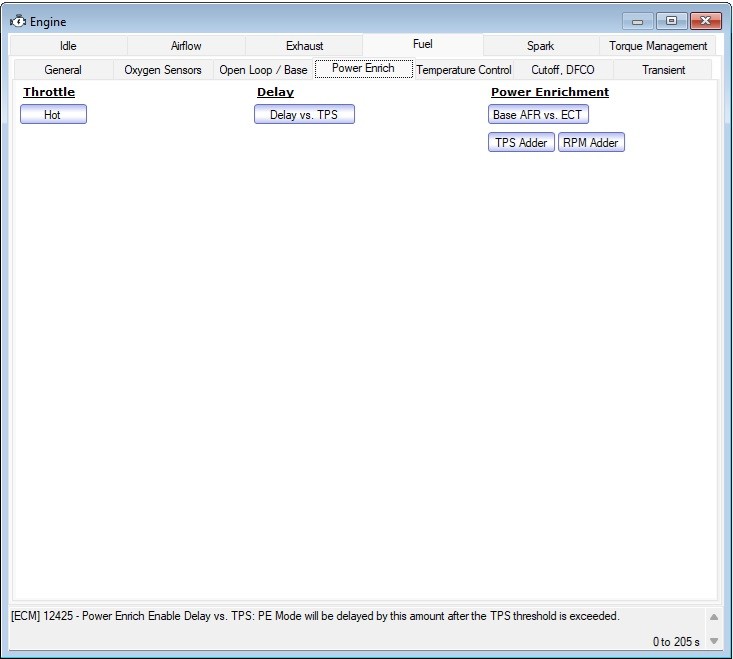

    The real kick in the nuts for me is that there are no fueling changes for power enrichment. I have yet to tune any car that was optimal on the stock fueling for wide open throttle. Not only are there no changes to fueling, but the delay before extra fuel is added is also stock. Thats a pretty big problem for a 65mm TB that you might only give 70% throttle to accelerate and the engine is still being commanded stoich.

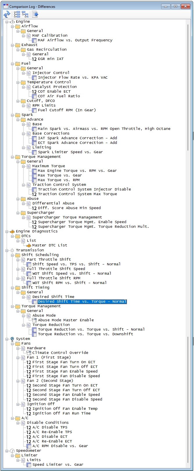

    Here is a list of all the changes they actually make.
