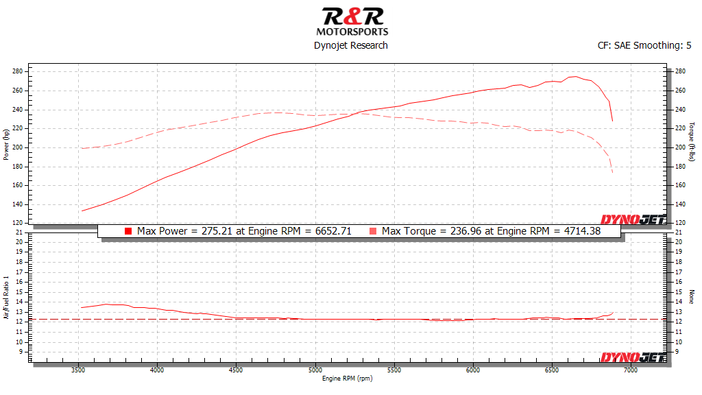

    275 whp LZ4
    WOT-Tech Big Race cam kit with bearing spacers for LZ engines, 75mm TB, Custom Headers (R&R Motorsports), WOT-Tech heads and manifolds. Thinner MLS gaskets for quench.
    Click image for larger version  Name:	LZ4_Big_Race_Cam.png Views:	9 Size:	44.2 KB ID:	427707

    What is the configuration of the dyno? Inertia? Water brake? Electric brake? Chassis dyno? Engine dyno?
      • 13525
      Dynojet electric brake chassis dyno.
