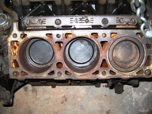

        this is the condition of one side and i started to clean it up a little
          • 13499
          So you have 3500 to get the car running or that is what he is wasting his money on with this taurus (unless its an SHO).
          Get a new motor. They are dirt cheap and already in 1 piece. 3400s drop right in for the most part. Especially if you get a 97 though id get a low milage one from a newer vehicle. I am sure you can find one in atlanta. car-part.com. You will want the large port intake setup off a 3400 or 2000+ 3100. Your stocker in the 97 is a small port/smaller intake valve version.
