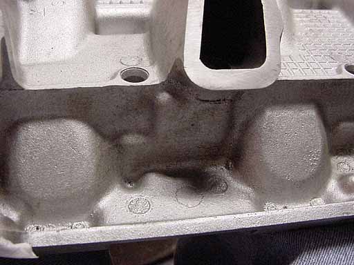

    Can anyone tell me if this 3400 LIM looks different than most?
    It seems as though it's got more space for rocker to clear. No it's not machined like the 2000+ style, it's cast different. It looks flat compared to most others that look round buldging there.
    Is this just my eyes playing tricks on me and every other 3400 looks cast like this? Or is it safe to say I may not need to grind much on this?
    There isn't but maybe 1/8" of material where I'd be grinding. And pictures from other people (3100_modified) shows where they ground down really deep. I don't have that much material to go that deep! So I'm thinking this is a different cast shape.
    In the picture I've only scratched a little and not taken much material off yet.

    I think they're all like that (the big port ones) I don't know why some are "shaved" by the factory, and some aren't (like yours)

      That is how they look if they aren't machined a little from GM.

        Hmm, ok. It looked like mine were flat, and others seemed more round and bulging. Like Brad's I ground on them some tonight anyways. I had more to work with than I thought. About a 1/4" and it took it down almost 1/8" or so.
