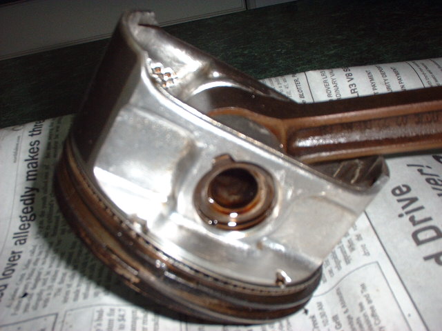

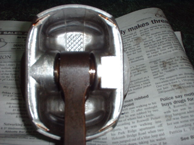

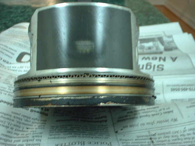

I mentioned in another thread the possibility that the forged floating pistons from the 3.6 DOHC engine might possibly work in the 3500 since the 1.3 mm larger stroke and the 10.2:1 compression could mean they didn't change the piston pin location causing the higher compression, anyway I acquired a burnt 3900 today for a good price and on breaking it down discovered that it has floating MAHL pistons like the 3.6L although I don't know if the pistons for the 3.6L are made by the same company.

Originally posted by Joseph Upson View PostI mentioned in another thread the possibility that the forged floating pistons from the 3.6 DOHC engine......
...discovered that it has floating MAHL pistons like the 3.6L although I don't know if the pistons for the 3.6L are made by the same company.
The 3.6 pistons are made by Mahle, but they are cast, not forged as the GM literature states. The pictures of the 3900 pistons look to be cast as well.'99 Z-28 - Weekend Driver

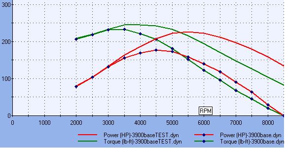

Below are 2 screen shots, one with the VVT cam at 0deg compared to -15deg, and a single graph of the stock engine on 7psi, with 72% turbo efficiency and 80% intercooler efficiency because I'll be using both an intercooler and water/meth injection.
Note in the comparative graph how close the peak power and torque output is to the 3900s actual rating. I'm using 3500 head flow numbers and that probably has a lot to do with why the HP is down.

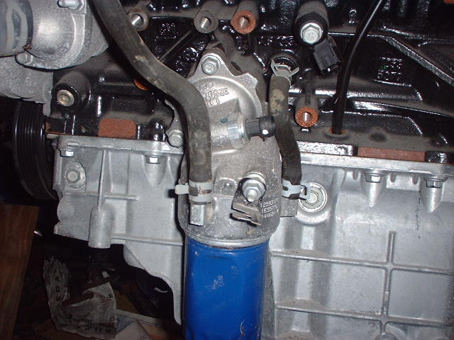

I was wondering why no one mentioned it before but realized it was because probably everyone that has a 3900 for a swap has one from a car like my first 3.9. I noted on the Uplander engine I picked up yesterday two hoses going to the oil filter base which turns out is a sandwhich style oil cooler that uses the radiator fluid to keep cool.
