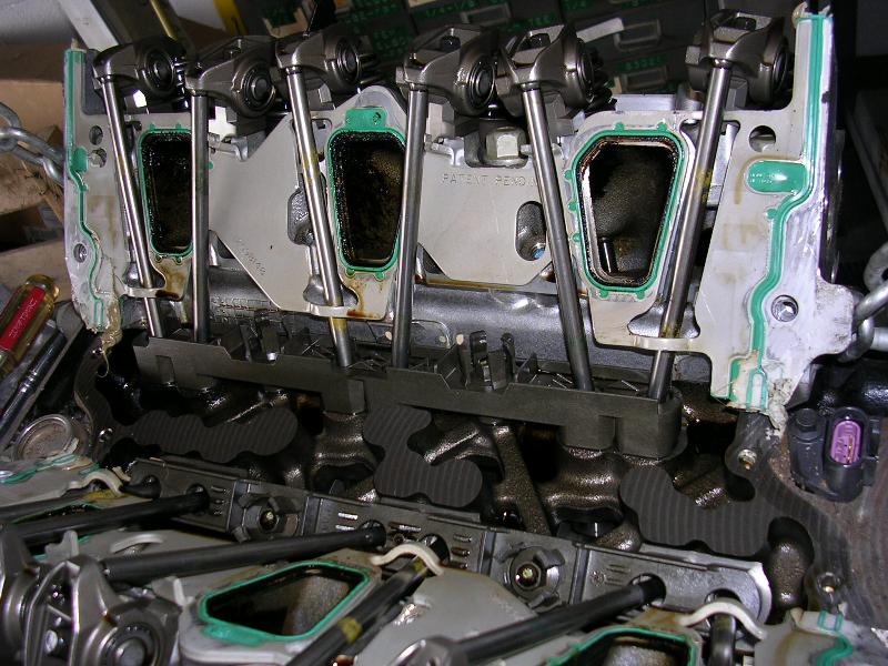

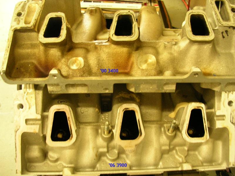

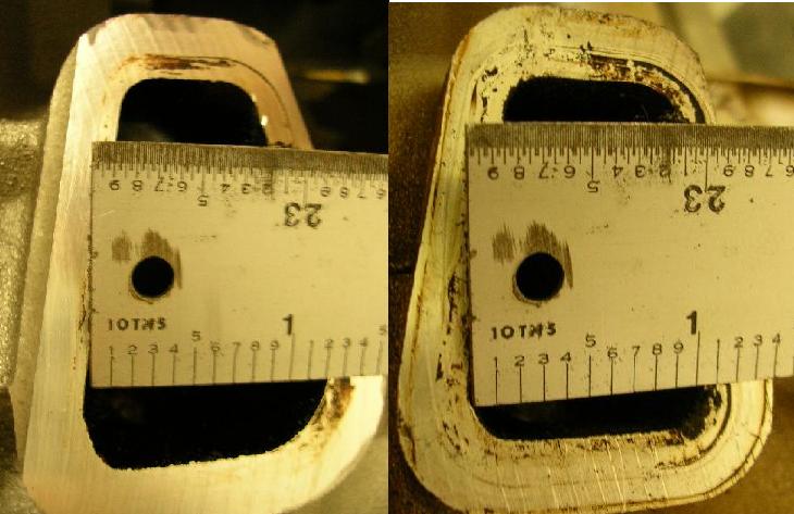

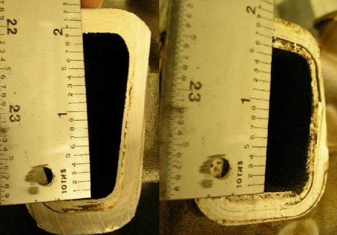

        I could be wrong... but this thing has some pretty big ports for a 60V6. Here are some pics comparing the '06 3900 intake ports to an '00 3400 LIM. The ports are almost 3/8" taller and 1/8" wider. Makes sense why they made the rocker pedestals shorter. They raised the runner roof considerably.

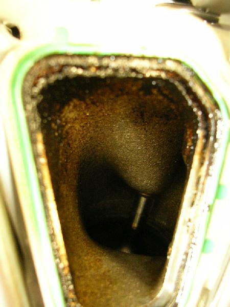

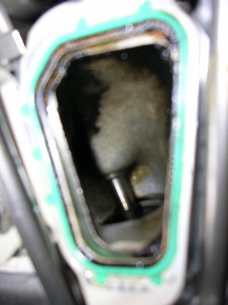

        Anyone have any thoughts on what the nasty black stuff is inside the runners. It looks alot like oil and crud from an EGR but this engine has no EGR. Any possibility that it would be from the VVT, exhaust coming back up???? Thoughts?
        Also, note that there are no coolant passages to the intake.

          Yeah, its probably the VVT doing the EGRs work. Tall is good Ill bring a head with me and a lower intake as well to see how it matches up width wise.

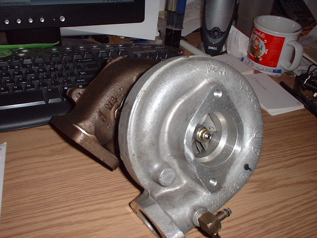

                              I originally planned on using the 3500 but I have a few 3900s near by getting closer to my price range. I was planning to use two .60 compressor .48 turbine housing T3s and look at what I found for $25 at a core shop, complete and brand spanking new, I took the wastegate actuator and tail end off to find out why it was seized, turned out there was a piece of cleaning brush lodged against the turbine wheel so someone thought it was no good, my blessing, now all I have to do is refresh the one I already had. This ones .60 cold .63 hot, very popular for the early ford and chrysler cars
