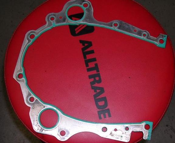

    LIM, UIM, TC cover, coolant return and water pump use metal gaskets with molded rubber inserts. They look like they will be expensive to replace, who knows.

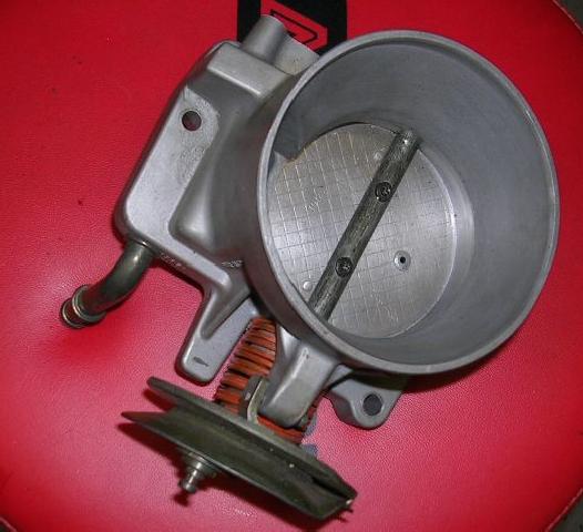

    The 3900 uses a 70mm electronic TB and the UIM will accept a 76mm without porting. I am going to make an adapter to mount a 75mm TB from a 5.3.

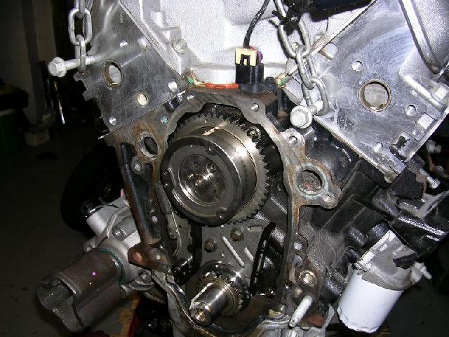

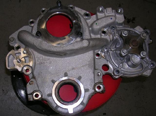

    The camshaft has a hub that extends about 3/4" from the face of the block. It is used for the VVT feature and will not allow the old style TC gear & cover to fit. I have not removed the cam yet to see if an old style cam can be used. Also, a chain tensioner is used instead of a guide.
    All of the TC cover bolts are M8 instead of having (5) M8, (2) M10 and (3) M12 bolts on previous models. One of the three bolt holes on the front of the block that were used to mount the engine was eliminated. The 3900 only has one hole on each side of crank.

            Ben... the 5.3 TB uses a cable.

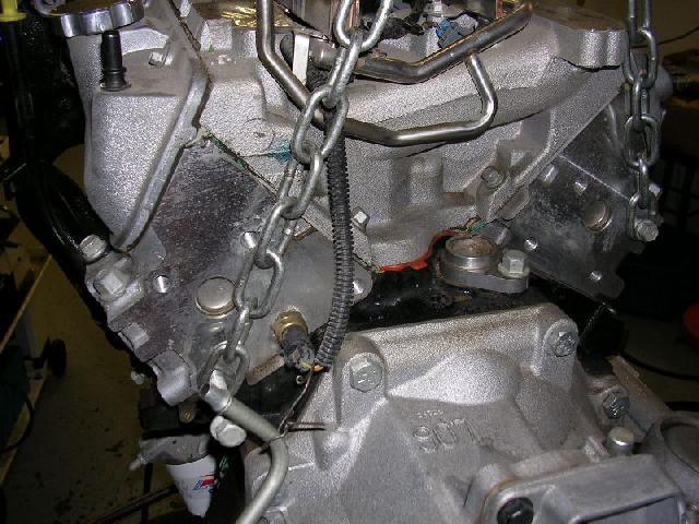

            Here are some pics of the 3900.
            Front of engine - notice coolant return holes and extra mounting holes in end of heads - one hole missing for lower mount on some models.

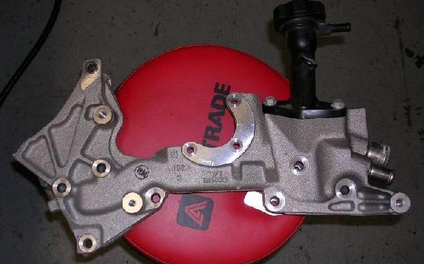

            Coolant return system - also mounts PS pump and alternator

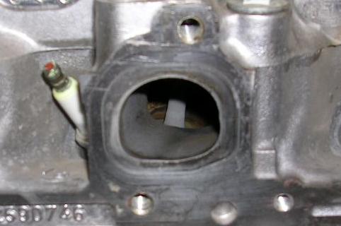

            Exhaust port and staggered bolt pattern

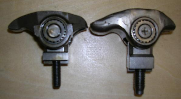

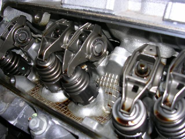

            Rocker arms
            Timing chain cover
            Typical gasket constuction - looks expensive

              There has been speculations before that the 3900 rocker arms will not fit the previous gen 3X00 engines.
              Now that the engine is here, do you have any idea if they will bolt to the 3100,3400, and 3500 engines? Also anyone hear what ratio they are?
                Looks reuseable.

                  Originally posted by Will'sFiero
                  Looks reuseable.
                  True.... as long as it doesn't stick and tear when you pull it apart. This one was stuck in a couple of places and tore a little off the top of the sealing bead around the water passages. I ended up using a thin putty knife to slide behind it to get the rest of it loose. This one should reseal fine with a little silicone in the rough areas but I wonder if higher mileage gaskets can be saved.
                  Anyone pulling one of these engines apart needs to use caution if they want to save the gaskets.

                    That tb looks like the 4.3 70mm I ran with...Is this cooling system reverse flow like the LT1?
                      They are not interchangable for sure. As you can see, the new style has a much shorter pedestal and uses a smaller diameter bolt. It looks as though the rocker mounting boss has been raised on the head (unsure why, maybe port clearance or weight savings). Using calipers, the center to center distances appear to be the same as earlier models, so I assume the ratio is the same.

                        I think the 5.3 TB is the same pattern, just has larger bore.
