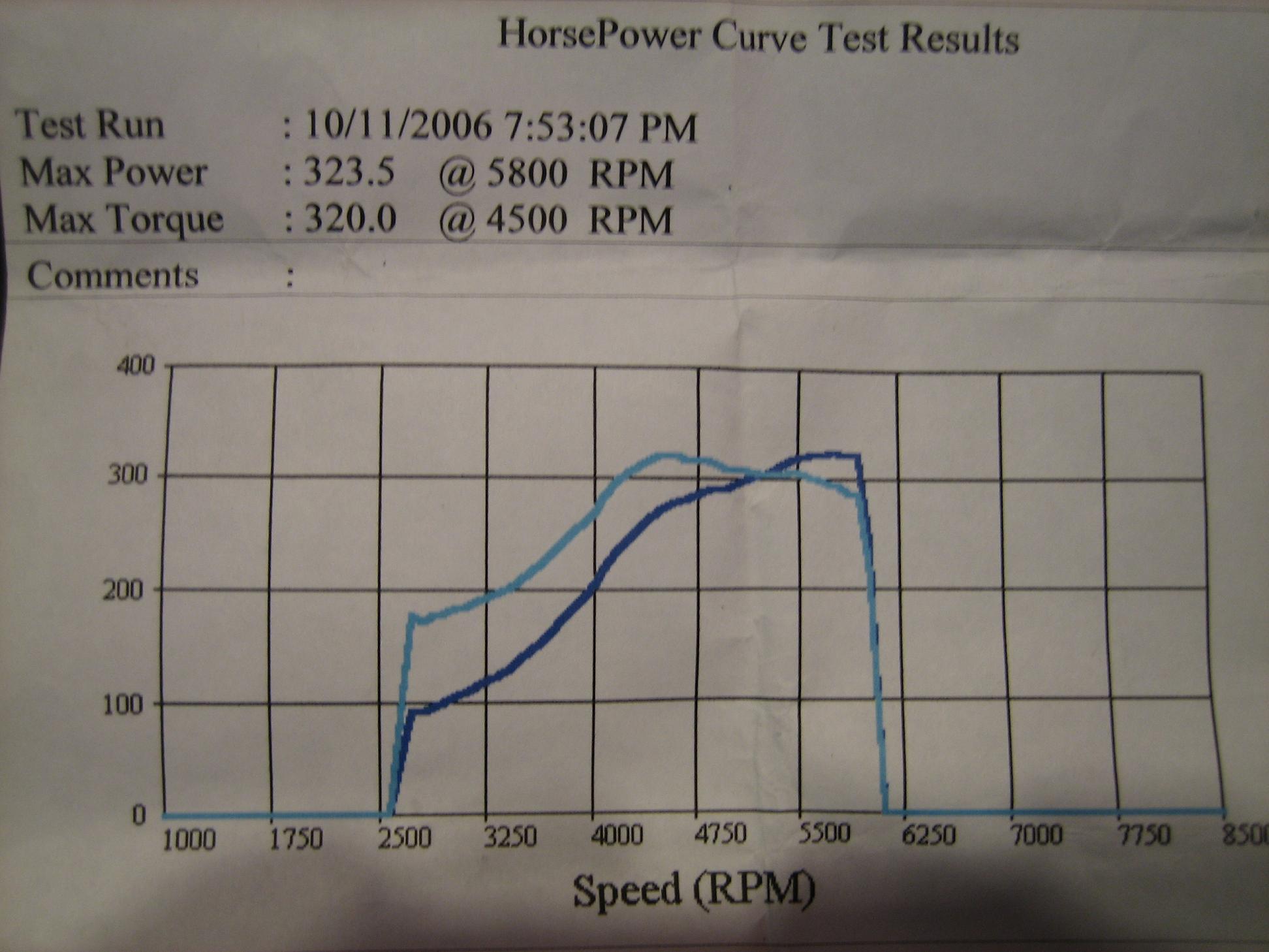

    dynoed the car finally!!!!!!!!!!! 320/320 at 11 psi.
    today i dynoed on a mustang dyno 320hp at 5500 320tq at 4500. 11 psi.
    made 280/280 wheel at 9psi. stock internals, ported heads, milzy stage 1 cam, turbo headers, t3 82ar stage 3 exhaust, 60-1 compressor, 70mmtb, 3500 plenum.
    in a 2000 56 spd cav.
    what do you say? i guess i need more cam i can post the sheets here too if need be. also, bro's cobalt at 15 psi went 280 wheel hp at 7000 and 220 or so tq!
    time for mroe cam i think i want to rev to 7.

          • farmerz24
            • Feb 2004
            • 361
            3100 not 3400.... stock motor, v6ho ported heads, milzy stage 1 boost cam.
            hp peaking at 5800 i guess i need more cam? or maybe my exhaust wheel is becoming a restriction? time for a gt35r and more boost.
            70mm is great for driveability i made a variable rate throttle arm, so the first half or 3/4 of pedal travel is probably 50% or 40% throttle opening, then
            on the last 1/4 it opens it right up.!!!
            my torq is insane, same as the hp, but i was hoping for more as that guy with the remote mount dynoed 320hp 350tq at 12 psi the wheels no?
            next year is a built 3400!

              • farmerz24
                • Feb 2004
                • 361
                heres the graph.
                mustang dyno 11psi.

                        Just ran your mill through turbocalc and you are at the limit of a .82 turbine housing just before 5400 rpm and 11 psi which shows on the program 300 hp if calculated with an intercooler and 263 hp without. The intercooler reading is the one I would go by even if you don't have one because it is closer to your actual power output.
                        • farmerz24
                          • Feb 2004
                          • 361
                          cool. so looks like its time for a t4 upgrade. im thinking a gt35r, but the question is what a/r in the t4? 80 or 60's? Im wanting to go 600 engine on this one and rev to 7. what do you guys think? 82 or 63?
