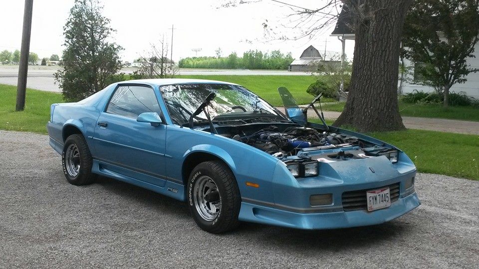

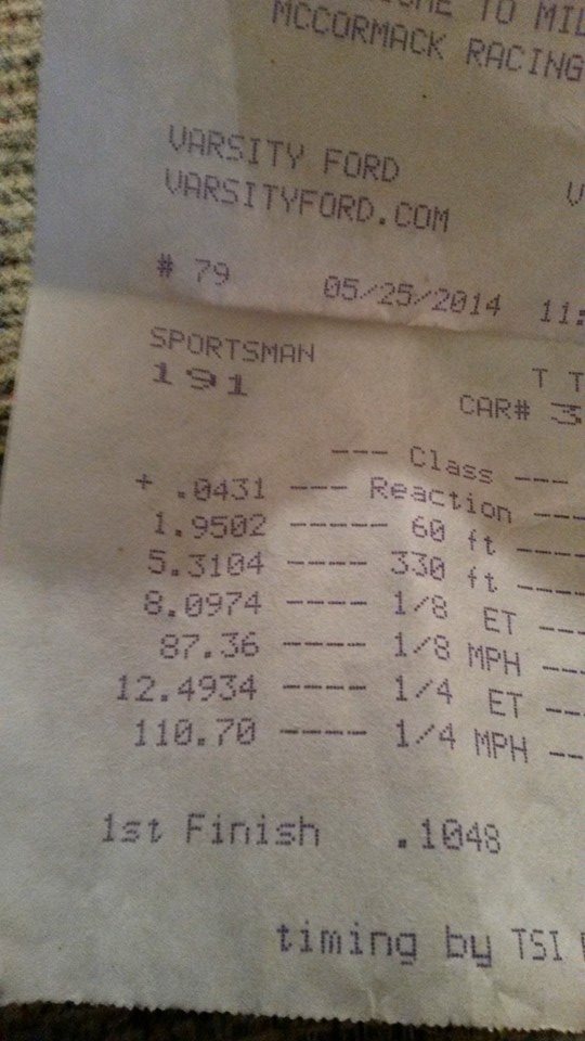

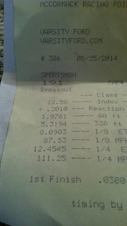

    I added 2 videos and a few slips for ya to check out. Totally fell asleep on the 2nd round and had such a horrid light. Been a long few days...to get the car tuned and ready but it ran great. Drove a 120 mile round trip also and it did well.
    I love not having a screamer pipe now. All i can hear down the track is the turbo and some throtty exhaust. Love it.
    Did i mention that this car is surprisingly consistent! Love that alot.

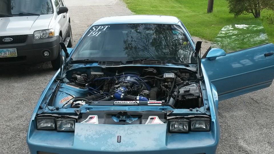

    Update on the build. Tuned it all day. Got it somewhat dialed in. Running med boost. Heres a vid. Plan to make a pass at the track tommorow if all goes well. Not trying to kill it, just make a clean pass or 2 and see what it can do with about 10psi.
