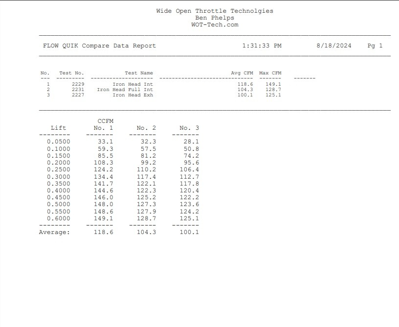

    I only have the Camaro 3.1 for testing, so there are a lot of options not currently covered. The test head is here should I come across any other setups.
    28", 3.700" bore, PAP % 100cfm +5% 200cfm +1% 300cfm +1%
    Bare head vs with full intake/throttle body, and the exhaust flow with a 1 5/8 header stub.
