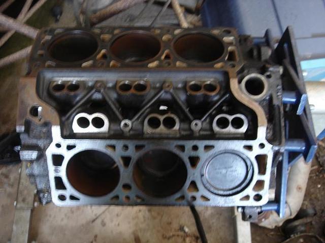

    This is a bare 3.4 DOHC block

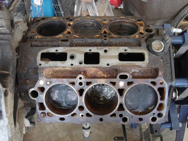

    And this is a bare 3100 SFI block
    One of the biggest NOTICEABLE differences is the OIL VALLEY. The 3.4 DOHC does not have lifter holes, and it has a cover on it. When the engine is ASSEMBELED, the valley is actually OPEN to the air, and not sealed off like the 3100. The 3.4 DOHC has that cover on it to keep anything from getting in there.
    Here is the cover on a 3.4 DOHC
    This is me holding the cover in place on a 3100 block
