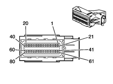

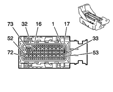

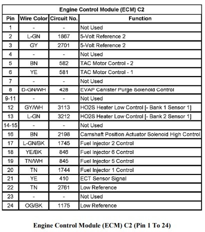

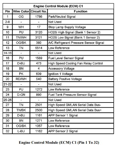

    This is from a 07 Saturn Aura, so it might differ a bit from others. I can add whatever needs to be added to this, just let me know.
