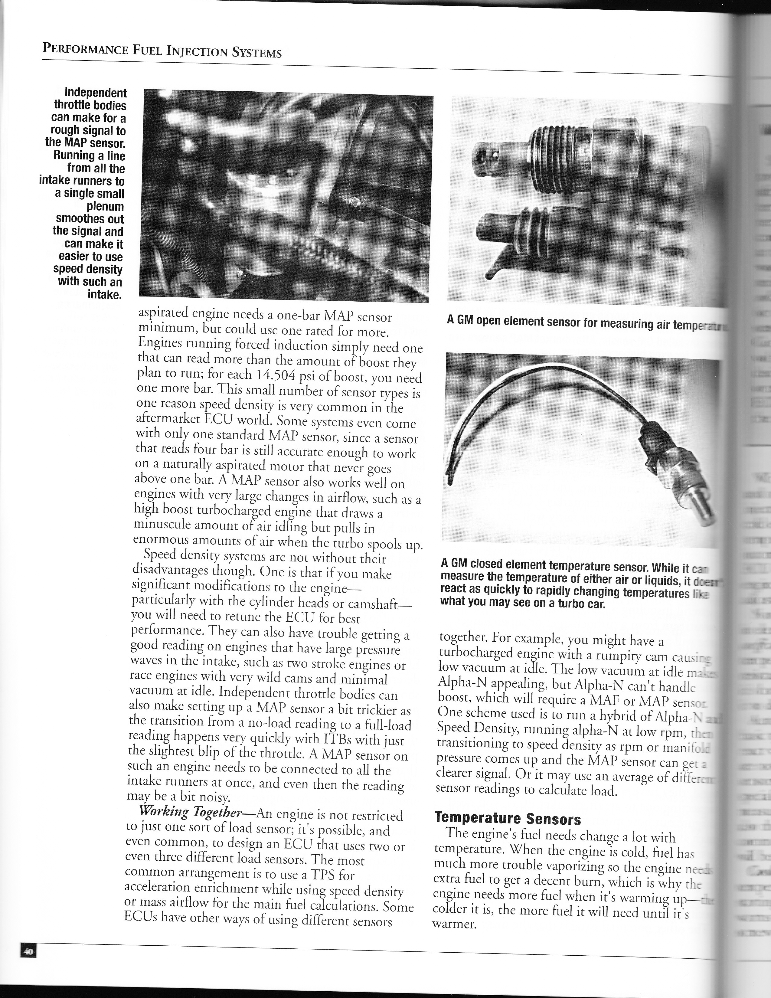

    Ok, I found it, but they didn't address size, but do mention that it cleans up the MAP sensor signal, and they have a pic
    It's from this book:
    Performance Fuel Injection Systems HP1557: How to Design, Build, Modify, and Tune EFI and ECU Systems.Covers Components, Sensors, Fuel and Ignition ... Tuning the Stock ECU, Piggyback and Stand [Cramer, Matt, Hoffmann, Jerry] on Amazon.com. *FREE* shipping on qualifying offers. Performance Fuel Injection Systems HP1557: How to Design, Build, Modify, and Tune EFI and ECU Systems.Covers Components, Sensors, Fuel and Ignition ... Tuning the Stock ECU, Piggyback and Stand
Name:	MAP sensor scan.jpg

    replied
    That would be cool to see, thanks.
    It's got a balance plenum already but the volume is extremely small and with having the brake booster and PCV running off of it also it seems like i'm not getting as good of a MAP signal as i could be. It's high enough at idle to throw a code 33 so something is up.
    I did find that the 3 drivers side ITB's were open a little more than the passenger side, i re-adjusted the idle stops so we'll see if that helps when i get it back together. It's tricky since i'm not using a IAC motor to get the idle right, it's getting closer though...
    Leave a comment:
    replied
    I would think a vacuum ball would be a little too big of a buffer for the ITB setup and react too slowly. I've read in my performance fuel injection book that you want all TBs reference going to a common "buffer" like deal, but not a very large one due to what I just mentioned- just to get a reading from each cylinder. If I run back across it, I'll scan it and shoot you a copy of that section if you like.
