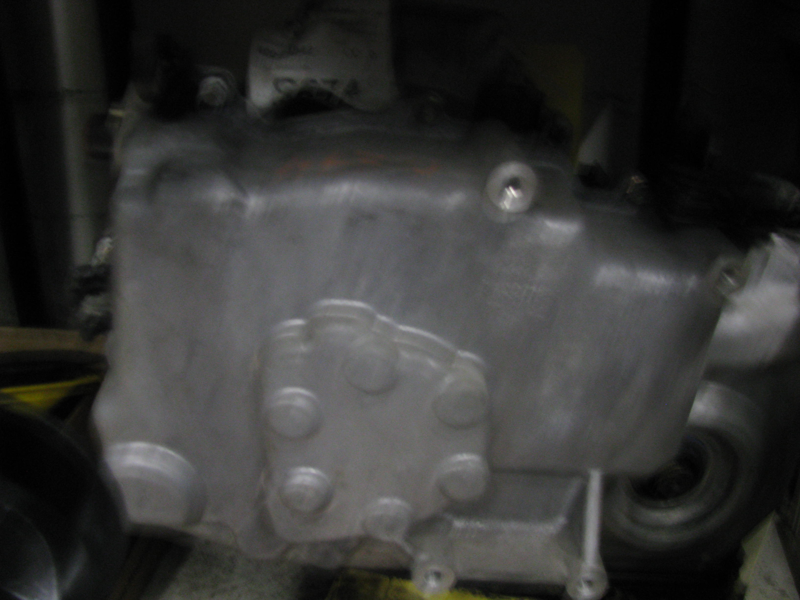

    Originally posted by nixtux View Post
    Added a picture of the 3500 and 4T45-E. I'll have pictures of the install too.
    The 4T45-E is a bad picture. I'll have some better ones in the next week.
    Hopefully the week of the 8th the install can get started and I'll post pictures
    for those considering a 3500 swap.
    As for headers, unless I get a decent side job I probably won't be able to do those
    until the end of November.
    Anyone know how long S&S takes to ship? I e-mailed them but haven't gotten a
    response.
    Thanks for all your help!
    What year, make and model is that transmission out of?
    From the side shot it doesn't look like it is going to work in your alero with out some modification.
    response.
